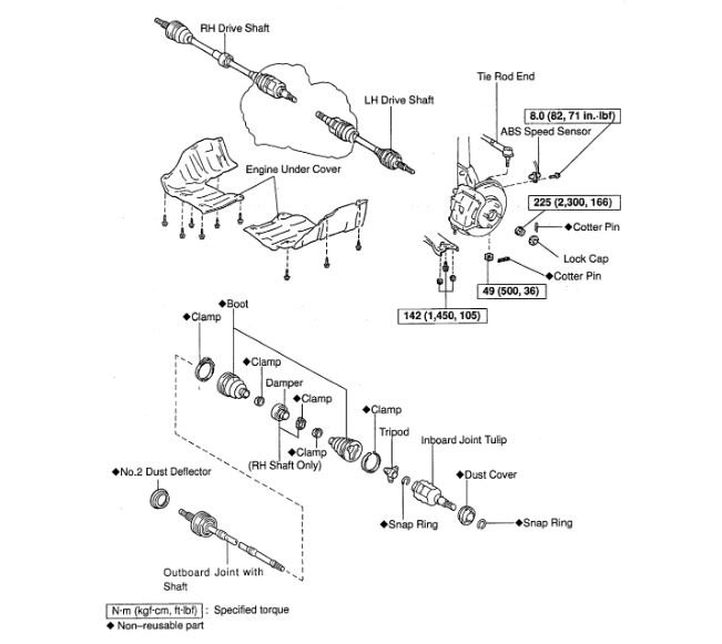

REMOVAL
NOTICE:

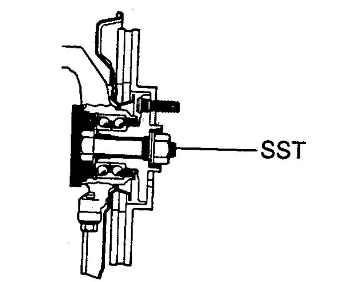

The hub could be damaged if it is subjected to the vehicle weight, such as when moving the vehicle with the drive shaft removed.
Therefore, if it is absolutely necessary to place the vehicle weight on the hub bearing, first support it with the Special Service Tool (SST) 09608-16042 (09608 02021, 09608-00204) or equivalent.
After disconnecting the drive shaft from the axle hub, work carefully so as not to damage the sensor rotor serration on the drive shaft if ABS equipped.
1. Remove front wheel.
Torque: 103 Nm (76 ft. lbs.)
2. Remove engine under covers.
3. Drain out gear oil (M/T) or ATF (A/T).
4. w/ ABS:
Remove ABS speed sensor.
Remove the bolt and ABS speed sensor.
Torque: 8.0 Nm (71 inch lbs.)

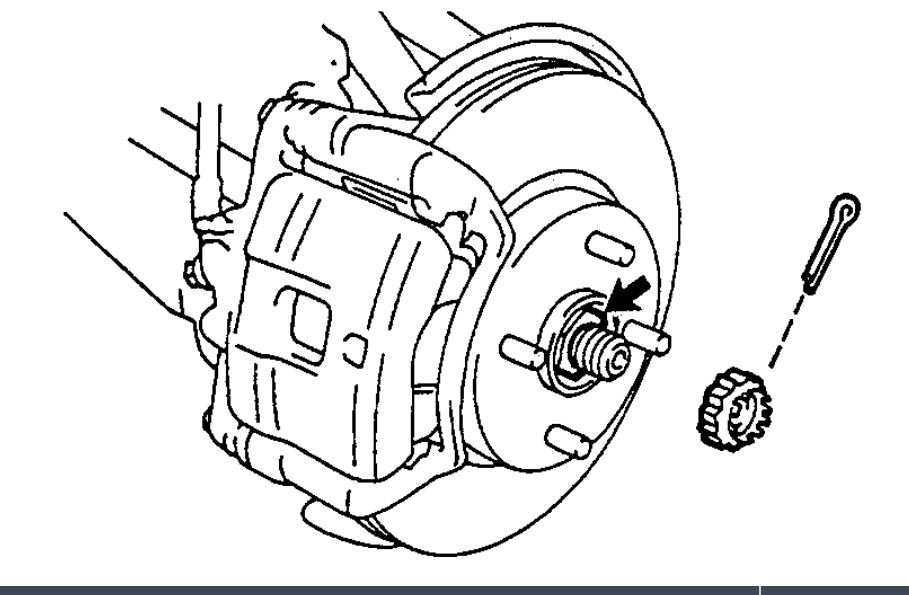

5. Remove drive shaft lock nut.
a. Remove the cotter pin and lock cap.
b. With applying the brakes, remove the nut.
Torque: 225 Nm (166 ft. lbs.)

8. Disconnect drive shaft from axle hub.
Using a plastic hammer, disconnect the drive shaft from the axle hub.
NOTICE: Be careful not to damage the boot, oil seal and speed sensor rotor.

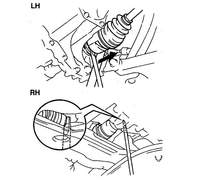

9. Remove drive shaft.
a. LH Drive shaft:
Using a hammer and hub nut wrench, remove the drive shaft from the transaxle.
b. RH Drive shaft:
Using a hub nut wrench, remove the drive shaft from the transaxle.
NOTICE: Be careful not to damage the dust cover and oil seal.

10. Remove snap ring.
Using a screwdriver, remove the snap ring from the inboard joint spline.
