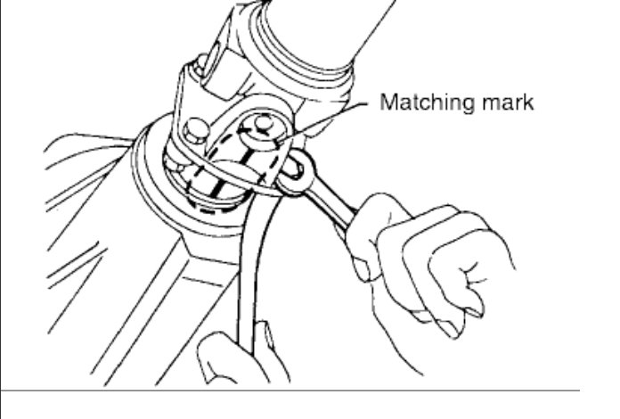

My car began a horrible screech and grind under the car. After having it towed in to dealer, I was told the axle was bad and needed replaced. I was told this would be $460.00 for all. I found this to be high but needed it fixed. The next day I was told after they replaced axle, that it was not the problem (but that it was still bad) and I needed a new driveshaft, and this would be $900.00 alone just for this and another couple hundred (only) to put on since they had it apart.
Everyone I have talked to has told me I should pay not even close to that much for a driveshaft for car and that also the axle was likely misdiagnosed .
Mar 12, 2018 at 12:38 AM
  • 55,746 POSTS

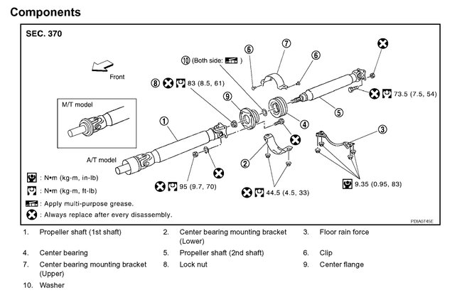

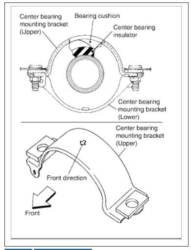

If the noise was exactly the same then yes they missed it. If the sound is coming from directly under the car then I would say it is a driveshaft carrier bearing which is more common. Here are diagrams to help you see what you are in for when doing the repair.
Also, if you could shoot a quick video of the noise with your phone and upload it in your reply I can know for sure.
