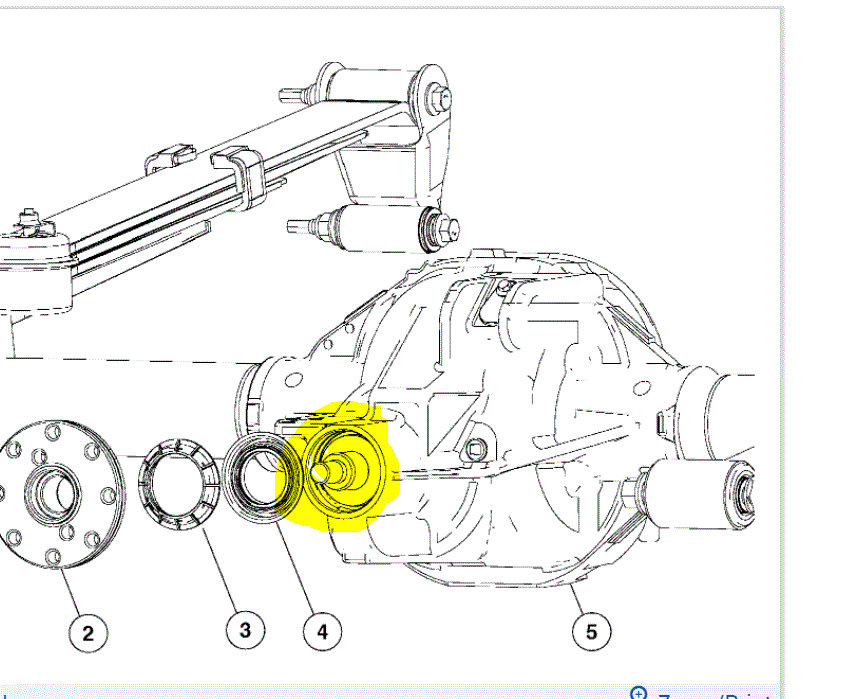

Howling from the driveshaft.
May 20, 2022 at 9:50 PM
  • 110,236 POSTS
The driveshaft itself really can't make the noise. Howling is usually a sign of a faulty bearing. Are there any leaks at the differential or where the yoke pushes into the rear of the transmission?
See pic below.
