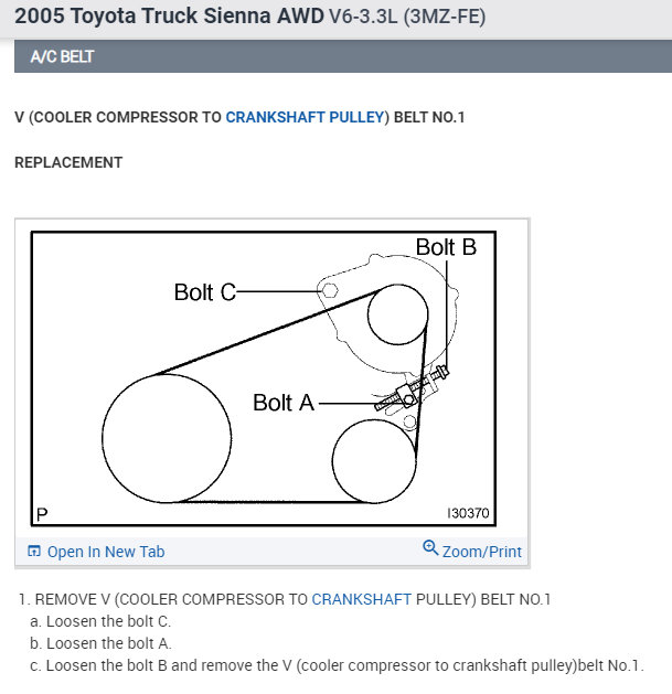

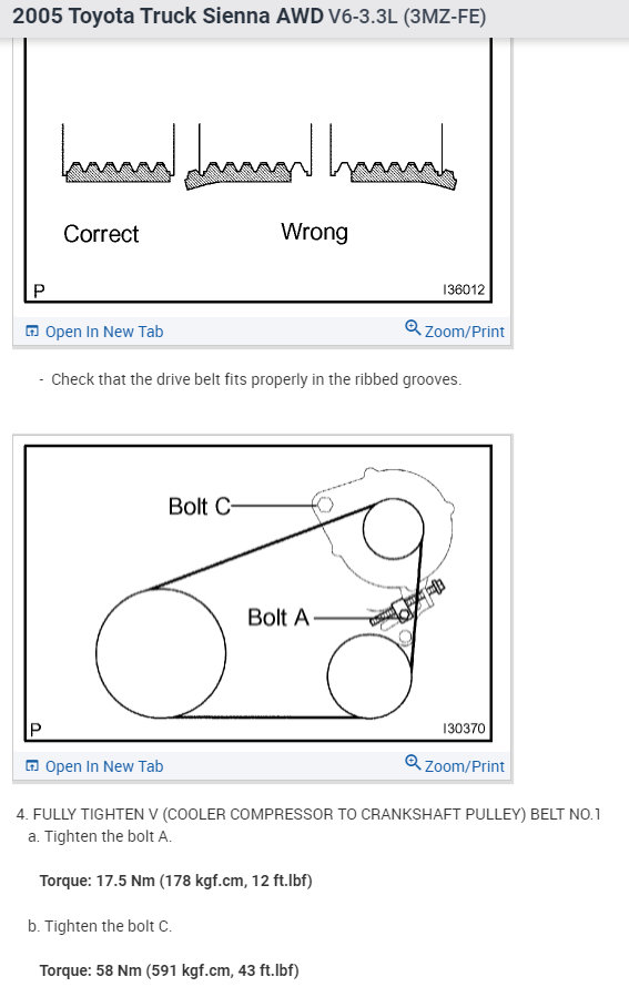

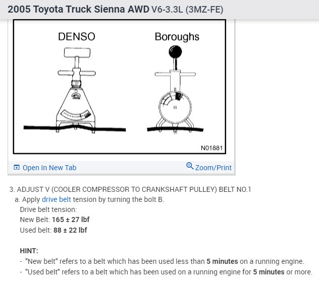

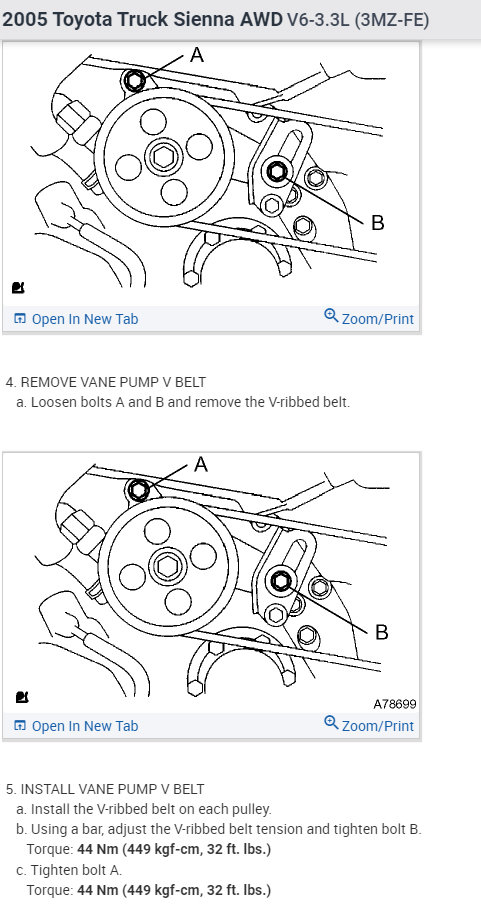

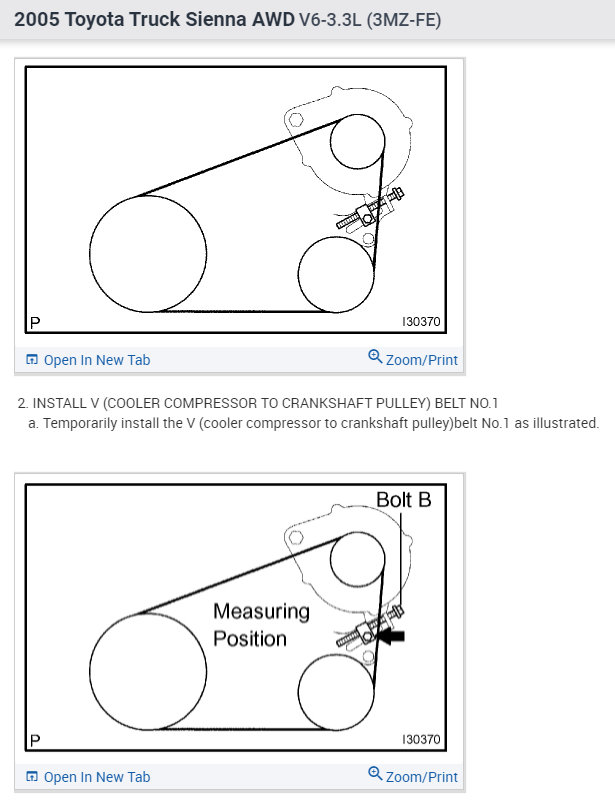

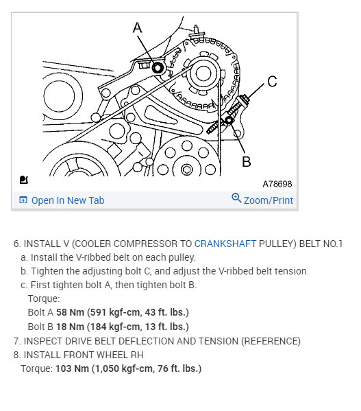

when replacing the drive (serpentine) for the alternator, should I disconnect the battery terminals. Also, what torque setting is recommended for the bolts to tighten the drive belt.
And lastly, is it easy to install a new drive belt.
Nov 8, 2021 at 4:02 AM
SQM
  • 6,383 POSTS

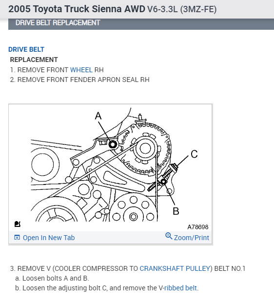

In order to replace the drive belt, you will have to remove the right hand side wheel as well as the liner inside the fender well to access.
Disconnecting the battery is not necessary.
I have attached the replacement procedures for both belts as well as all the torque specifications below.

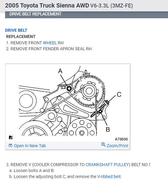

in the pic below, under replacement, what is #1 and #2?
Nov 8, 2021 at 12:53 PM
SQM
  • 6,383 POSTS

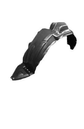

Number 1 talks about removing the passenger side wheel (you will have to jack up the vehicle and secure it with jack stand).

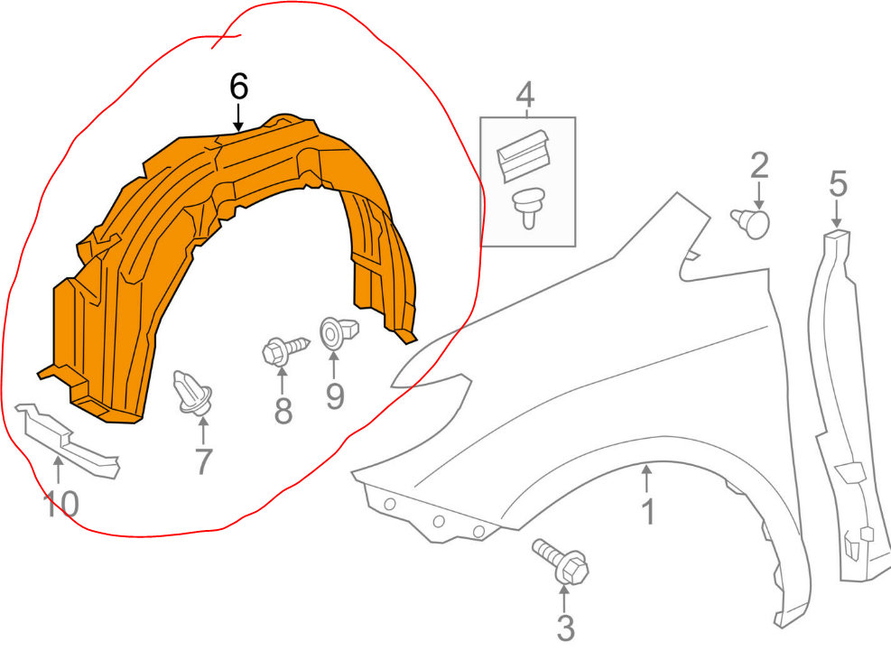

Number 2 is for removing the inner fender liner inside the wheel well (see picture below).
