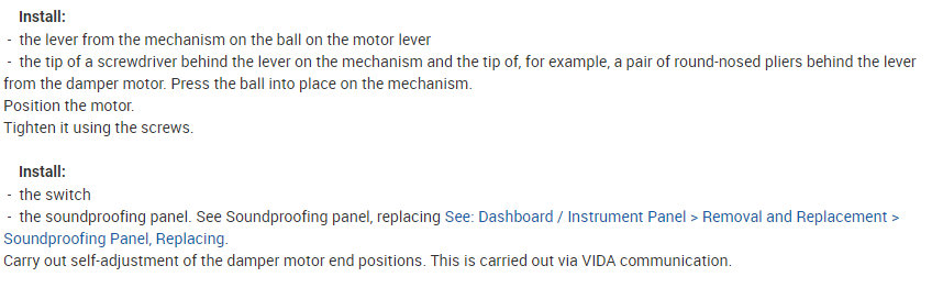

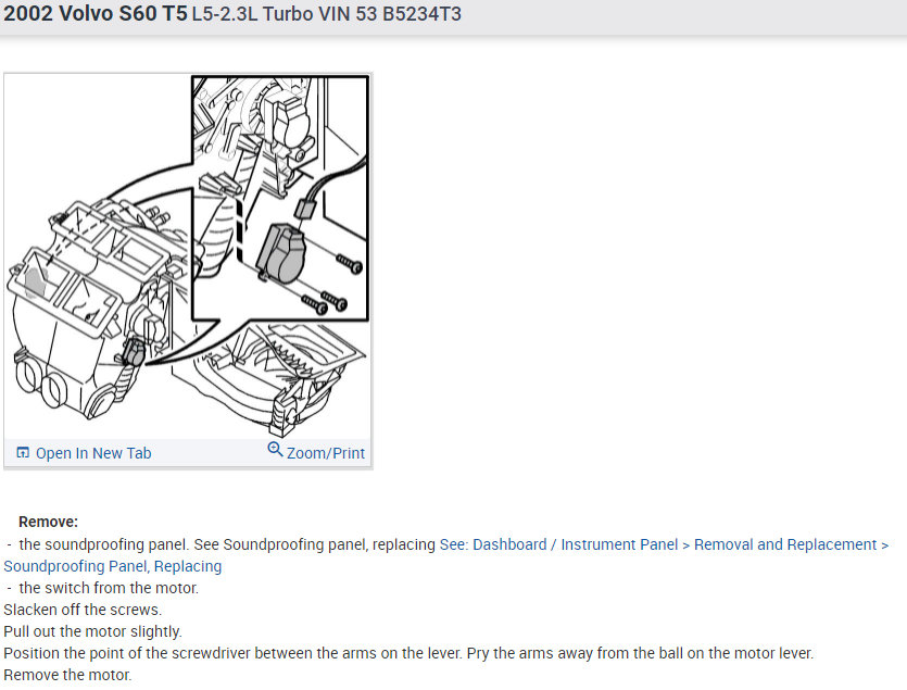

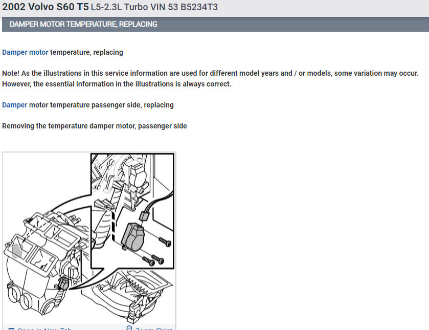

When turning on my heat in the car the driver side blows cold air and the passenger side blows heat. How can I get this problem handled?
Dec 25, 2016 at 8:25 AM
SQM
  • 6,383 POSTS

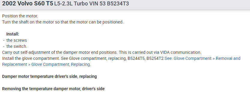

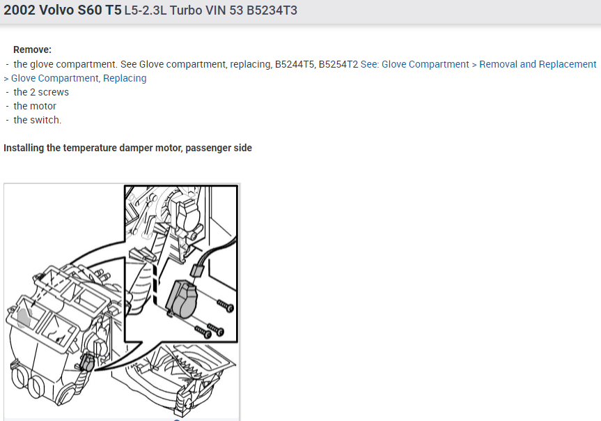

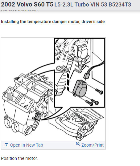

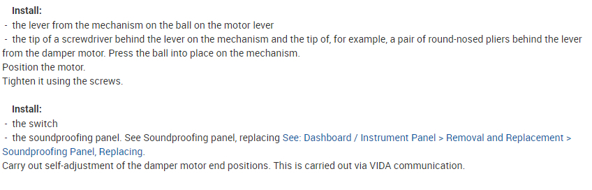

It does sound like you have a faulty blend door actuator.
You might find this article helpful:
I have attached the replacement of the blend door actuator procedure for your Volvo.
Let me know of any questions.
