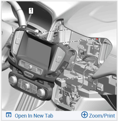

I have the codes U1534 and U1538. Communication with driver's door. I'm looking for LIN wire colors and BCM plug color to trace communication problem. Driver's door switch or the BCM are not the problem. Nor is the programming.

The first thing to do is turn the systems on and check all fuses, here is a guide to help:
U1534 - Lost Communication With Telematics Control Module on LIN Bus
U1538 - Lost Communication With HVAC Control Module on LIN Bus

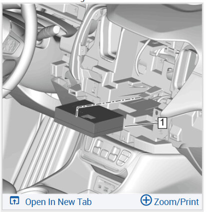

Since these modules are daisy chained together. the first module in line is usually the problem so the telematics control will be the issue. I would try unplugging it, and then plug it in again. This can sometimes fix it. Also, I would try a hard system reboot.
This guide will show you how:
https://www.2carpros.com/articles/step-by-step-guide-performing-a-hard-system-reboot-for-your-vehicles-electronics-systems
Here is the locations of the Telematics Control Module so you can check it out. Check out the images (below). Please let us know what happens.
