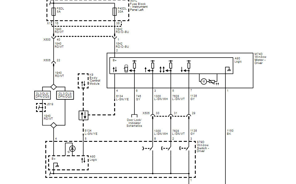

Window will not go up or down. All other electric functions from driver's door work.

There are two fuses for the control for the window. make sure there is power on both sides of the fuse with a test light or voltmeter. if there is, you then need to test for output of the switch to the motor driver. you again will need to test for voltage.
I attached a wire diagram for you to view.
