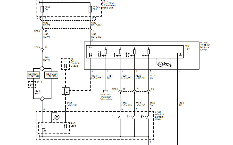

Window will not go up or down. All other electric functions from driver's door work.
Thought I would ask here before taking to the dealer.
Thanks
Apr 17, 2018 at 4:59 AM
good morning.
There are two fuses for the control for the window. make sure there is power on both sides of the fuse with a test light or voltmeter. if there is, you then need to test for output of the switch to the motor driver. you again will need to test for voltage.
I attached a wire diagram for you to view.
