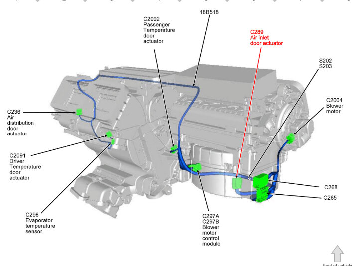

I have the car listed above SE with one knob to control the heat/cold for the vehicle. The passenger side full A/C is cold, while the Driver's side is mild. If I turn it to hot, they match. It seems the driver side never moves to get to its coldest. I replaced the mode control motor and removed the glove box and checked the temperature control actuator in the passenger side. It seemed to work. I manually moved the plastic levers that the passenger motor controls, and I still got the same result as my original issue noted above- leading me to believe that there is an issue with the driver's side only.
In the schematics posted on other forums, it looks like there is both a passenger and driver control motor, but everyone has only talked about the passenger side and replacing it.
I will mention that the driver's side seems to still work as I hear it move when I turn on the vehicle. I also have done the fuse 15 reset.

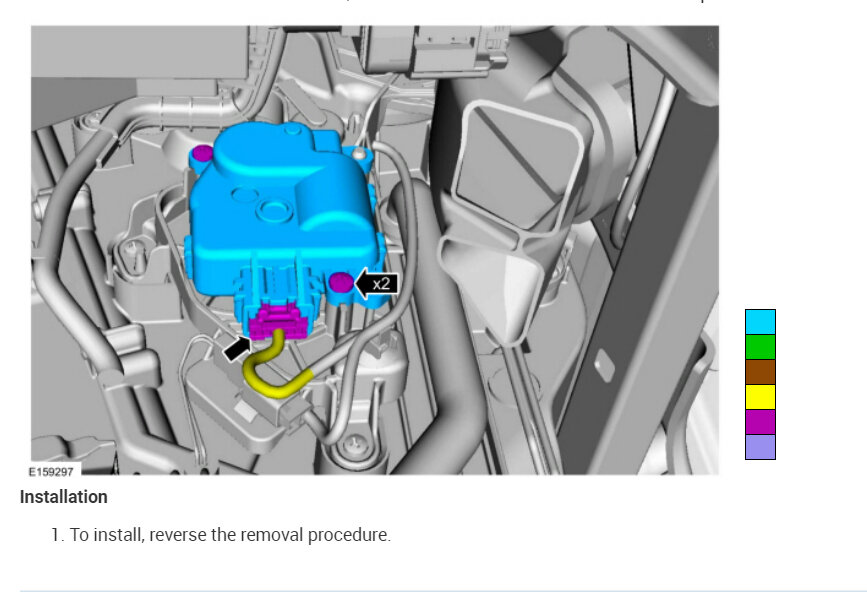

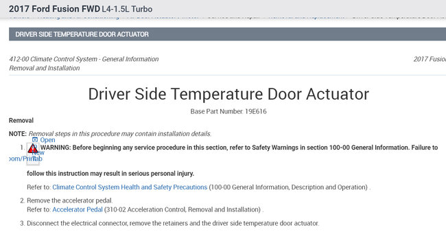

Is there a Driver's side actuator? Do I have to remove the whole dash to get to the driver's side, or is there any shortcut I can take?
