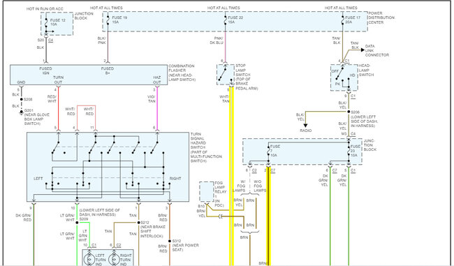

I attached the wiring schematic below for the exterior lighting circuits so that you would have a reference. As far as the ground sparking, if you have power going to the circuit, it is looking for ground. So, it can spark if you have something turned on.

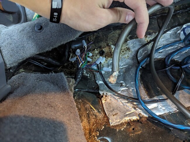

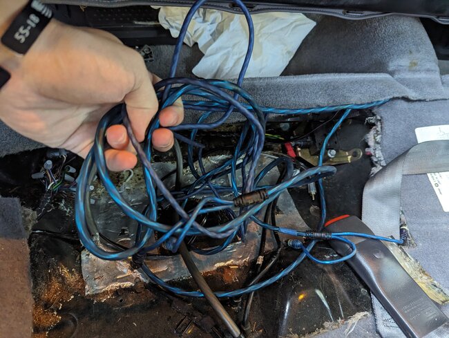

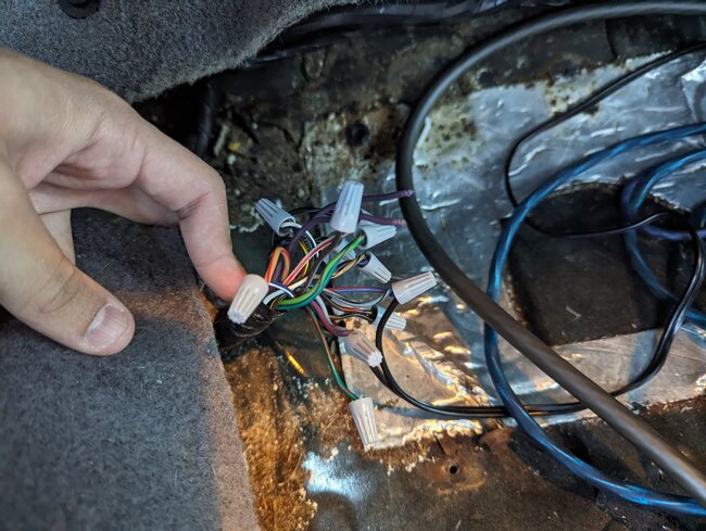

Yes, when I am driving and while parked. Again, only while the pedal is pressed does it activate. If it helps at all, my plate light does not function, and my 3rd brake light does not turn on even when brake is pressed. Additionally, my turn signal light did function as intended a couple months ago. It is from Florida and has yet to see a northern winter. My Cherokee was once used to crawl around on beaches. There are cords and additional wires for probably some subwoofers under the backseat that I did not install. I don't know how to describe it, so I attached photos.
Oct 9, 2023 at 7:56 AM
  • 110,248 POSTS
Wow, that's a mess. LOL Is anything still connected? If so, make sure there is no power to anything that is exposed.

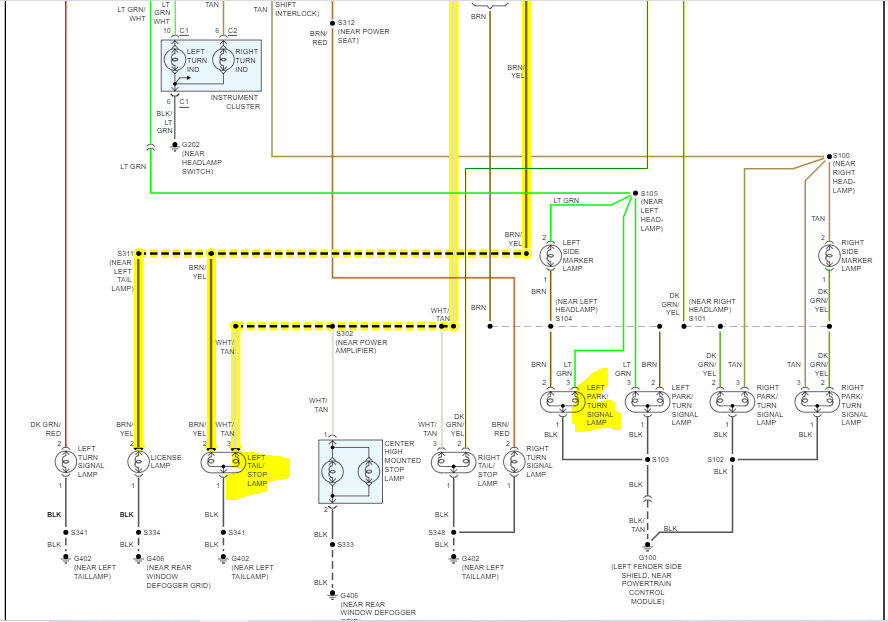

As far as the light issue is concerned, I went through the schematic again. The power supply to all brake lights is provided from the same source. Since they work when the car is off or not in gear, that tells me there is a connection throughout the power supply.
Since I don't think that is changing, I need you to confirm it for me. At the left rear brake lamp socket, locate the gray wire with a tan tracer. With the engine on and the vehicle in drive, have a helper check for power to the aforementioned wire when the brake is depressed. I have a feeling there will be power.
If there is, my suspect is a faulty ground. All of the rear lights use a common ground location, other than the license plate lamp. If there is too much of a load on a weak ground, it can fail. So, let me know if there is power first. If there is, we are going to try running a new ground to see if the lights work properly at that point.
