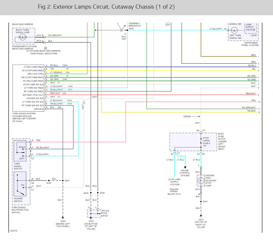

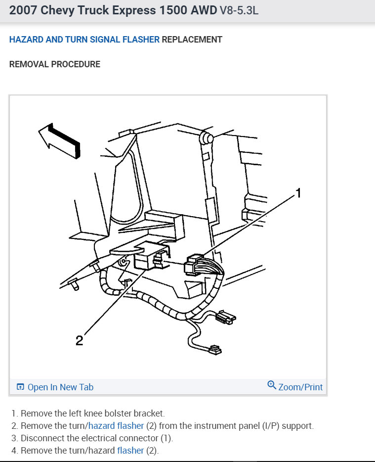

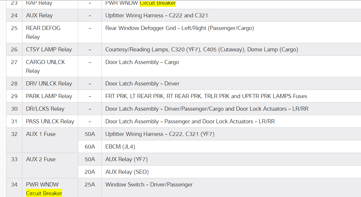

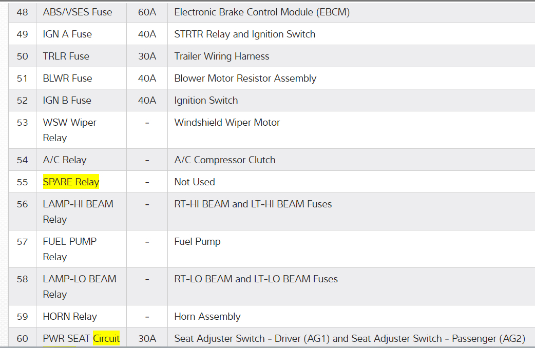

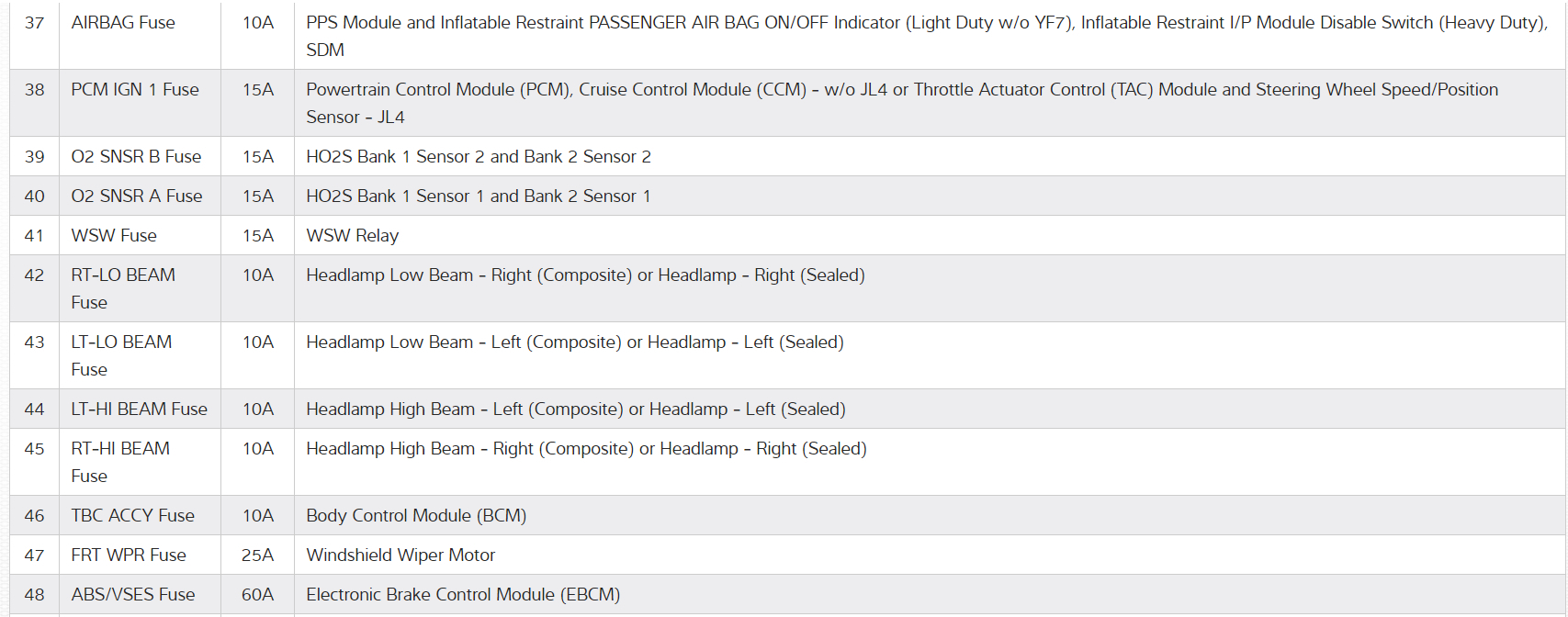

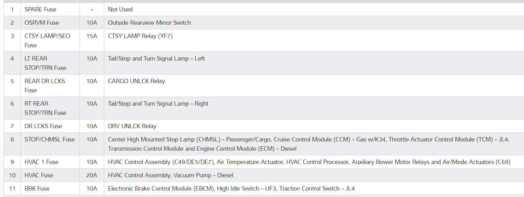

Tailight does not work at all when running lights are on. Brakelight does not work at all either. Blinker works seldom but seems to work when steering wheel is in certain position. When turn signal does work tailight does not. Switched bulb made no difference.
Dec 17, 2019 at 8:30 AM
  • 55,682 POSTS

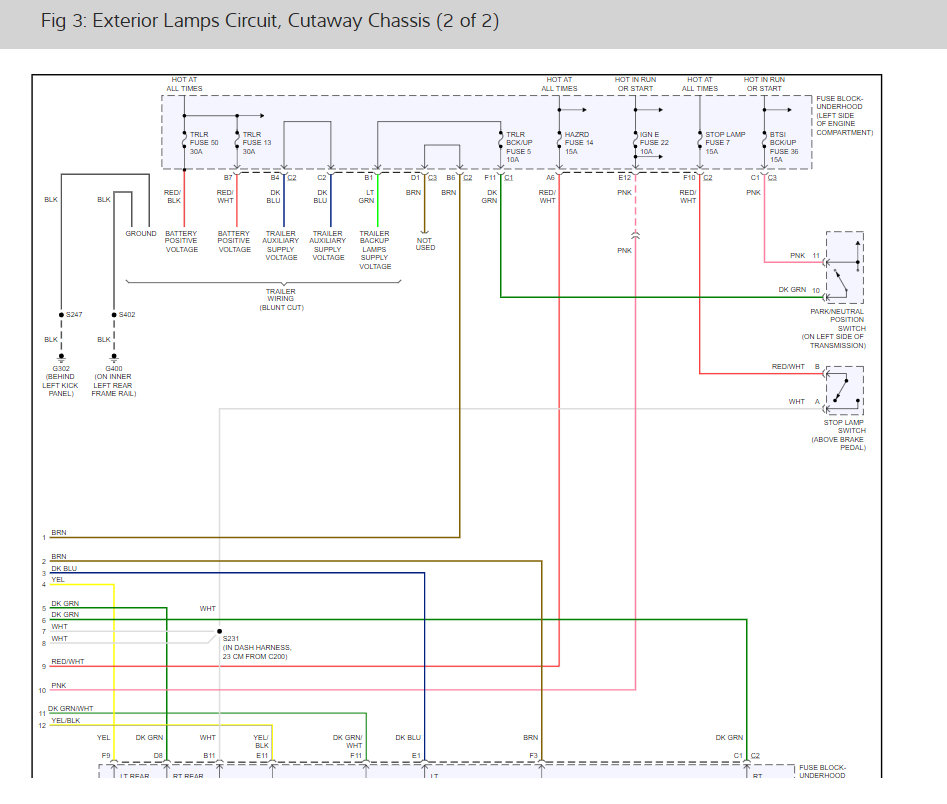

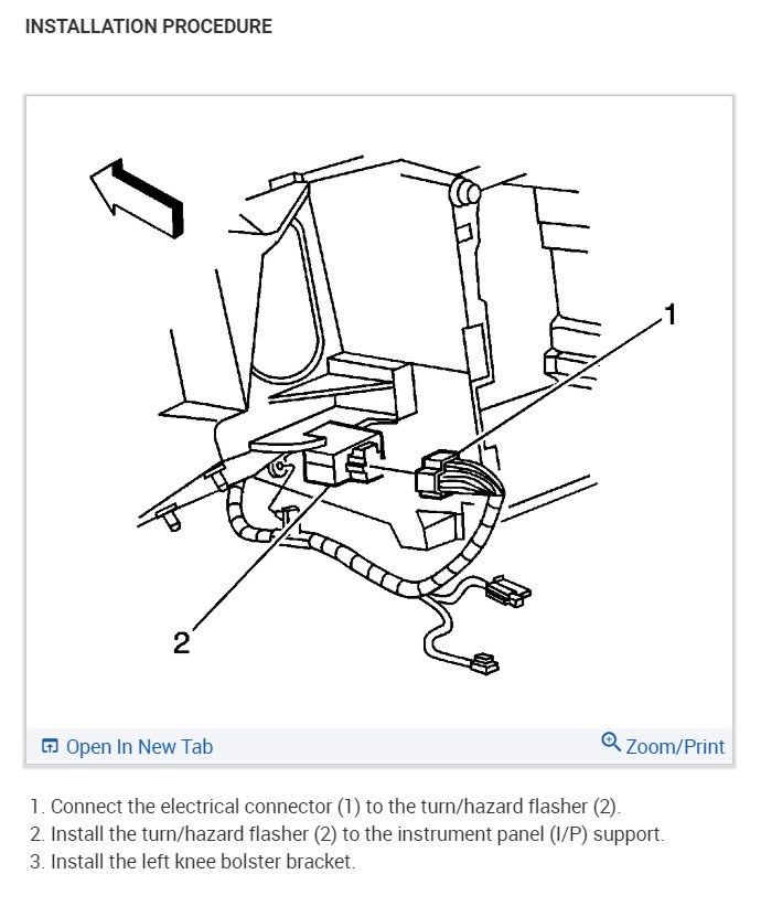

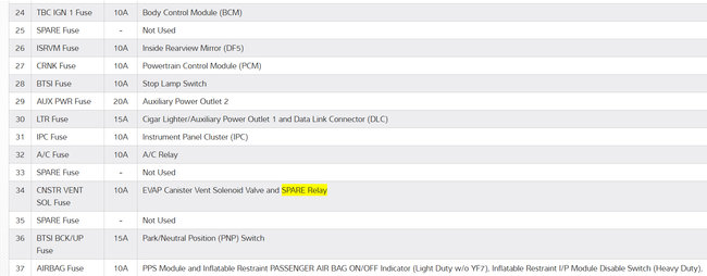

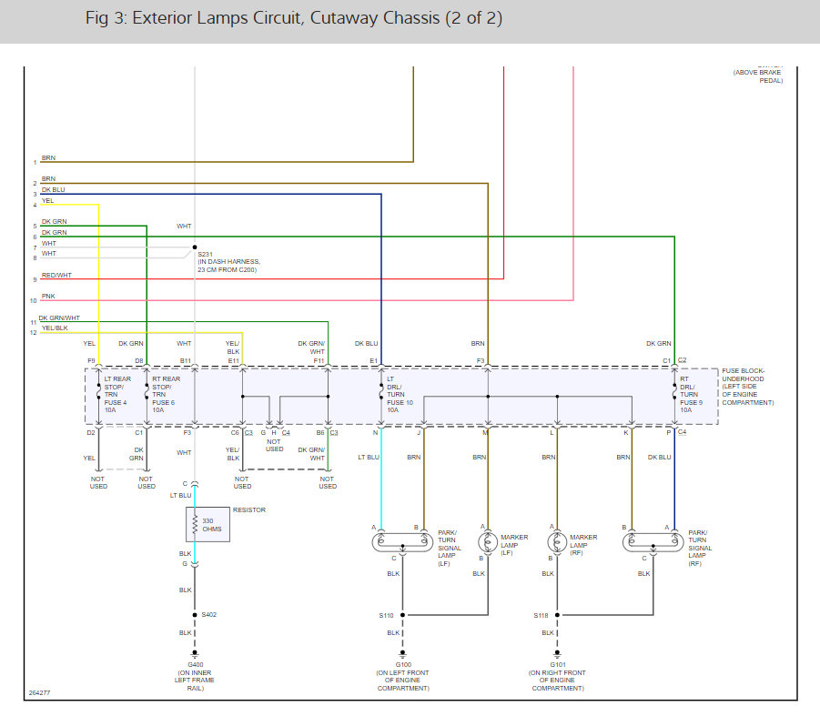

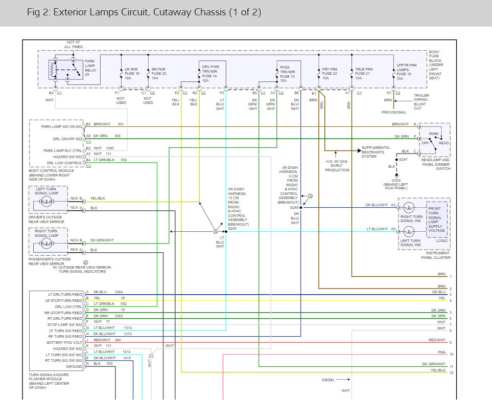

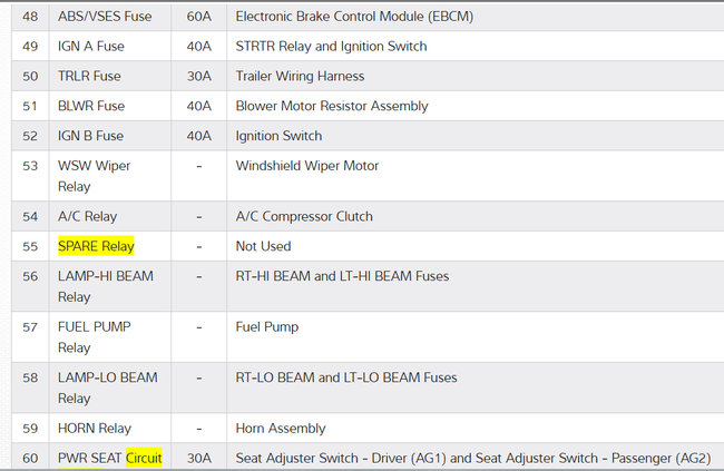

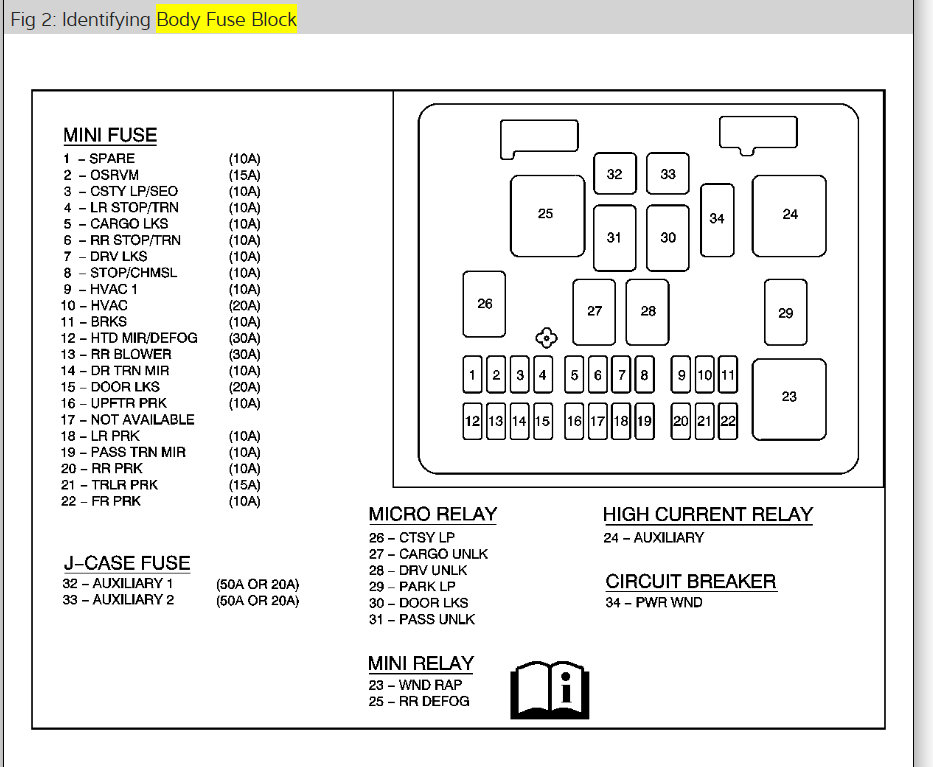

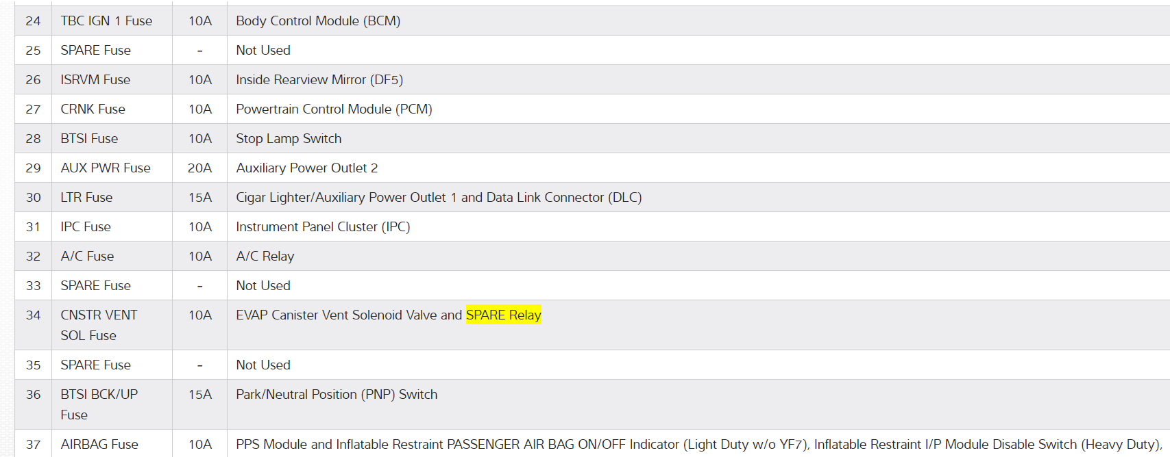

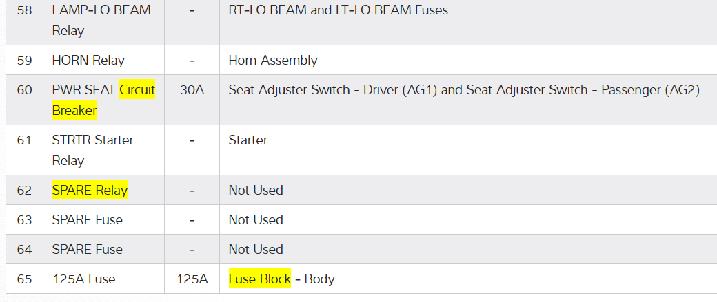

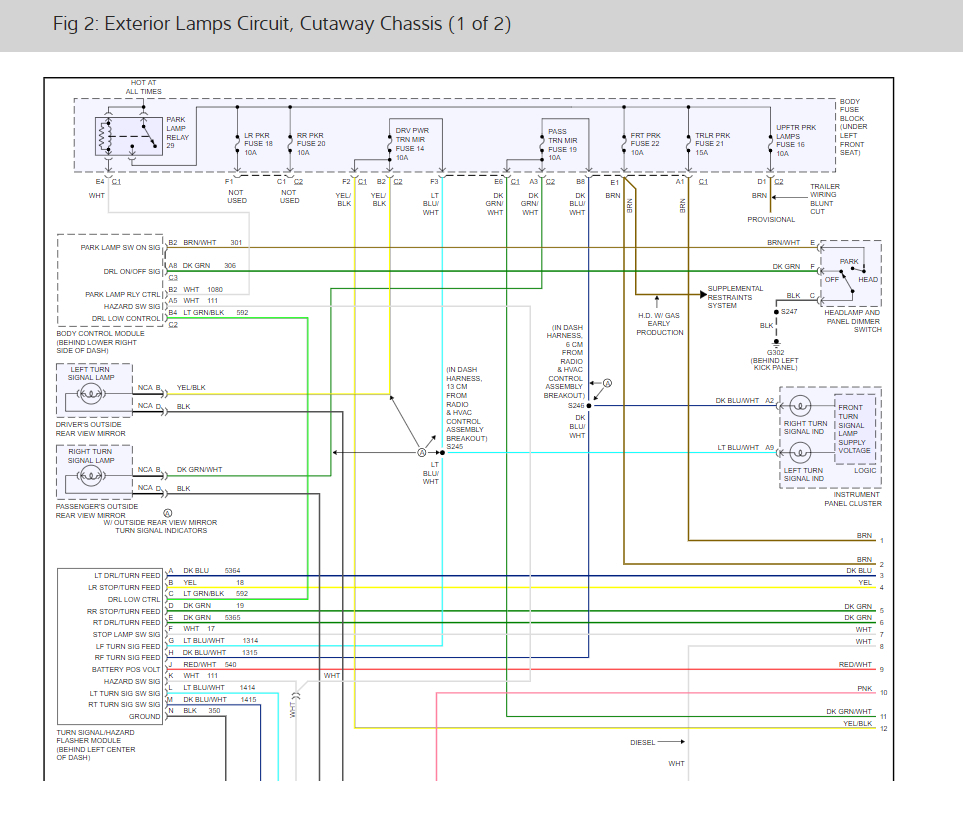

It sounds like the flasher module is out. to be sure let's check the fuses because there are many that run the system here is a guide to help and the fuse location with the blinker wiring diagrams to show you how the system works.
and
