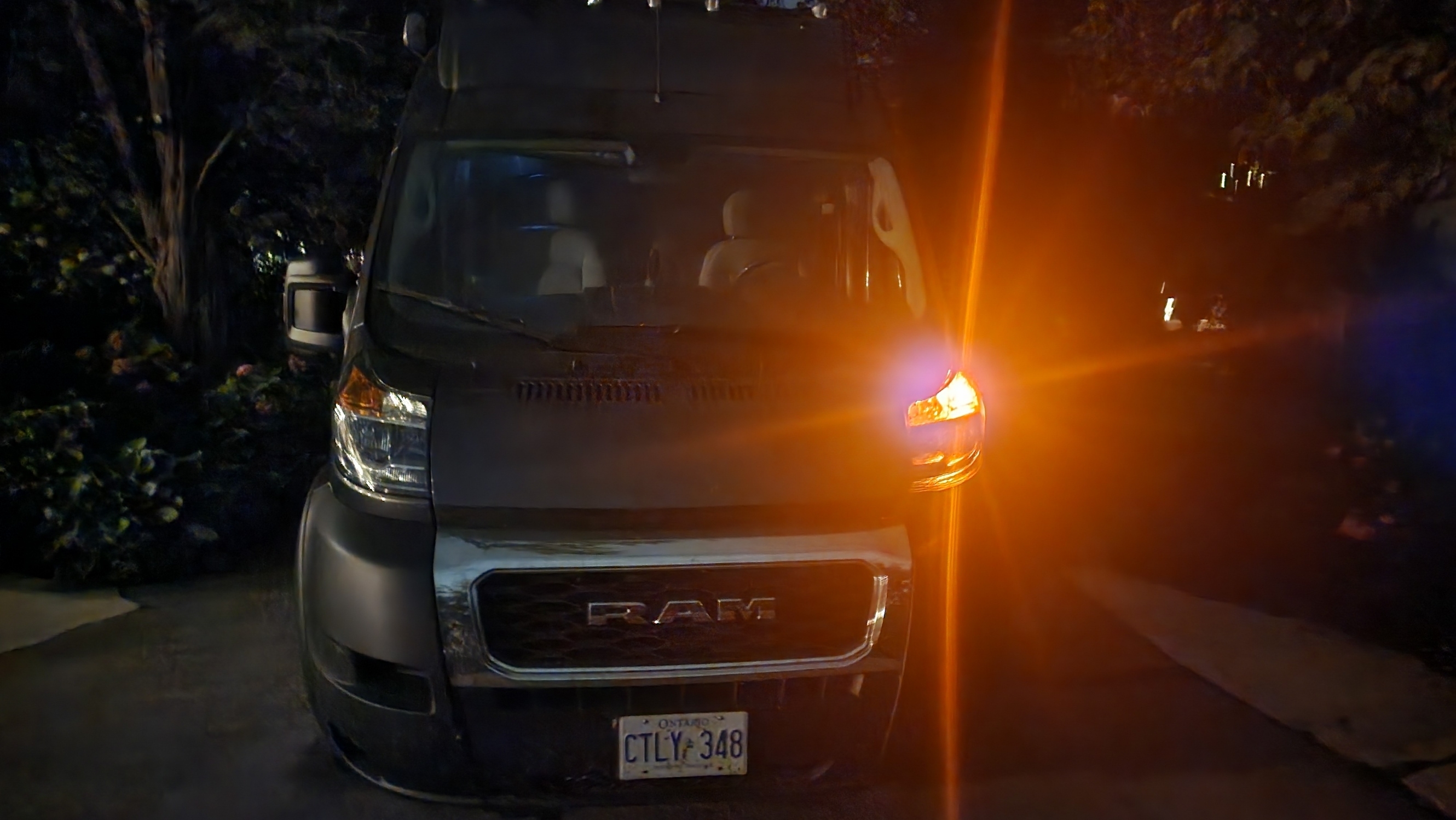

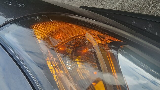

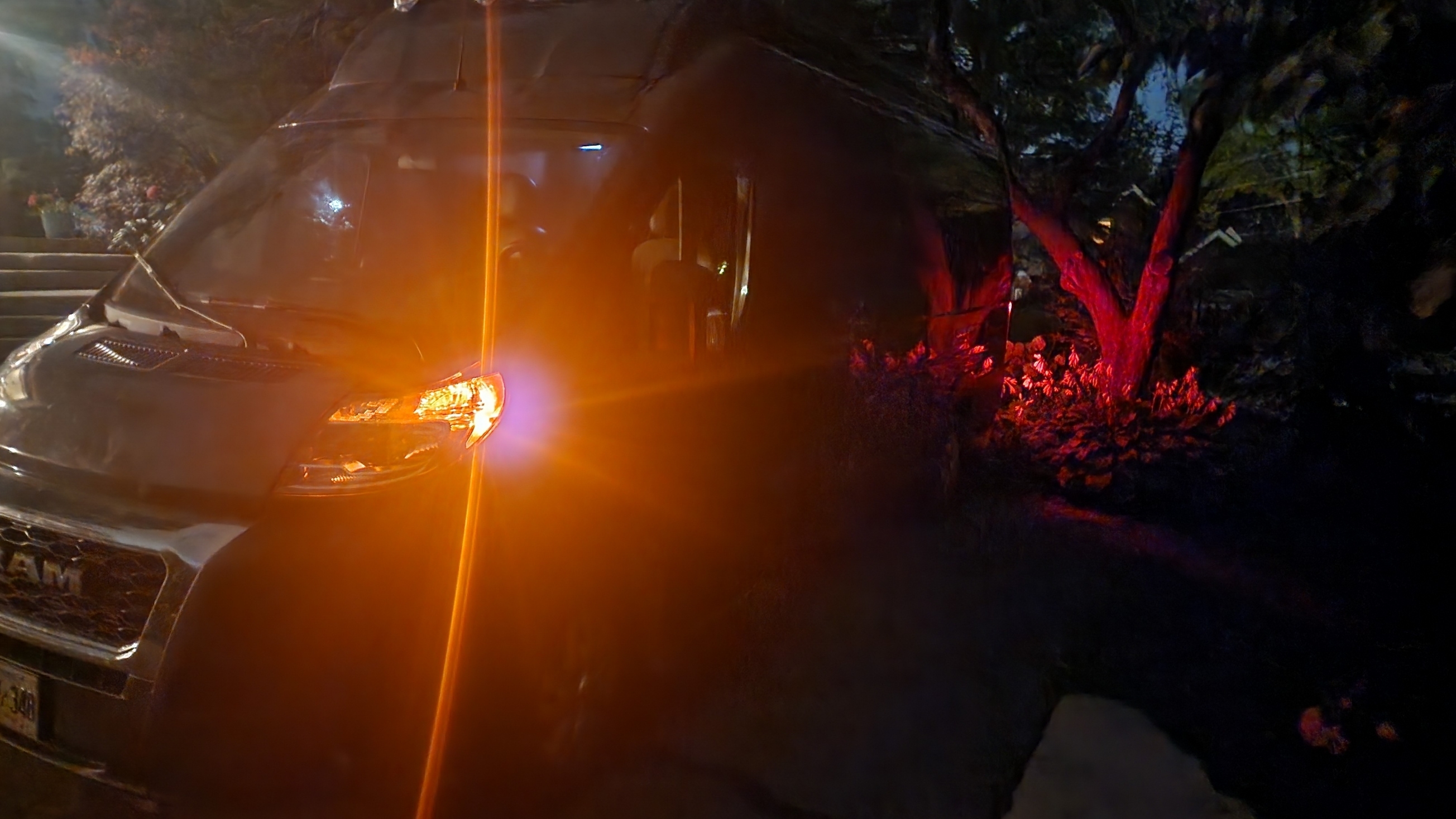

The parking lights on the driver's side have come on and will not turn off: The van has been driven regularly, and had been sitting for a few days in our driveway after returning from a multi-day trip. No issues. Last night, we noticed a faint glow from the driver's side, and discovered that both the front and rear parking lights were illuminated. This was not present the night before. We tried starting the van, checking all switches, moving it, but no change. This morning, the lights are still illuminated.
I understand this may be a short in a wiring harness or a bad relay. Any suggestions on where to search or troubleshoot would be very much appreciated. Thank you!

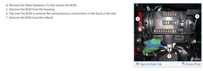

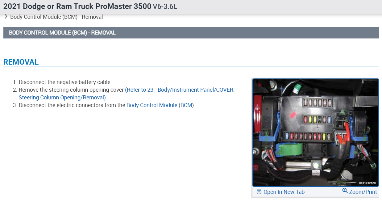

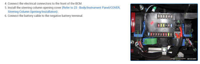

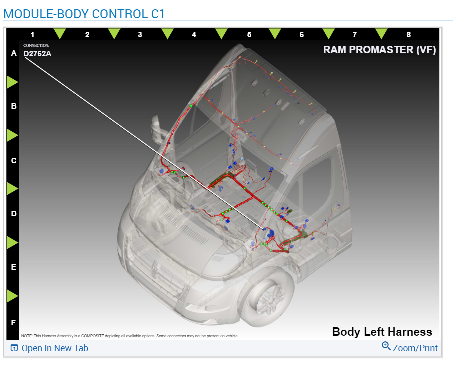

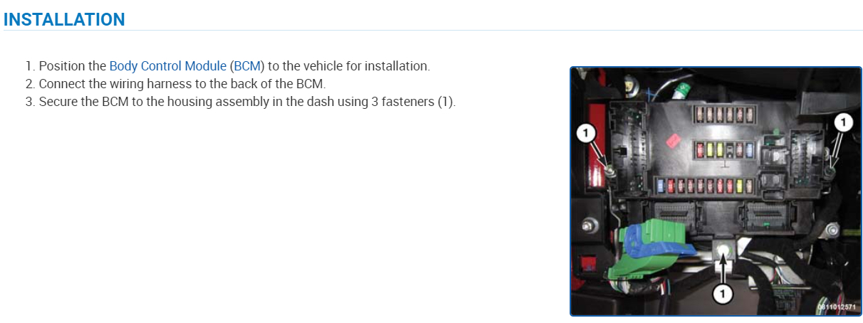

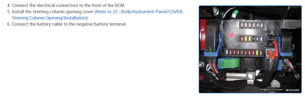

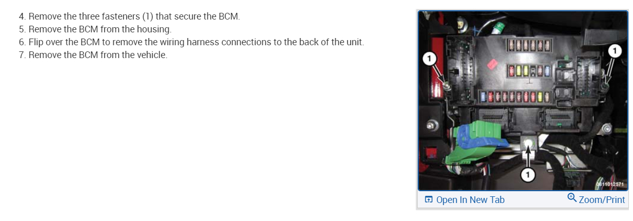

Yep, this means the BCM is going out. to be sure we should do a CAN scan. You can get a CAN scanner (Controller Area Network) which will work on most cars from Amazon.
https://youtu.be/u-4syLc-ifQ
Here is how to change the BCM out and its location, you can get a preprogrammed unit by searching Google or Ebay.

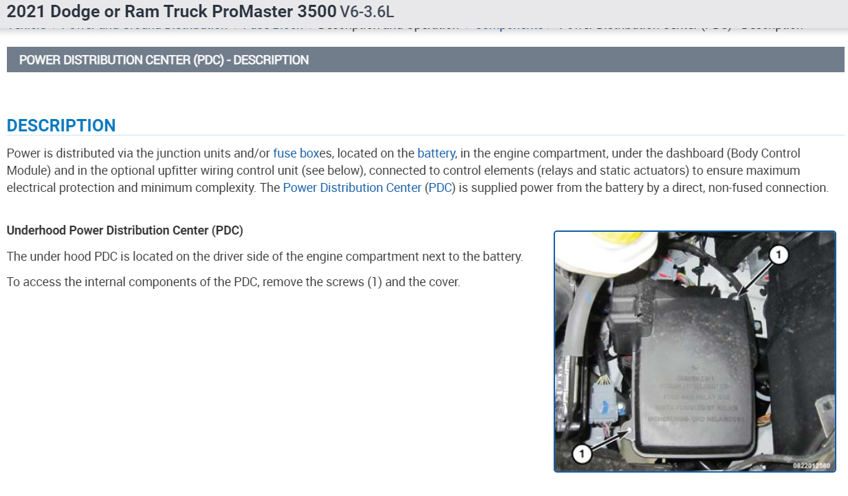

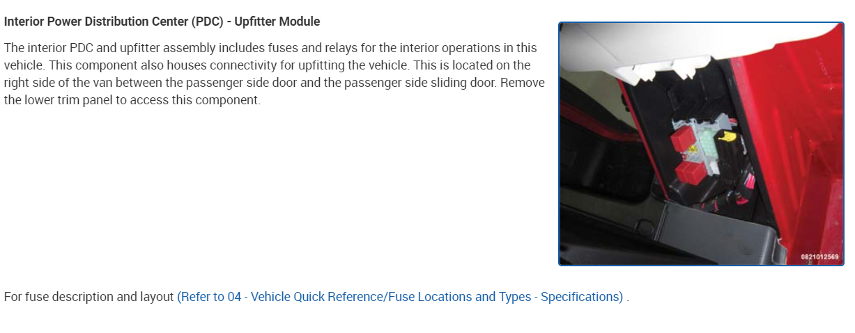

I should have had you double check all fuses, please go over this guide to help, if all fuses are good the BCM sounds bad.

I've resolved the issue: It turns out it was a faulty trailer harness module that was back feeding power into the lights. I traced the harness wiring to the module and pulled the fuse for it at the battery.
