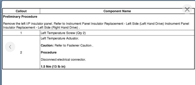

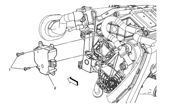

No heat on drivers compartment side. A/C and heat work on passenger side. Have been hearing clicking noise from HVAC system. Clicking noise started in summer but would stop.
Jan 12, 2020 at 3:35 AM
KENW1
  • 213 POSTS
Thanks for visiting 2CarPros.
It's behind the lower kick panel on the drivers side and to the right. If you remove the 3-4 7mm screw holding the lower panel in below the steering column you can get to it. Below is the location and instructions.
Jan 12, 2020 at 10:07 AM
LOINGRAMJR
Thanks! It's tight in there, but it looks like it can be done.
