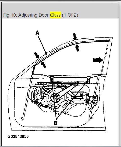

The rear window clip that attaches the rear of the drivers side front window to the power window rail has pulled loose from the window, allowing the window to jump the guide tracks. The bracket where it is attached to the window has no clamp, the clip appears to have been pressed/glued onto the window. I have attempted to glue it back in place with contact cement, but the window came out of the clip again. There is no way to manually tighten it to the window. What is the proper way to fix this problem, and does it take a specific type of adhesive to reattach this clip. There is no information available in the service manual.

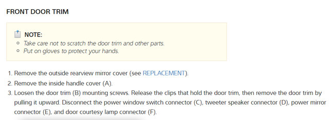

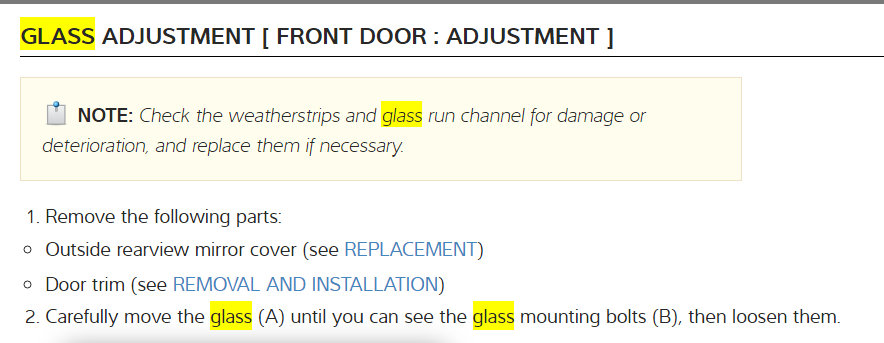

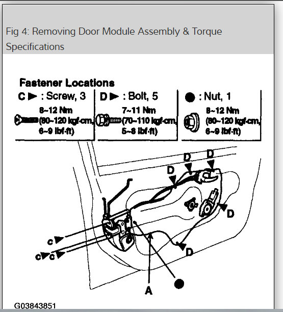

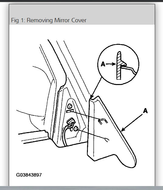

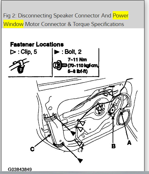

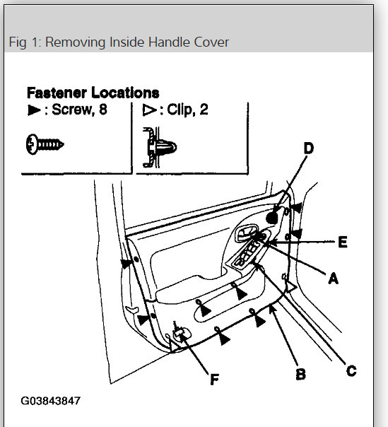

I have included the information that you requested down in the diagrams below. Please feel free to ask if you should have any other automotive questions that we can help you with. It is what we are here for.

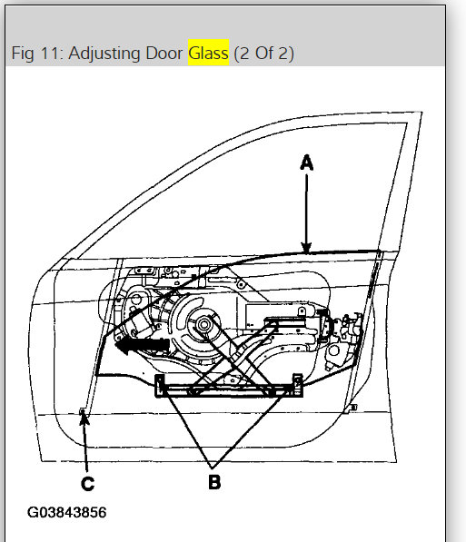

Perhaps my question was not clear. If you look at figure GO3843856 part B you will notice the window attaches to the rail with a plastic/nylon clamp. The rear nylon clamp has turned loose from the window itself. on the window is a toothed plate, the clamp itself has teeth that slide into the window plate. There is no way to tighten this connection, so it must have been pressed in, or glued. My clamp slides on easily, but off easily turning the rear part of the window loose. Is there a fix to this without replacing the entire window? Although it is not from a 2005, this diagram shows the clips I am referring to at the bottom of the diagram.

Hello again,

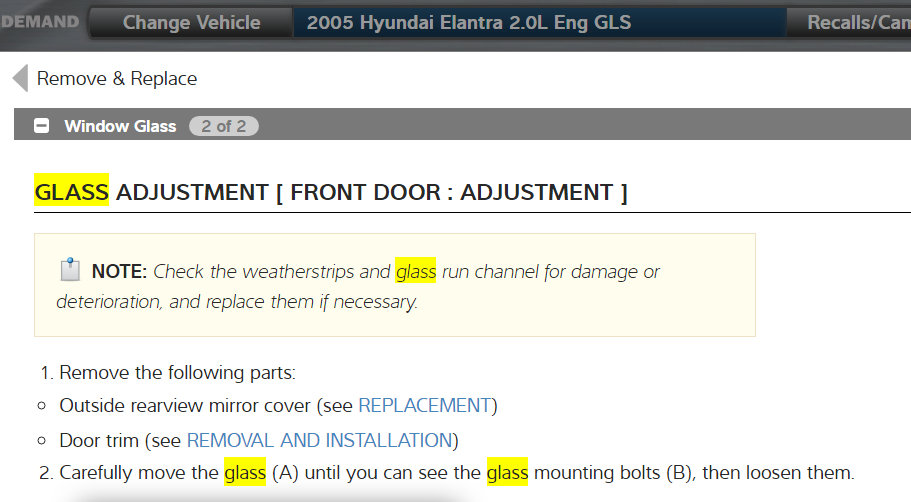

I think it says it connects with mounting bolts.

There are no mounting bolts where it connects to the window, just to the power window rail itself (one bolt) this only connects the clip to the rail, not to the window. It has turned loose from the window itself.
