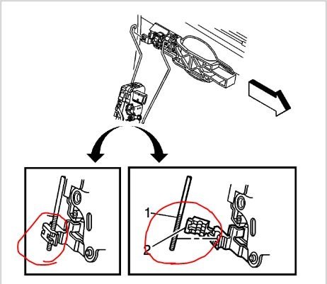

If everything is attached, the first thing that comes to mind is the linkage has slipped. There is a clip that the threaded end of the linkage rod attaches into. Maybe it has slipped and won't move the latch far enough to open.
Take a look at the attached picture. I circled the part I am referring to. Let me know if you have checked that.

That's the likely issue, indeed at the moment though, the door is completely put back together and is in the closed position with the panel on it. I guess I have to destroy the panel to get access to the assembly? Is there a way to avoid destroying the panel at this point?

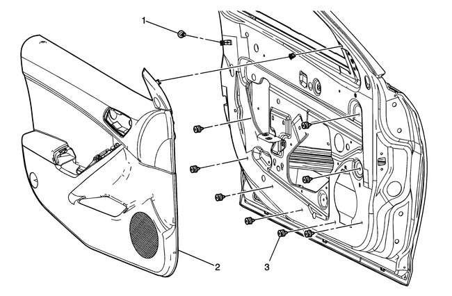

You should be able to get it apart even though the door is closed. However, it most certainly isn't as easy. I attached a picture, which indicates all of the attachments for the panel. Realizing you already did this, you may not need it, but I thought it may help.
Let me know if you get it apart.

Thanks for your time and effort here, man. So yeah, i knew the connection points on the door and it was not as bad as I thought it would be. once i got the bear you have listed as #1 out, the rest was pretty straightforward even though some of them snapped. That effin' clip wasn't moving up/down for whatever reason I am not sure because I couldn't quite see it but I could feel it. I popped that rod out of the way, and could move the clip by hand and the door opened. I buttoned the rod back in there, manually moved it up/down, and by golly it started working again as expected. Lubricated the heck out of everything, and tempted fate. the door closed and open numerous times without issue and four hours later continues to do so. Thanks a bundle for your help, dude. I appreciate everything.

What is the part number that that clip at the end of the threaded rod? I have a 07 G6 GT that won't open from the outside. Inside is fine. When I took off door panel, I could see inside that clip was not grabbing the rod it's stripped out.

Are you referring to the clip that holds the linkage to the latch assembly? Take a look at the attached pic below. Is that what you are seeing?
See pic below.
