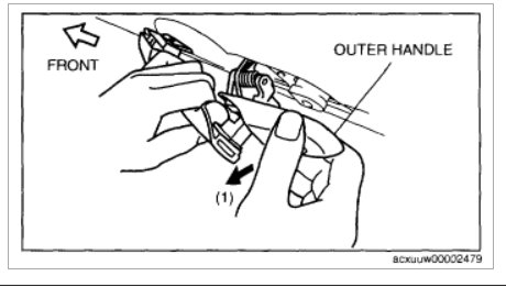

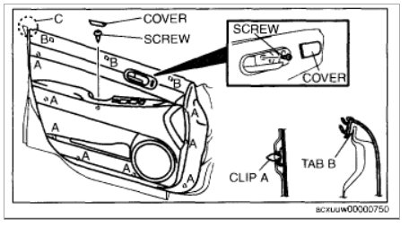

My driver side exterior door handle fell off. The parts seem to be all there I just need to know how to put it back together. Thanks

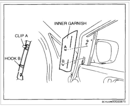

Yes, you first need to remove the door panel this guide will show you how.
https://www.2carpros.com/articles/door-panel-removal
and
https://www.2carpros.com/articles/test-or-change-electric-power-door-locks
Then there will be 10mm nuts that should still be in the bottom of the door you will need them to reinstall the handle.
Below are diagrams to help you see what you are in for.

We can help you with this information. The outside door handle retainers are under the inside door panel. The door panel will need to be remove. I,m including links below with instructions on remove and replace of the panel and the outside door handle.
(If you have any problems with these instructs let us know right away so we can resolve the issue)
https://youtu.be/VY2-Xn7TlbE
https://youtu.be/NZah6Mz_ULo
