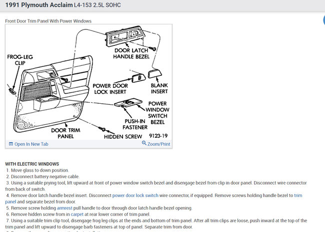

My car drivers side will not open from the inside anymore, but it opens fine from the outside handle. Instead of taking off the door panel it is possible that I only have to take off the inside door handle to see if it is just disconnected or broken? Please let me know okay? Thanks, Tom

here are the instructions on how to fix the inside door handle:
1. Remove trim. Move glass to up position.
2. Remove the watershield as necessary.
3. Disconnect two links at latch.
4. Remove the three inside handle screws.
5. Remove inside handle assembly with links attached.
6. Transfer links to new inside handle.
7. Reverse this procedure to install.
This guide may help as well
https://www.2carpros.com/articles/door-panel-removal

Ken, thanks. but the video is not for a 1991 Plymouth Acclaim, can you direct me to the exact model? I don't have electric windows but do have the speaker on the door panel. I was hoping i could just take out the handle and replace it. is that possible to do? Thanks
Jan 9, 2021 at 3:53 AM
  • 54,832 POSTS
No, you will need to remove the door panel. Check out the diagrams (below). Let us know what happens and please upload pictures or videos of the problem.
