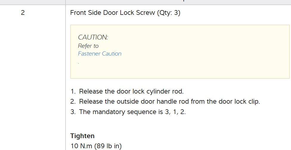

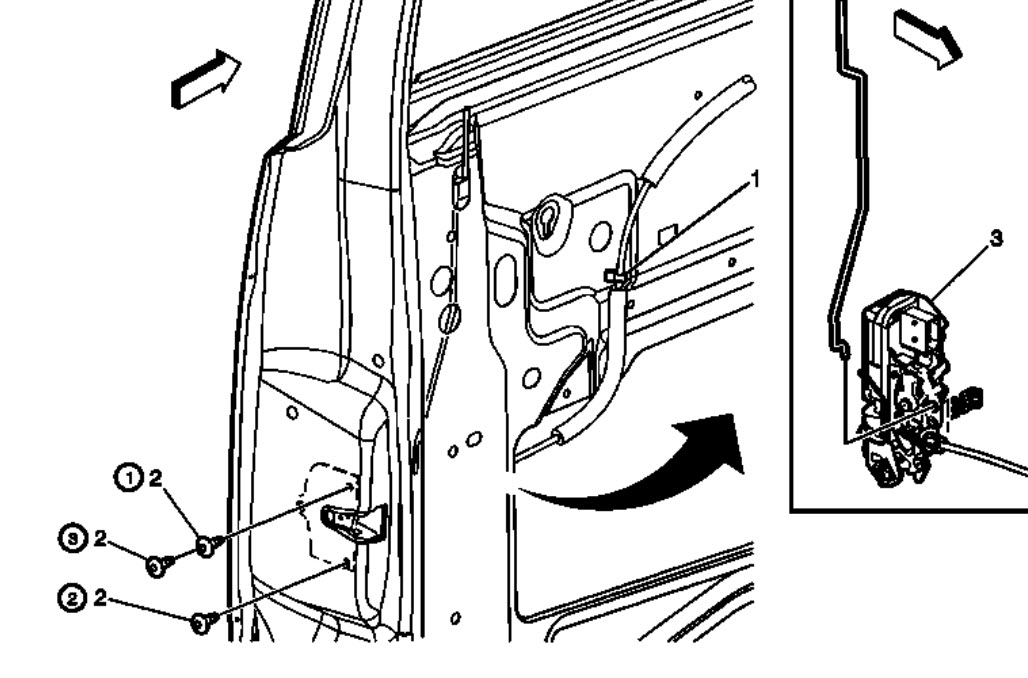

no need to take a door off try using the shaft of a screwdriver to replace the striker and see if it locks that way make sure it isn't locked when you try this see if it frees up if that doesn't work then it's probably a broken latch and will need replacing. you dn't need to take the door off to replace a latch. make sure the screws holding it on door are tight as well see pics these are from a 2012 because we have none of earlier models like yours but are similar.
