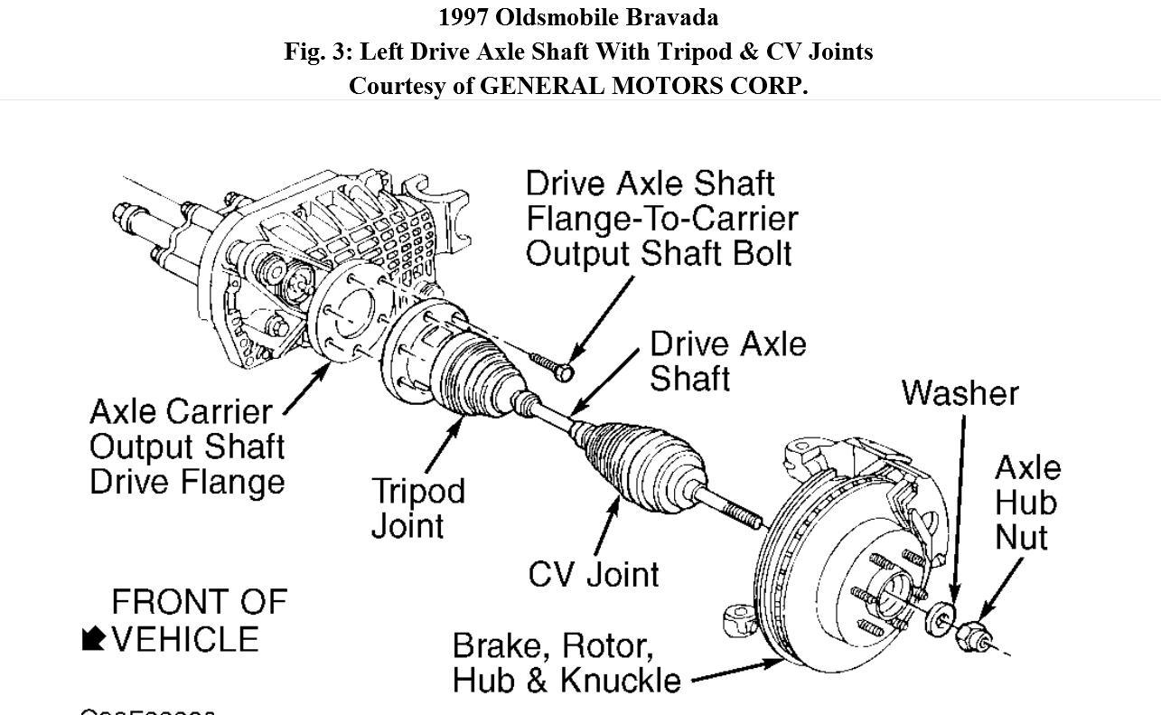

How do I get the drivers side drive axle out of the transmission?
Apr 19, 2013 at 4:21 AM
KHLOW2008
  • 41,814 POSTS
Remove the bolts holding the flange and you might need to remove the knuckle if the spindle does not make it clear.
Apr 19, 2013 at 6:02 AM
RYUZEN312
The tripod part of the shaft has a male end that goes into the transmission. I have taken the flange plate bolts out.
Apr 19, 2013 at 9:43 AM
KHLOW2008
  • 41,814 POSTS
The flange might get stuck. Tap the flange with a hammer to loosen and it should come off.
The part that goesinot transmission need nort be removed if you are only taking the CV shaft out.
