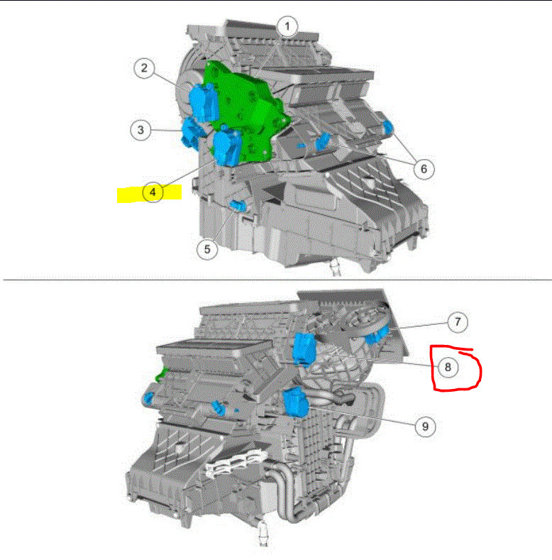

No matter what temperature the HVAC is set to it always blows hot air on the drivers side. the passenger side works flawlessly. My R134 charge is sufficient so i have narrowed it down to the "Mode Door Motor" on the drivers side. Only problem is there is two of them (one for passenger and one for driver) both located in the driver footwell. which one is which? it is a serious pain to get in there so I would like to replace it and move on but I don't want to do it twice. Please help!!

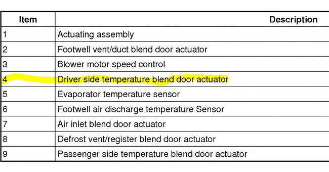

The actuators which control air temperature are the blend air door actuators. The mode actuators are what determine airflow direction.
I attached two pics below. The first is a legend indicating driver's side and passenger's side. In pic 2, I attached a pic and circled the passenger side and highlighted the driver's side.
I hope this helps. I will tell you there were a few options based on production date, so please confirm that I provide a picture of what you are seeing under the dash.
Also, here is a link you may find helpful:
And yes, these are somewhat difficult to replace.
