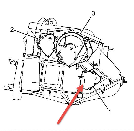

I am looking pictures or a diagram for the location of the drivers side blend door actuator. Any help is appreciated.
Ed

first pull fuse for HVAC inside truck with key on remove for sixty seconds then reinstall it may reset and work once again. unfortunately you have to remove the dash to get this one out unless you can figure something else out. See picture.
