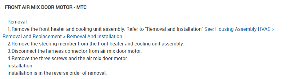

My driver's side blend door has been stuck on heat for some time. Once the truck is warmed up, there is hot air constantly weeping from the driver's side vents, even when the blower is off. The passenger side seems unaffected.
Where is the actuator physically located in the vehicle? I'd like to replace it myself, but my Haynes manual is useless in this regard.

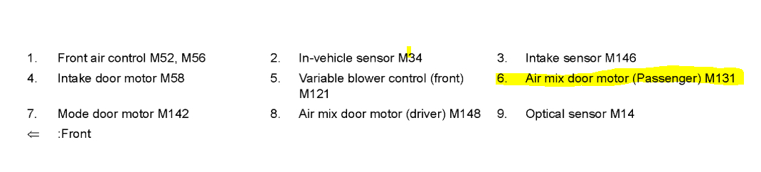

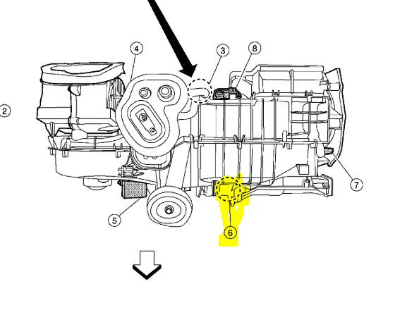

Hi:
I need to know if you have automatic climate control or manual.

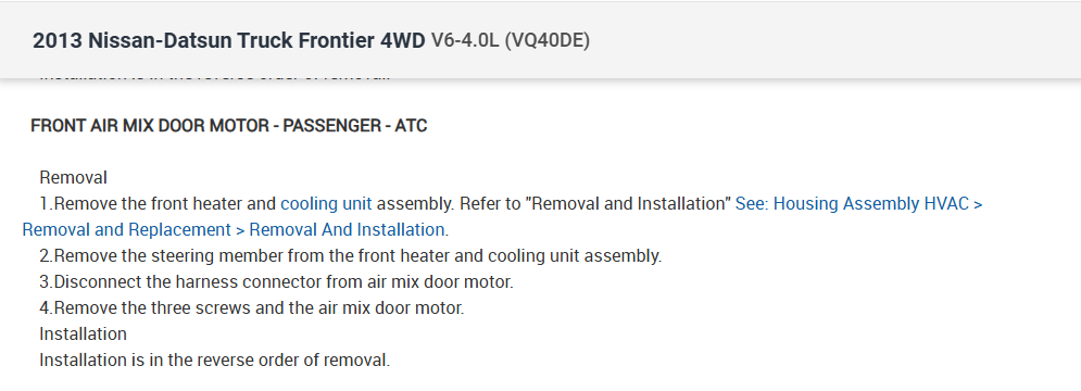

Regardless of which you have, this isn't an easy one. If you look below, I have attached a picture of its location along with the directions for replacing it. Note that the component is under the dash. On this vehicle, it appears a good bit needs to be removed to access it.
I am providing the basic directions for the automatic climate control. If you have something different, I need to know. Once I get that info, I can provide more detailed directions.
See pics below. Pic 3 indicates ATC. That is automatic temp control. Pic 4 is for manual. Note the things highlighted in blue. Those are the directions for accessing it. I will provide that once we confirm the system you have.

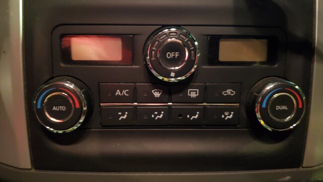

THAT111GUY
Hi Joe,
Thanks so much for the reply. I have automatic climate control. I should have included that detail when I posted the question. I've added an image of the controls to confirm.
It is the driver's side that is affected, not the passenger side. Heat always on the driver's side.

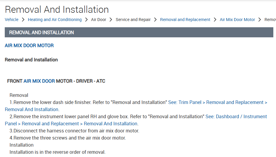

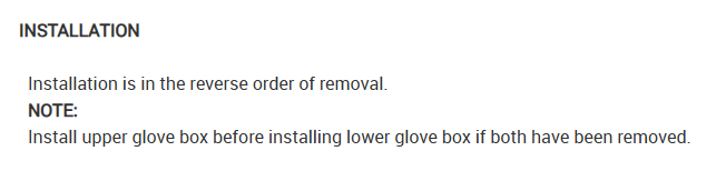

Hi:
No problem whatsoever. I just hope I help. LOL

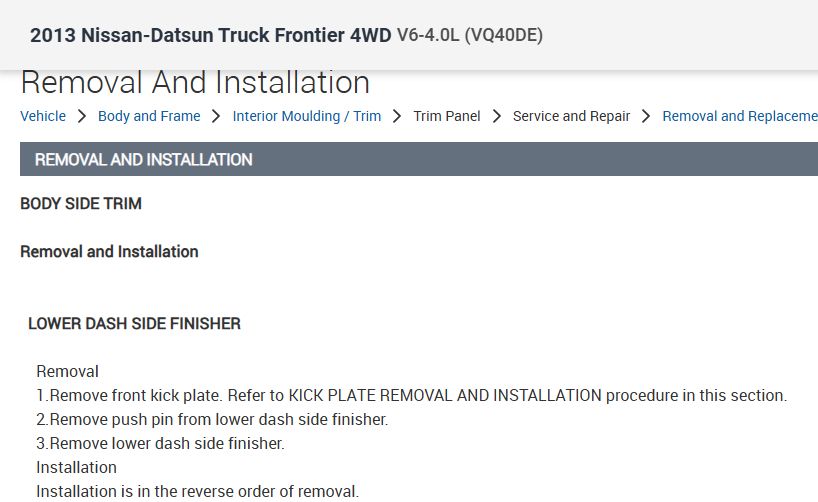

I attached the directions for the driver's side (auto air). The first pic is the basic directions. The remaining pics are the pages that are highlighted in the basic directions.
Take a look and let me know if you have questions.
Take care and let me know how things work out for you.

THAT111GUY
Joe,
Thank you so much. I will search to define "lower dash side finisher", "kick plate" and "instrument lower panel RH" with an image to ensure I'm removing the correct portion before I get started. My Haynes manual shows how to remove the dash, but doesn't refer to the components with the same names.
I assume RH is right hand side? Is is correct that the driver's side air mix door motor is accessed through the passenger side, or am I reading that wrong?
