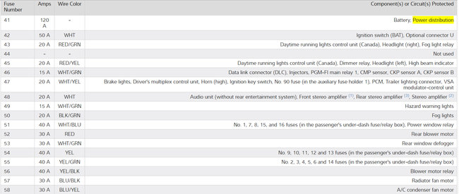

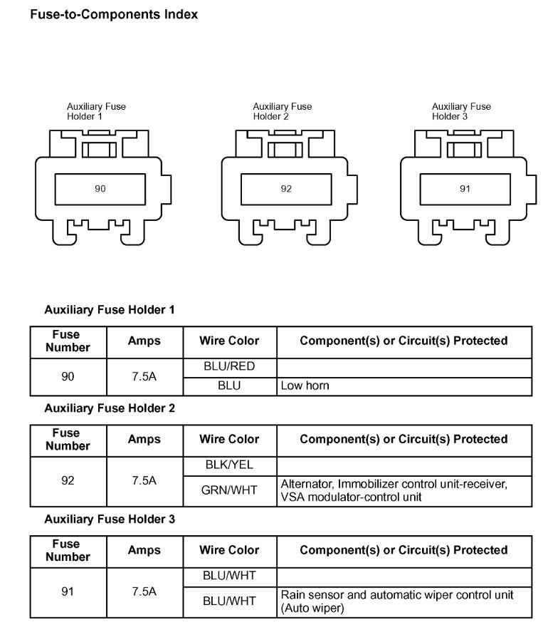

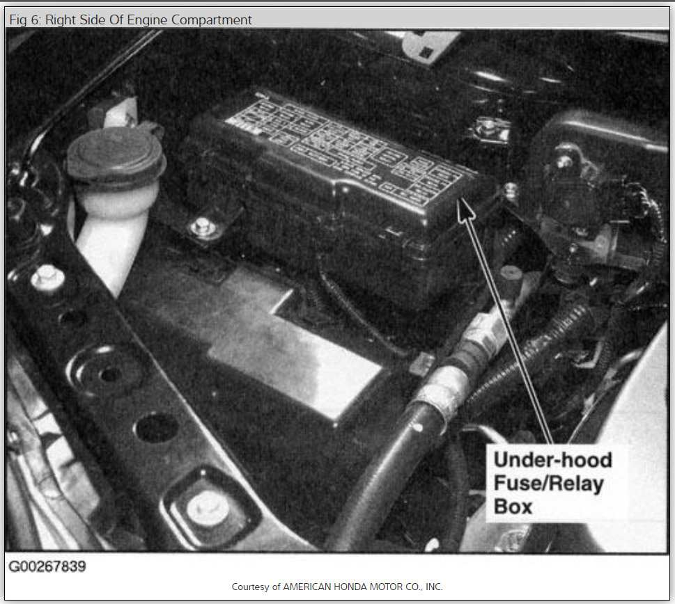

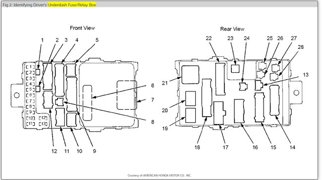

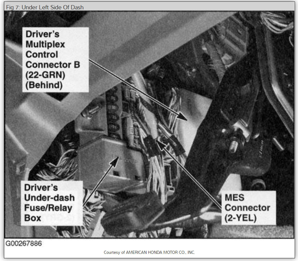

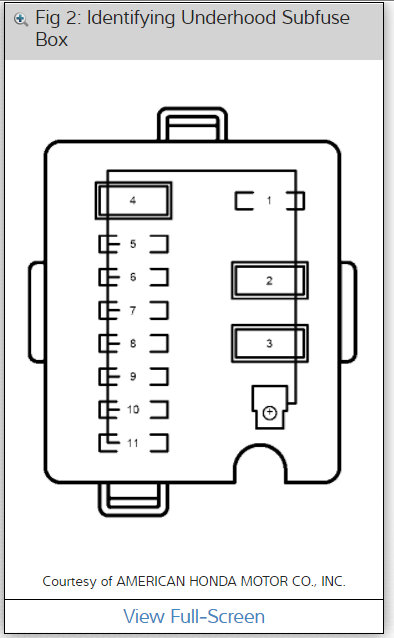

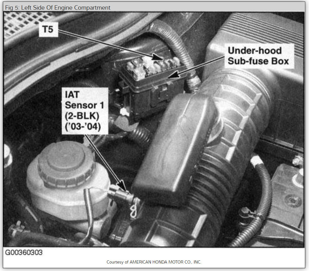

I have located every fuse box except the one I need. The drivers side auxiliary fuse box. It has three fuses in it. Cannot find it for the life of me. I see it on the diagrams so I know it exists, but there is no diagram showing the location in the car. I can replace engines, transmissions, etc., but I cannot replace a 7.5 fuse. :-)
Mar 15, 2018 at 1:58 PM
  • 55,746 POSTS

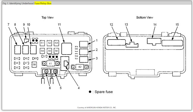

Here is the full fuse panel location and identification for your car (BELOW) and a guide to help you check the fuses. Please let us know if you need anything else to get the problem fixed. Aux fuses should be attached to main fuse panel

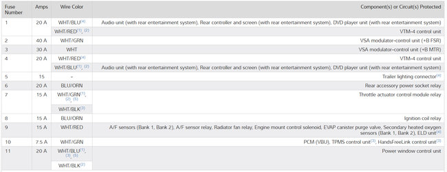

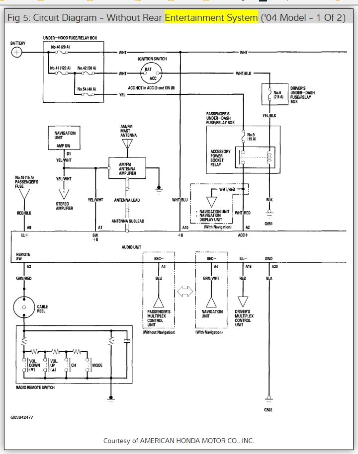

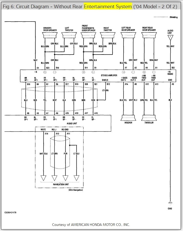

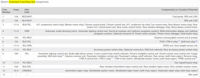

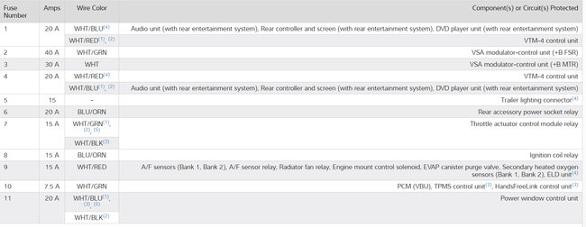

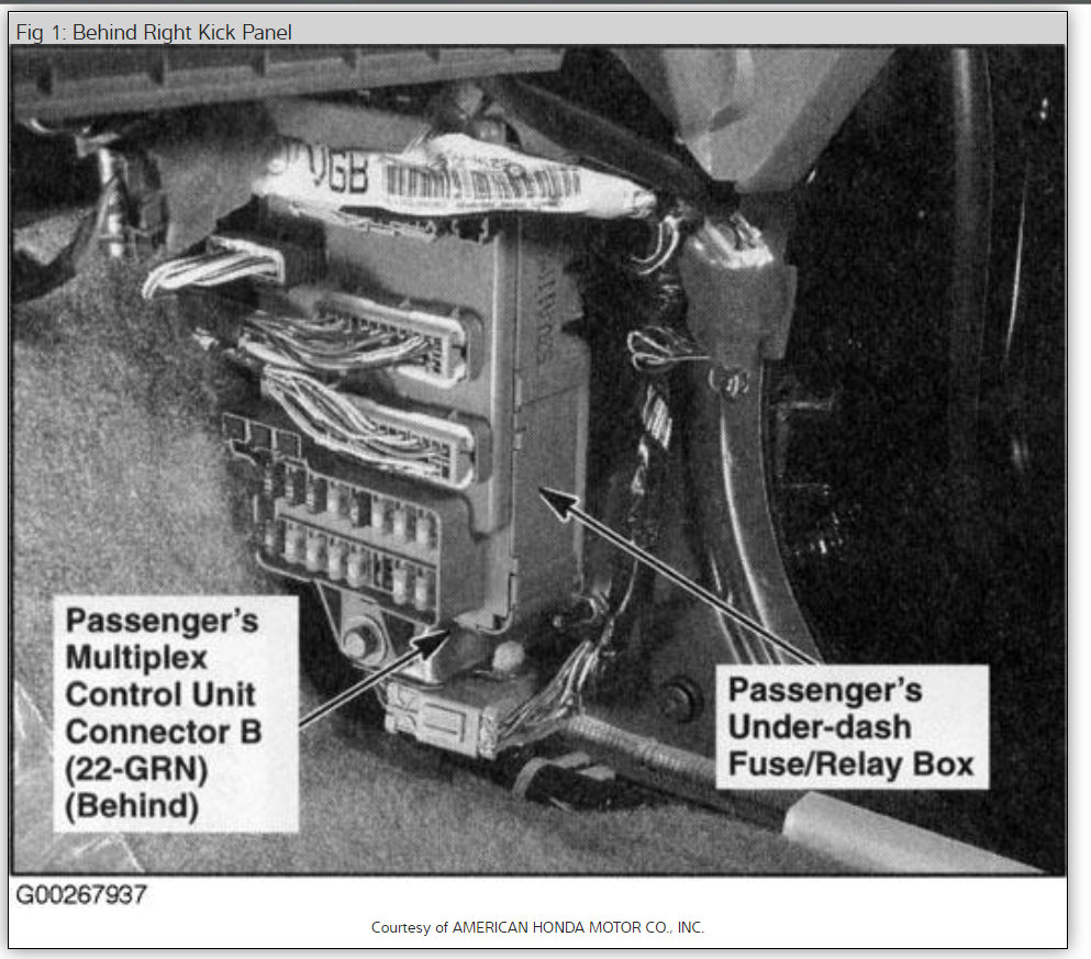

I've found three,one side panel drivers side,the other side panel passenger's side, and one under the hood.I was told that there is five of them,and I am looking for the one for the CD,Tape player.THX Again
May 9, 2019 at 10:24 AM (Merged)
  • 55,746 POSTS
Hey Etap
They are supported by several fuses, under the hood, fuse 48;driver side, fuse 8;passenger side, fuse 9 if you have a factory dvd player installed its fuse 4 in underhood sub fuse box. There's another fuse box in the left rear of the car but it's not related to your current problem. Check out the diagrams (Below). Please let us know what you find.
