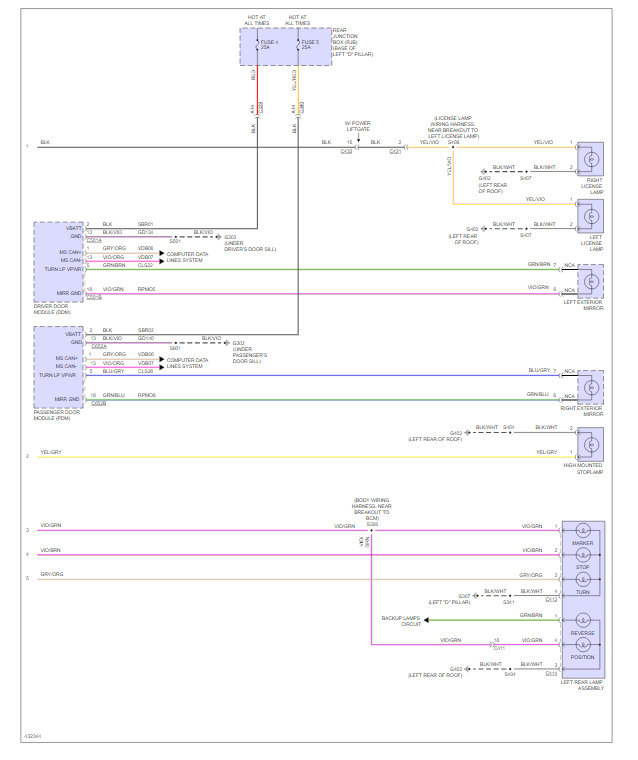

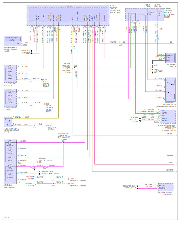

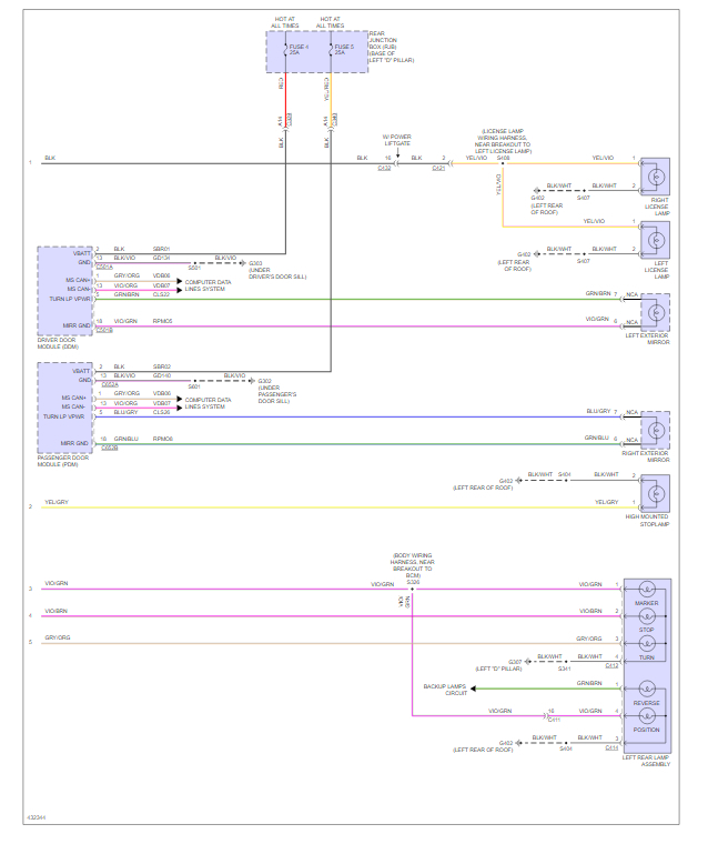

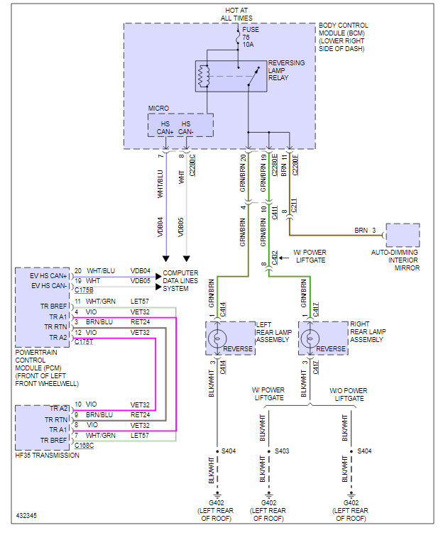

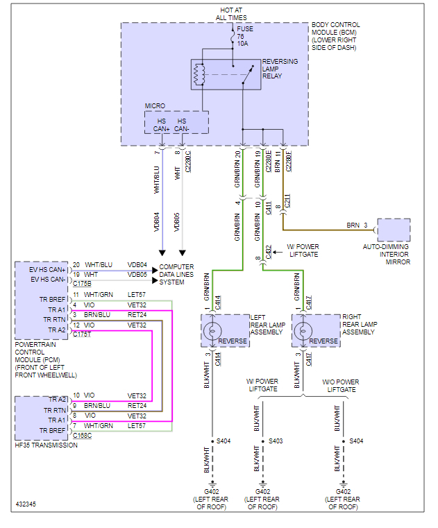

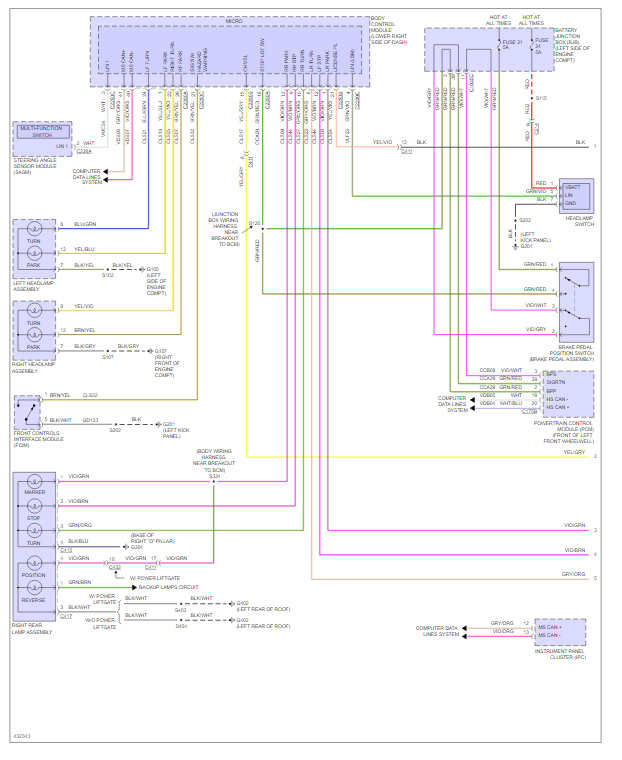

Replaced light bulb and it blew out soon as the brakes was applied. Fuse the problem?
Feb 4, 2019 at 11:34 AM
SCGRANTURISMO
  • 4,897 POSTS
It sounds to me like you have a short to power with the marker light wire and the stop light wire. I am including all the wiring diagrams for the external lights on your vehicle. Hope this helps and let us know what you find out.
