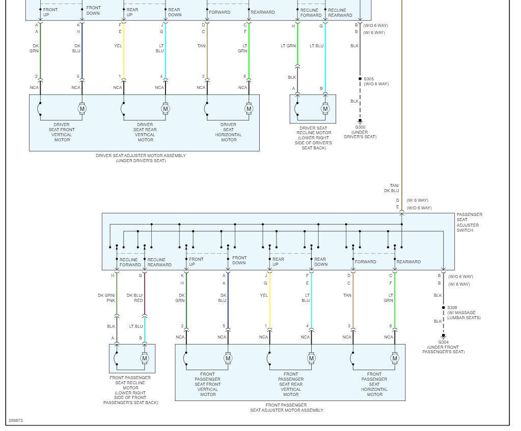

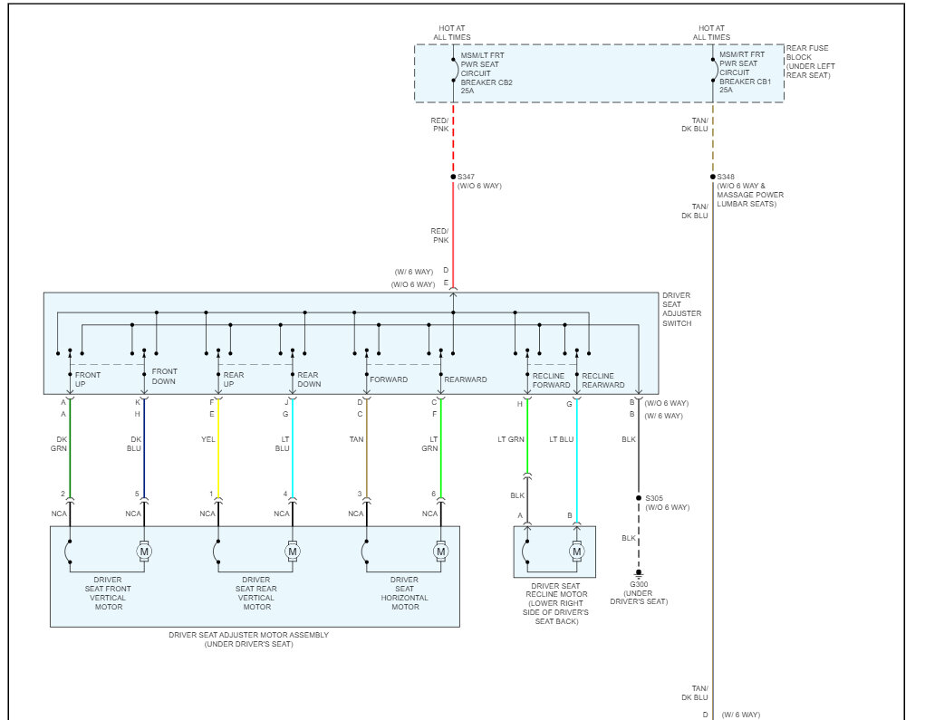

The driver's seat will not move at all nor will the heated/cooling seating work?
2007 CADILLAC DEVILLE DTS
135,000 MILES • 4.7L • V8 • 2WD • AUTOMATIC
MLRJONES
I also noticed the tilt/periscope steering is not working. I'm thinking they're tied in together.
Jun 26, 2023 at 1:57 AM
  • 55,402 POSTS

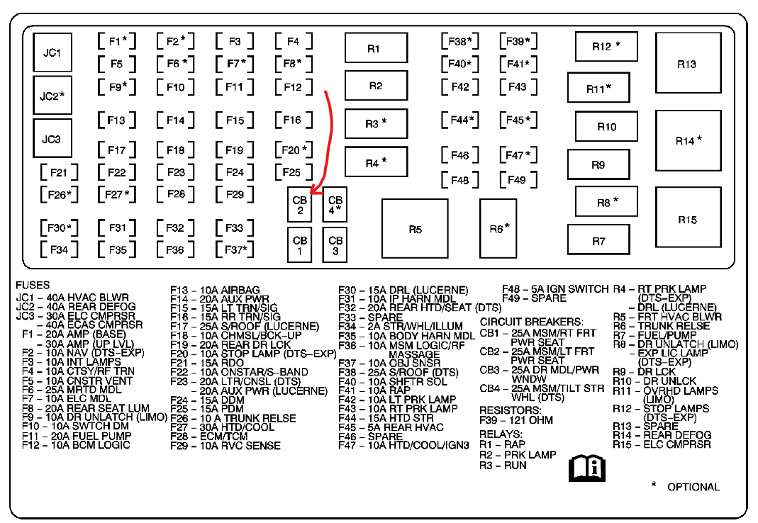

Yes, in the rear fuse panel under the rear seat is a circuit breaker called MSM/LT FRT Breaker CB2 we need to check for power on both sides because it sounds like it is not working. This guide can help, and I have included the location of the circuit breaker in the images below as well:
Check out the images (below). Please let us know how it goes
