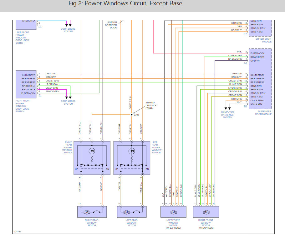

The driver’s window will not go up sometimes! The previous owner replaced the switch motor and module in the door! I have a scan tool and can see when using the switch to go you can see it’s sending the command but will not go up! You can also hear the module in door click! I’m suspecting it has a wiring problem in the door or on the floor to module under the seat but can’t find a wiring diagram! Could you please help! Thanks
Nov 27, 2022 at 2:16 PM
  • 55,433 POSTS

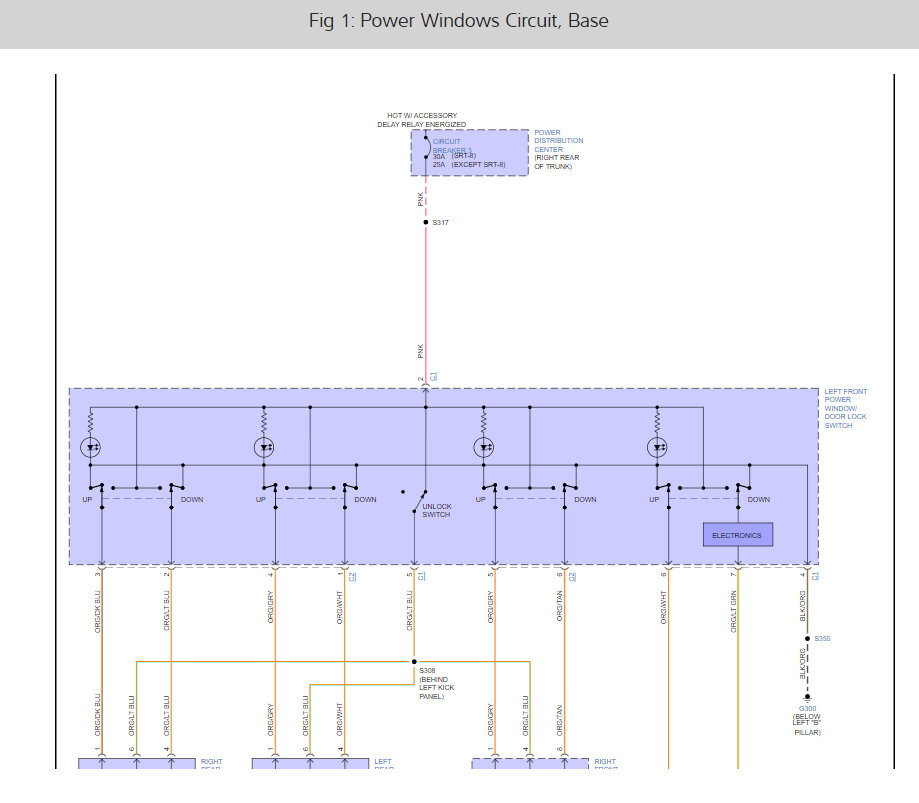

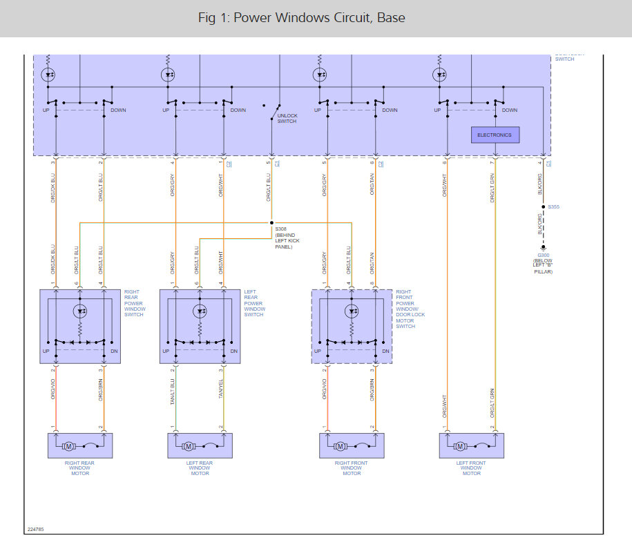

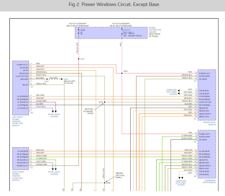

There are two styles of window wiring which I have included in the images below. If it was an inexpensive window motor replacement, I would suspect that first.
Here is a guide to help you test for power:
Nov 28, 2022 at 5:30 AM
CHARLIEBROWN 469
Thanks so much Ken for the quick reply and the wiring diagrams. After taking the door panel off and checking everything using the manual, I found out there was no output from the driver’s door module! Replaced and working like a charm.
