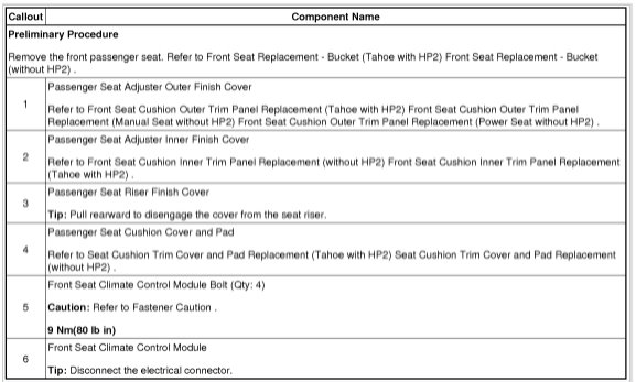

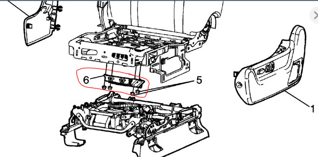

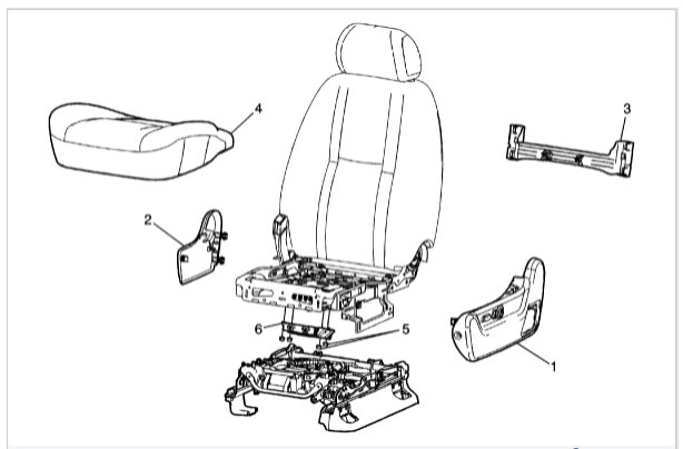

Yes, it sounds like you are having an issue with the power seat module. The are bolted directly underneath the seat base. I've attached picture steps below on how to remove and replace. I've circled the location of the module in the picture and circled in red. Hope this helps and thanks for using 2CarPros.
