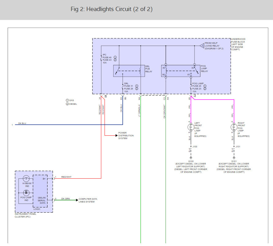

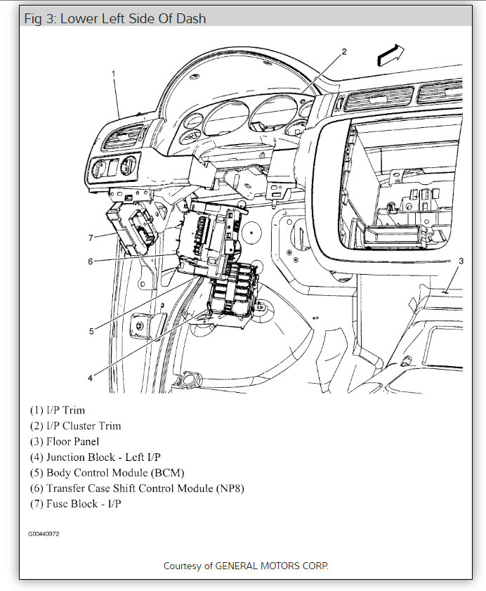

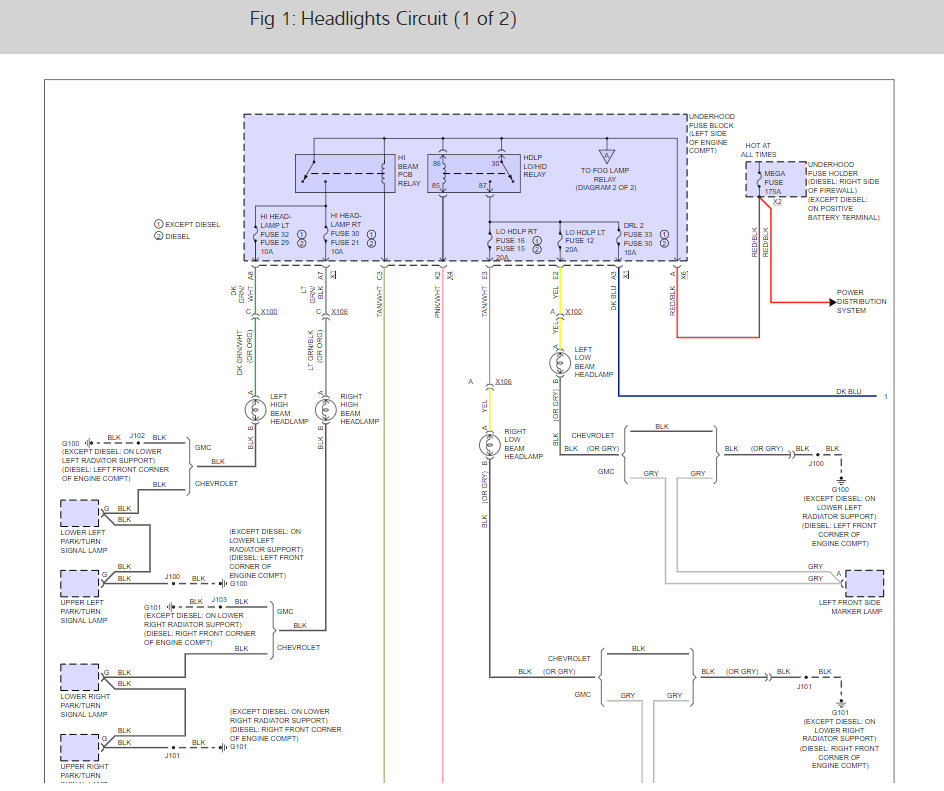

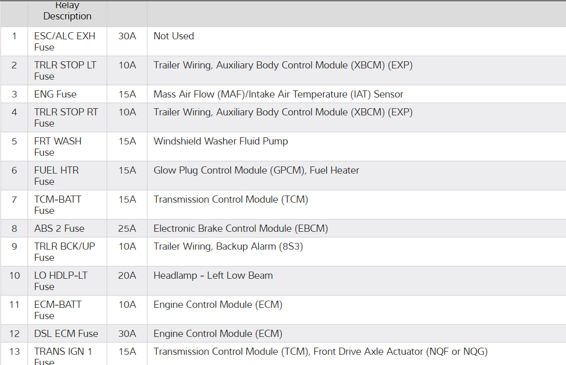

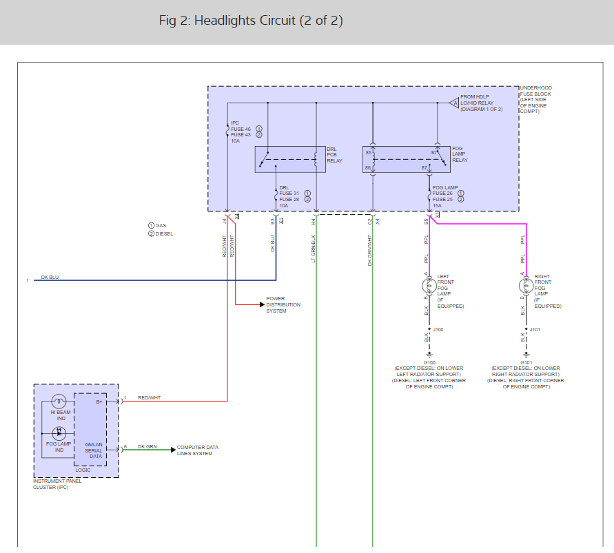

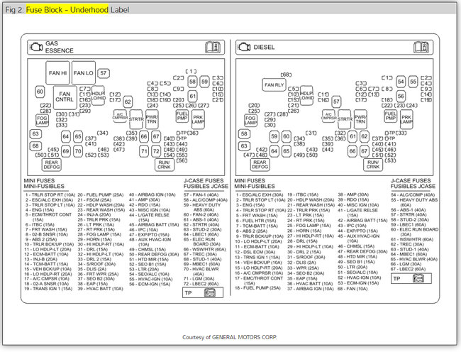

Low beam does not work neither does daytime running light. The high beams are both fine. All fuses are okay, but I have no power in the lite socket with bulb removed. Is there a body control module or something else that could be wrong? Where can I find it and how can I test or replace it? Any wiring diagram or solutions would be appreciated. Thanks, I am new to this site and hoping for some insight.
Nov 9, 2018 at 9:14 PM
  • 55,710 POSTS

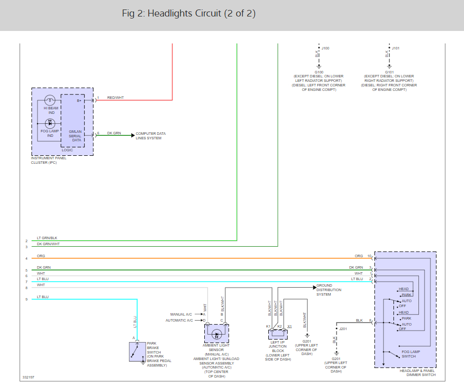

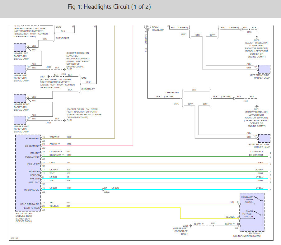

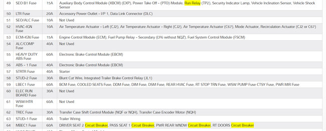

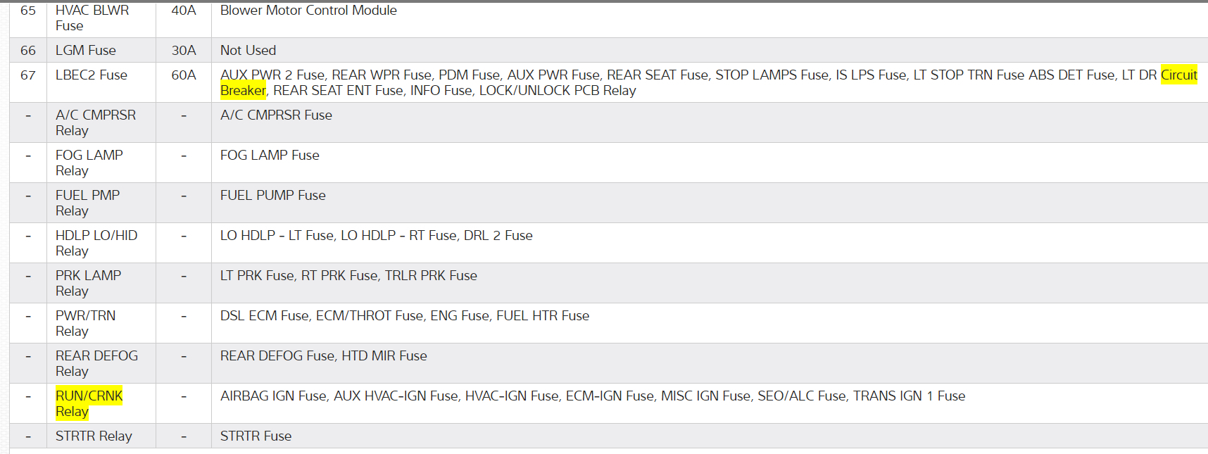

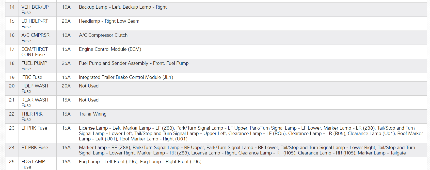

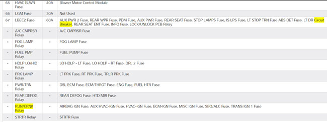

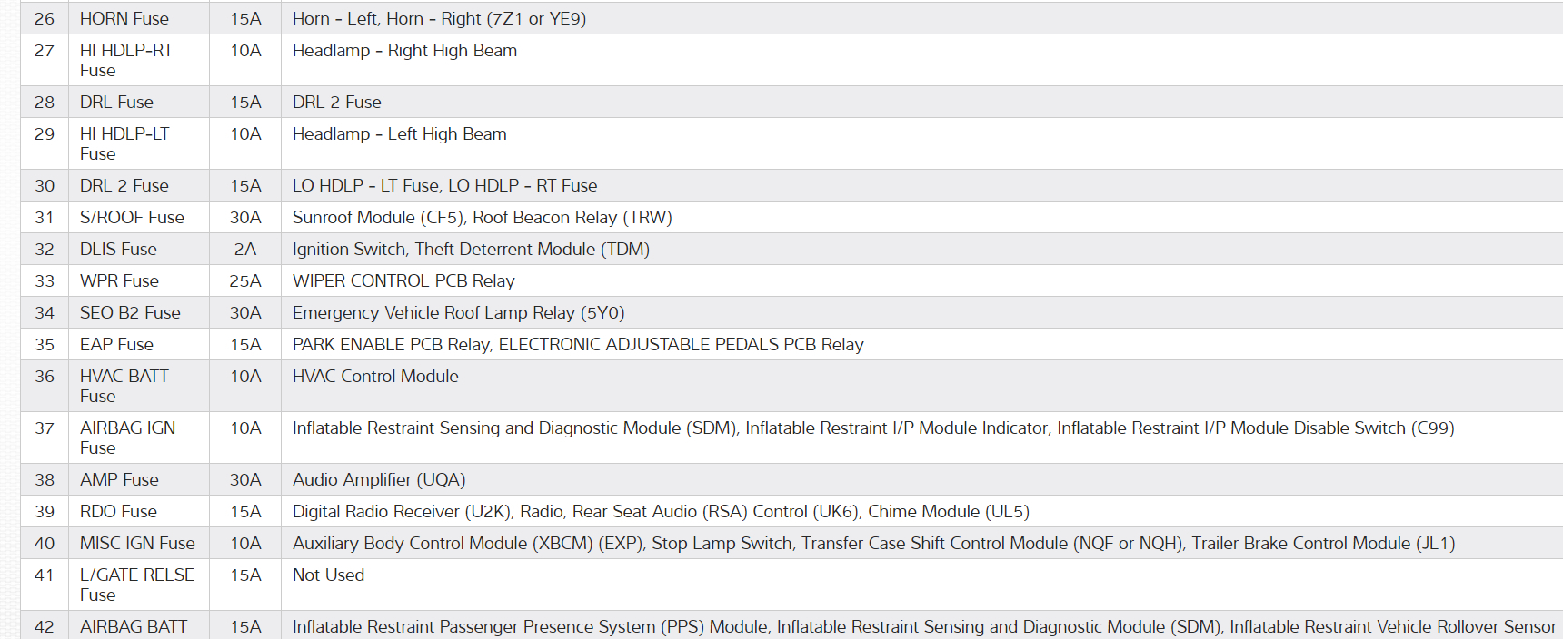

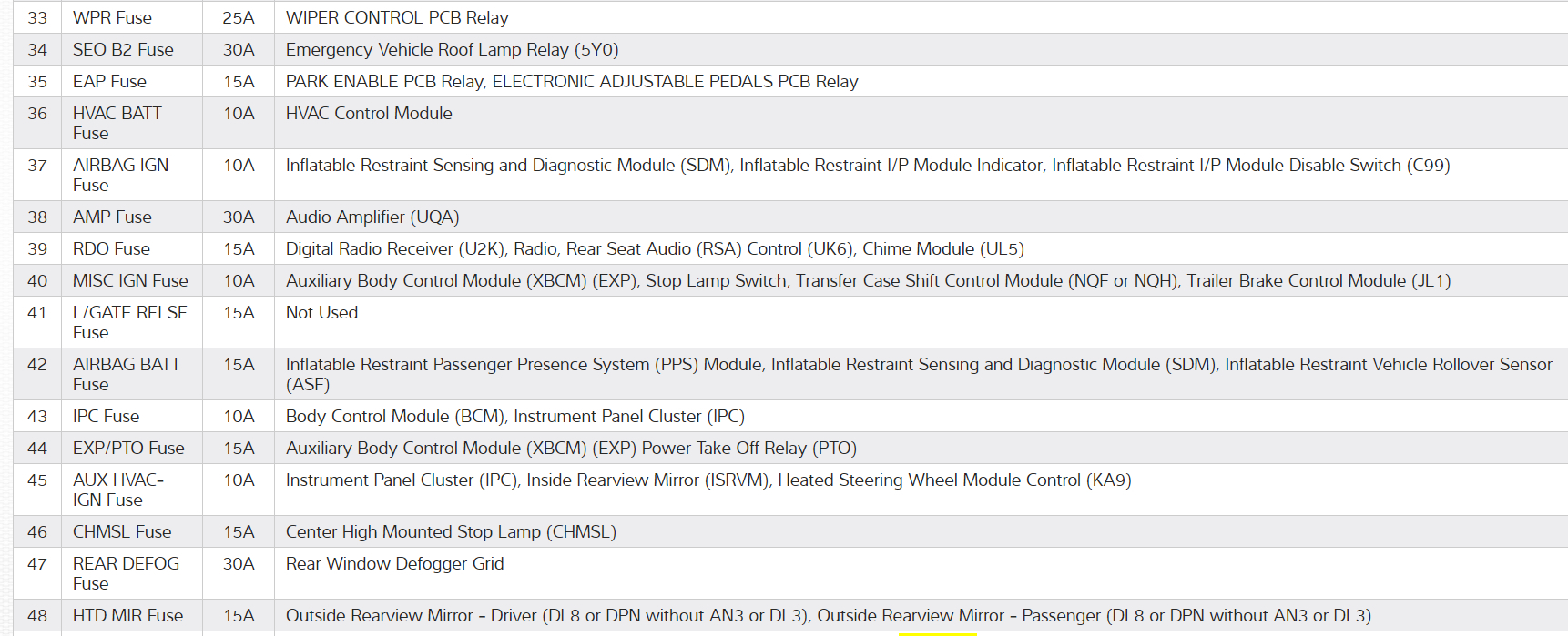

It sounds like the BCM (body control module) is out or fuse #12 under the hood is blown. Here is a guide to help you test for power at the fuse along with the fuse panel information and locations:

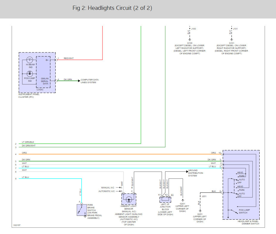

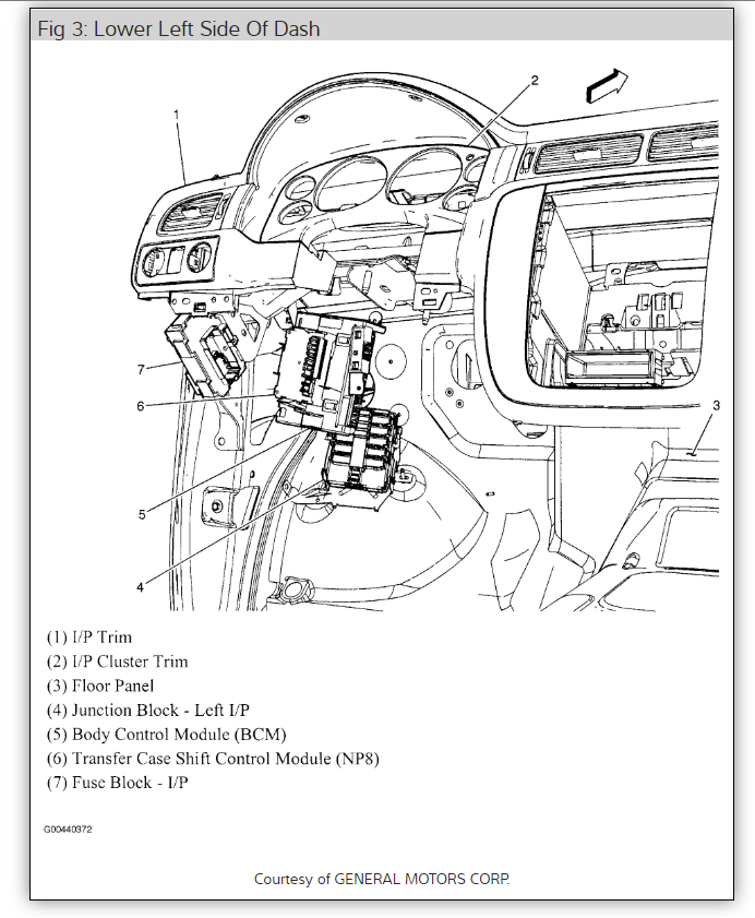

If the fuse is good then both headlight should work check out the headlight wiring diagrams to see how the system works and the BCM location.
