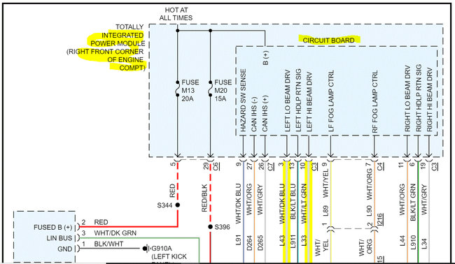

Around two days ago I lost power to my driver side headlight, yet my passenger side works just as good. I don’t believe the light went out due to the fact that the voltage coming out of the connector was lower than what my passenger side connector was putting out. Connectors seem to be clean and not corroded. I understand the basics of figuring out electrical issues but since the wiring in these vehicles are set up the way they are, this one has me stumped.

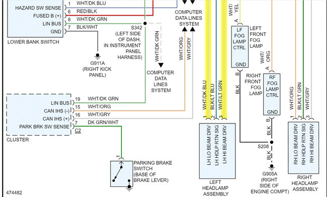

The headlamps are controlled by a printed circuit board in the totally integrated power module (TIPM). Because the module has so many wires coming from it, the pins in the connectors are very small and are known to break, corrode, or simply push in and lose connection.
Based on your description, I suspect this is where the issue is coming from. If you look at pics 1 and 2 below, I included the wiring schematic for the headlamps. When you check the voltage on the white wire with the dark blue tracer and then the white wire with the light green tracer, do you get 12v?
If not, the TIPM is part of the under-hood fuse box. Disconnect the battery and remove the box so you can access the connectors under it. In connector 3, locate pins 3 and 10. Inspect the pins for damage, corrosion, or anything that would limit the amount of power that can be transmitted.
If everything appears good, check the voltage at those pins. If it is low there as well, chances are the TIPM needs to be replaced.
Let me know what you find.

I made sure to check what was coming out of the TIPM and it had a good reading, both on the high and low beam pins. So far, I have checked the plug where the headlights plugin at, and that's where I've found the low voltage to be. I currently have aftermarket LEDs hooked up, yet I reverted back to my factory Halogens and still the same issue. Would this be a grounding issue or a bad connection somewhere along the wiring harness for the headlights? If you have one available, would you be able to send a picture of the entire headlight wiring harness diagram?

The pics above are the entire schematic for the headlamps. If you need something enlarged, let me know.
As far as your issue, I assume you checked the connector pins to make sure nothing is corroded or damaged. So, that leaves the wire itself that has too much resistance. It could be partially broken internally, cut, or shorted at some point.
When you check for power at the TIPM, are you getting 12v? What are you getting at the lamp assembly?
