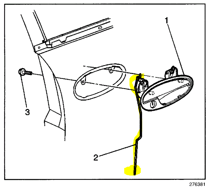

I have the car listed above SL model. I am having problems opening the driver’s door from inside and outside. On the inside I have to yank hard and fast to get it to open. I’m afraid something is going to break.
On the outside handle I have to yank it in upwards motion, and it will open.
What do I need to replace? Thank you!

I don't think anything needs to be replaced, but rather, I feel there may be an adjustment issue.
Because of the model year, I don't have a ton of specifics, but I will try my best to explain.
Both interior and exterior have a linkage between the handle and the door latch. If you look at pic 1, it shows the linkage rod from the outside latch. If I recall, the interior handle has a cable and not a steel rod.

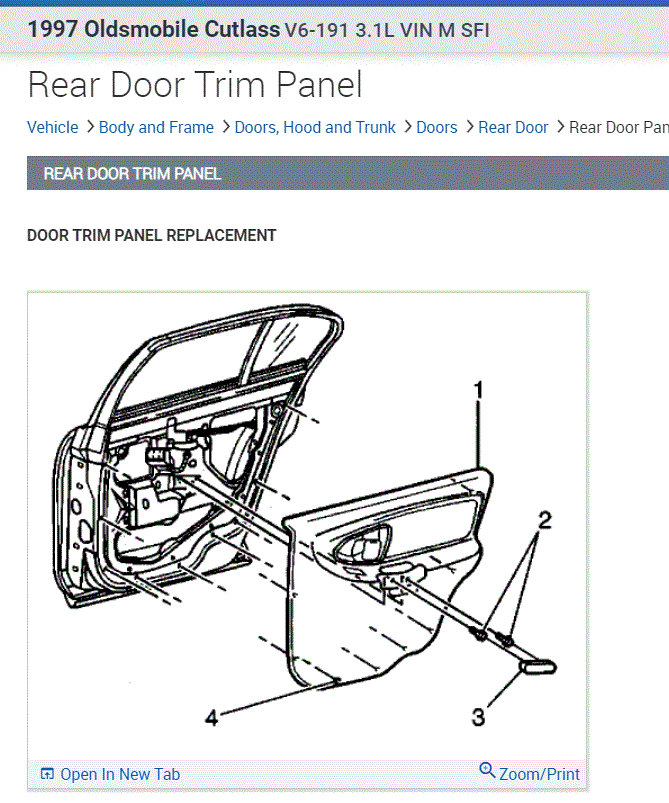

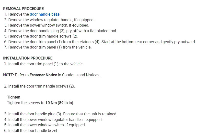

What we need to do is remove the interior door, trim panel. The remaining pics show how that is done. Once it is removed, look inside the door where the latch assembly is located. Check for evidence of either of the linkages slipping. If you can get a picture for me, it may help me identify a potential problem.

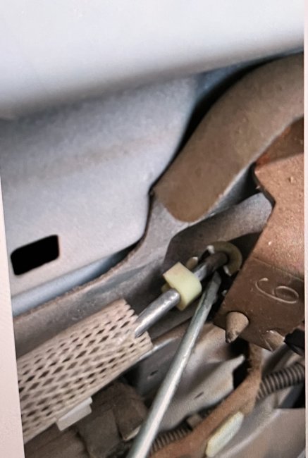

I finally removed the door panel and found the plastic piece broken. It’s at the end of the screwdriver.
I’ve got the plastic piece off and have a new one, but the rod came off the other end and I’m not sure where or how it attached. It’s very hard to see where it goes.

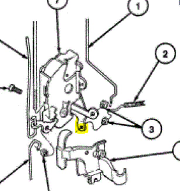

At the other end of the linkage (steer rod), it connects to the door latch assembly the same way as the one in your picture.
I found a pic of the latch assembly and highlighted where (if I recall correctly) where it attaches. However, are you sure it is also detached?
See pic 1.

Yes, the rod is in my box of parts. It is difficult to see in the door where it is to attach.
