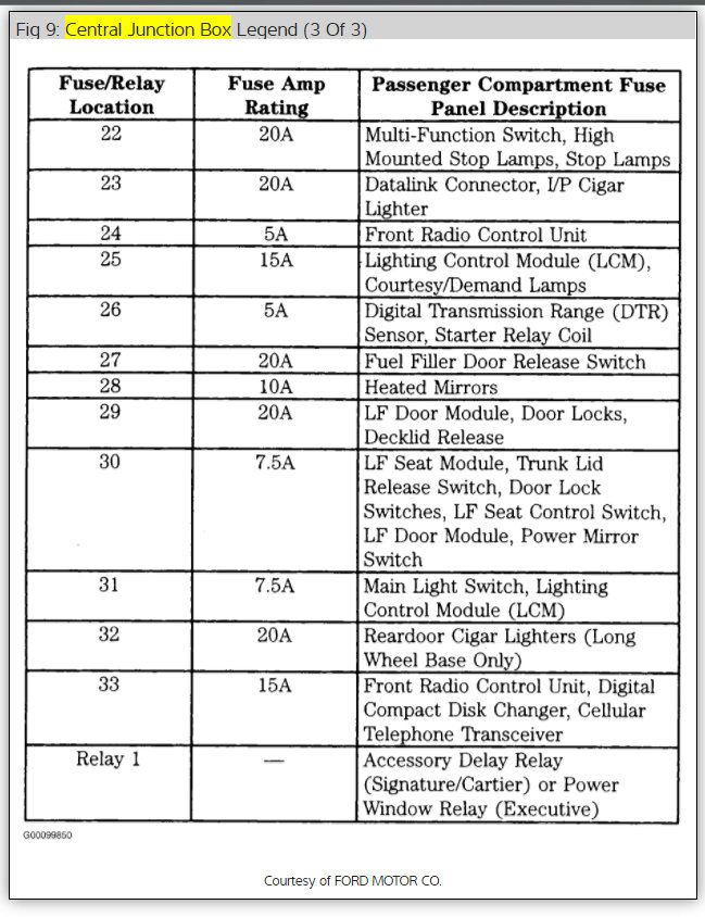

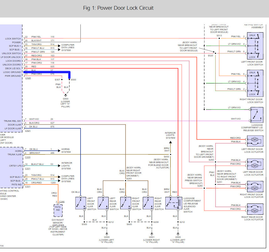

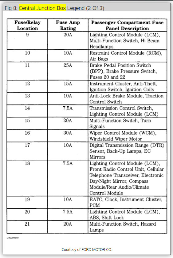

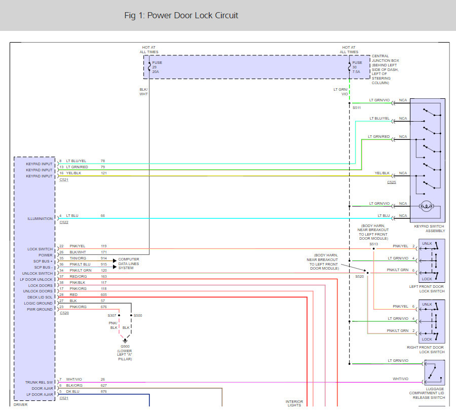

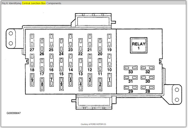

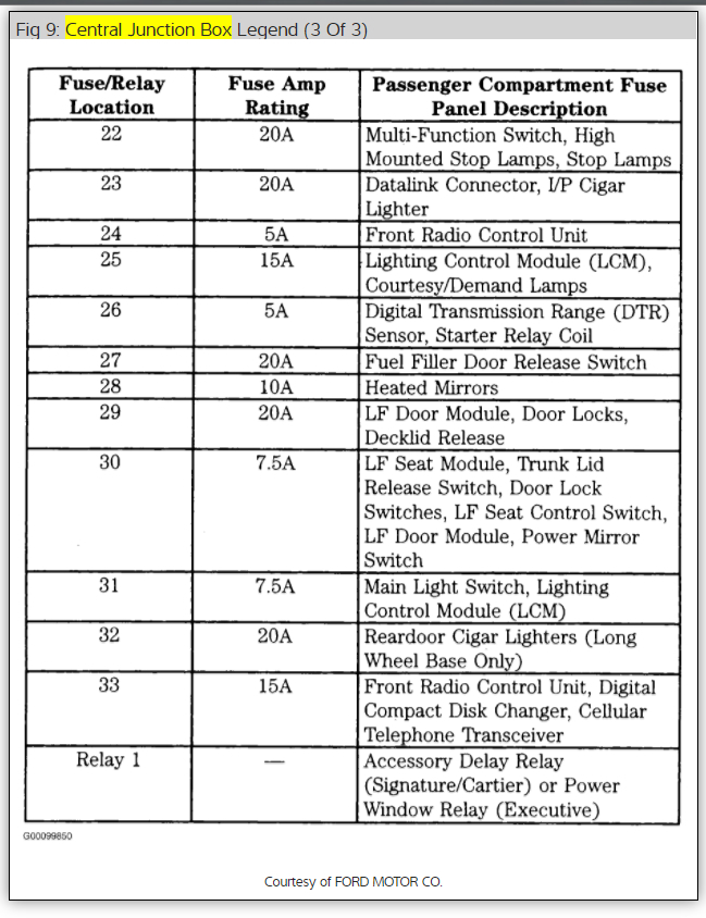

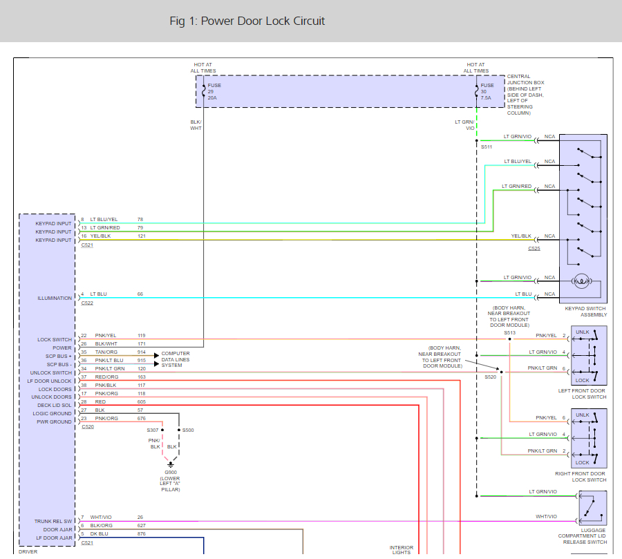

My drivers door module is not getting power. what relay supplies power to this module?
Thank you,
Robert
Aug 11, 2017 at 1:22 AM
Experienced Mechanic
55,721 POSTS
It looks like it is fuse #29 that power up the system. Here is a guide and a diagram (Below) to help you get the job fixed:
