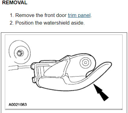

Hello, the drivers door is locked and will not unlock. It makes a noise like it is going to unlock but it dose not. I have tried the key fob and also the key to unlock it and no success. The door handle on the outside of the vehicle has no tension on it. Need some help if you can please.

It sounds like you have either a broken outer door handle or door actuator. The door handle itself uses mechanical linkage to lock/unlock door and the door actuator is an electrical plunger to move the mechanical linkage via your key fob. You are going to have to remove the door panel to check and see what is broken.

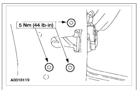

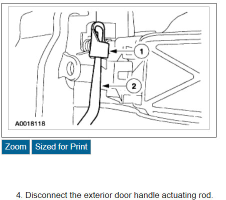

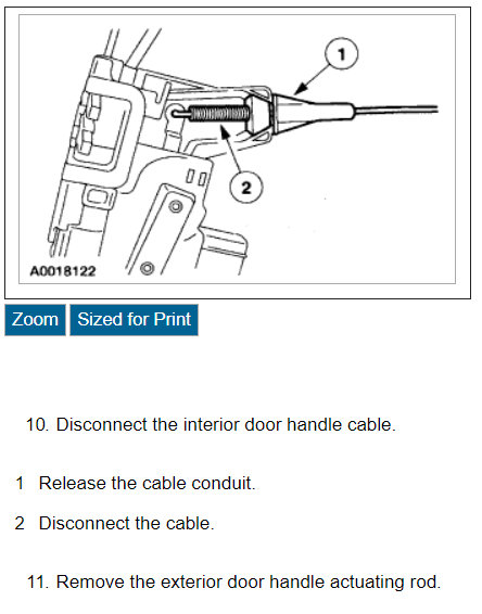

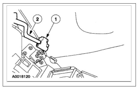

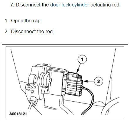

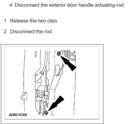

If the lock actuator is locked up which happens you will need to remove the door panel which includes removing the driver's seat which can be difficult with the door closed. I have seen my guys remove both passenger and drivers seat to gain access. To the door panel. Once the seat is removed. Here is a guide to help you remove the door panel and diagrams below on what to do from there:
https://www.2carpros.com/articles/door-panel-removal
You see that level on the last diagram this is the one you must work to get the door open.
