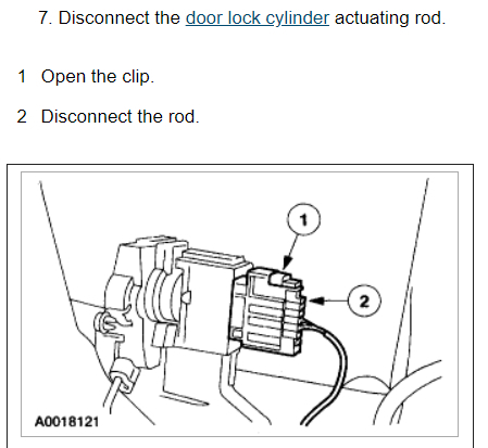

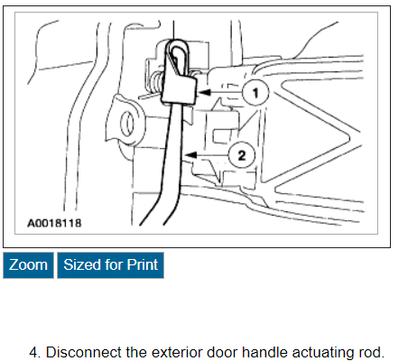

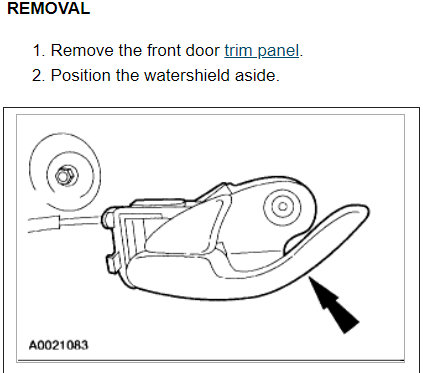

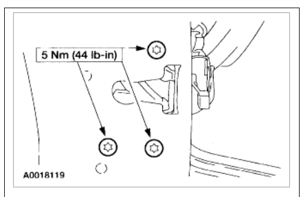

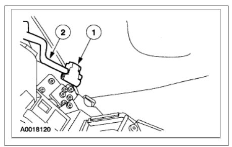

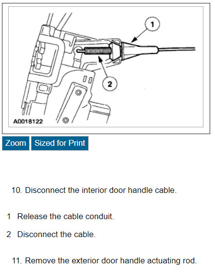

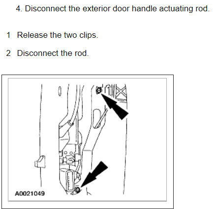

If the lock actuator is locked up which happens you will need to remove the door panel which includes removing the driver's seat which can be difficult with the door closed. I have seen my guys remove both passenger and drivers seat to gain access. To the door panel. Once the seat is removed. Here is a guide to help you remove the door panel and diagrams below on what to do from there:
https://www.2carpros.com/articles/door-panel-removal
You see that level on the last diagram this is the one you must work to get the door open.
