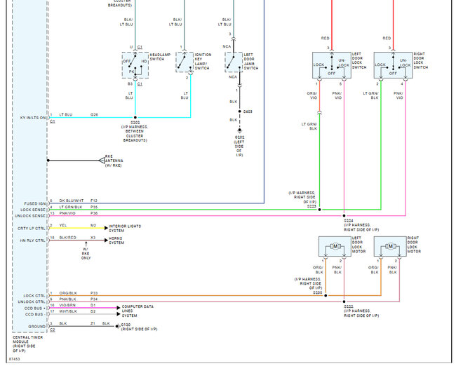

So chances are the door lock actuator fuse is out or the actuator itself, but I have see the wires at the door jam break and cause this problem as well, also have you tried a new master switch? This would be the first place I start. Here is a guide for a test light and the door lock wiring diagrams so you can see if the lock actuator is getting power.
https://www.youtube.com/watch?v=Hlna_kUt7As
Please let me know what you find.

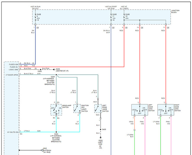

  • 55,691 POSTS
Yep, sounds good, that is wear I would look first besides the fuses in the images above. Check fuse # 6 and #11.

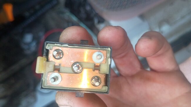

I haven't had time to work on the truck yet. My bad to keep you waiting. Just so you know, I do have a multimeter and a test light and immediately semi cognitive of how to use them except for checking continuity with the multimeter. I haven't gotten that far yet. But using the door lock switch on the driver's side locks the passenger door but I don't hear anything from the driver's door suggesting that it's even trying to lock. I'm going to check that light green and black wire in the morning and try to figure out how to properly repair the actuator I think you called it

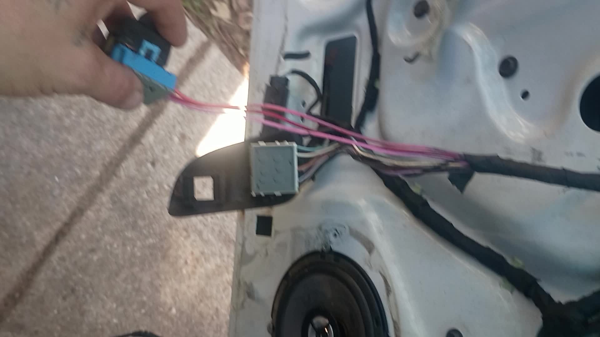

So I multimeter the switch and that confused me lol. I'm going to add another picture of the inside of the switch

  • 121 POSTS
Fuses 6 and 11 are good

The switch

I tested the harness connector and both lock and unlock get power.

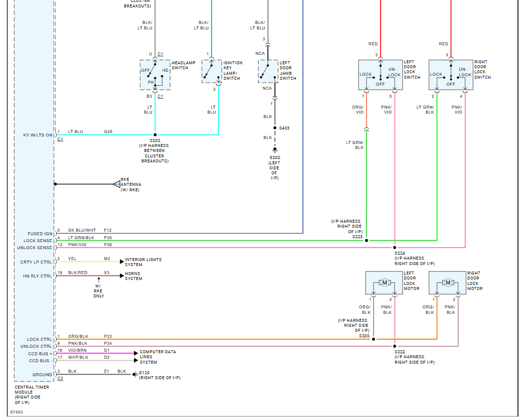

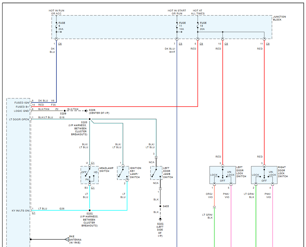

  • 55,691 POSTS
Hmm, I would make sure the ground is good for a test light, you said you have correct? And test the org/blk for power at the lock actuator itself when you move the switch one way or the other, then check for power at the pnk/blk wire when you work the switch the other way. The ground and power alternator depending if the switch is lock or unlock. As you can see by the wiring diagrams the switch goes into the timer module, so that might be bad but if you have power at these wires I would replace the lock actuator.

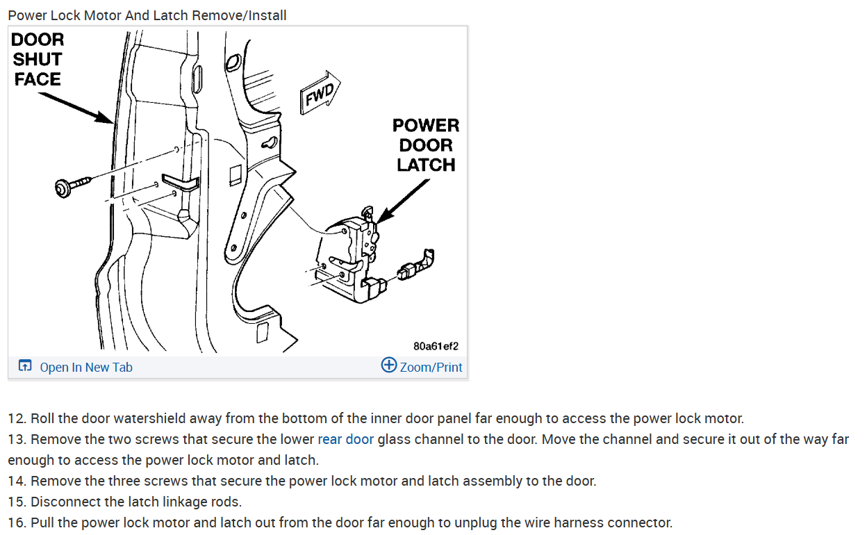

  • 55,691 POSTS

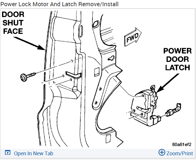

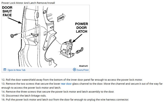

You just need to test the wiring going to the lock actuator/latch. Here is how to remove the latch/lock actuator
Sep 19, 2026 at 11:37 AM

Ok I have already done that and got voltage on both pins of the harness.
Sep 19, 2026 at 11:45 AM
  • 55,691 POSTS
Yep, unless the grounds are not working from the timer module I would replace the latch, you can get a used one from ebay and just plug it in to see if it works.

DALEC6328
  • 121 POSTS
Door latch or that entire lock assembly? We're going to go to the junk yard
Sep 19, 2026 at 10:00 PM
  • 55,691 POSTS
Just the latch, it is a power latch so the lock solenoid is inside of it.
