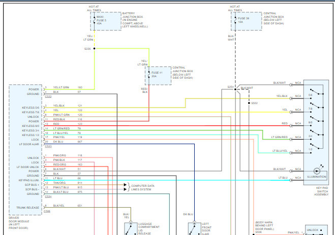

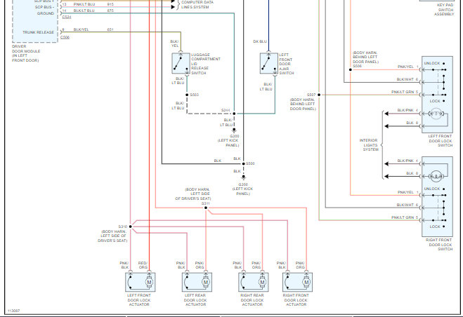

My wife has this vehicle and one day all the electrical components associated with the driver's door stopped working. The key fobs no longer work, cannot make any seat adjustments, nothing on the door itself works. After doing some research, I found that the driver's door module may be bad, although a mechanic friend suggested I check the wiring for voltage. Without knowing which wires are supposed to be hot and weather it's supposed to be 5 or 12 or ? volts, it seems like a waste of time to open the door panel up. All fuses are good and relays work and have even been switched around (compatible with other areas like turn signal, wipers, etc.). Any help would be greatly appreciated !

There isn't one diagram for everything in the door. If the wires are okay, we'll have to pick one system and start with that

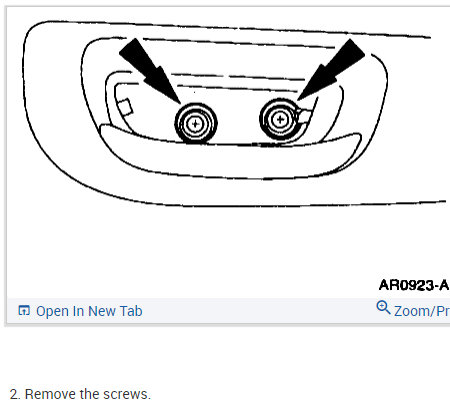

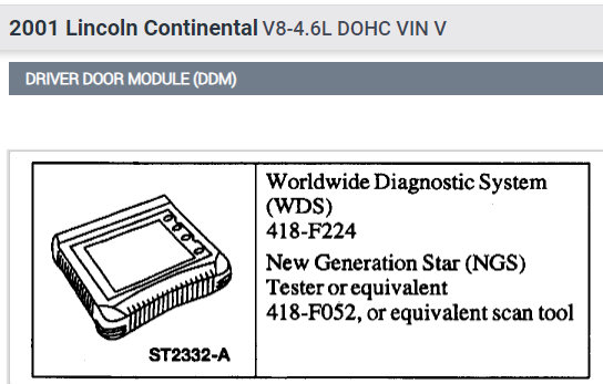

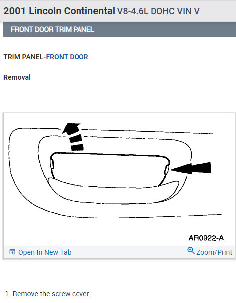

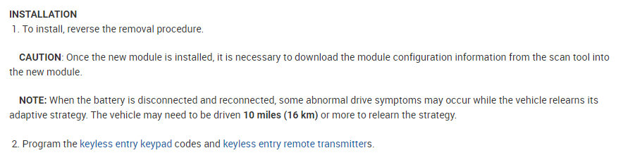

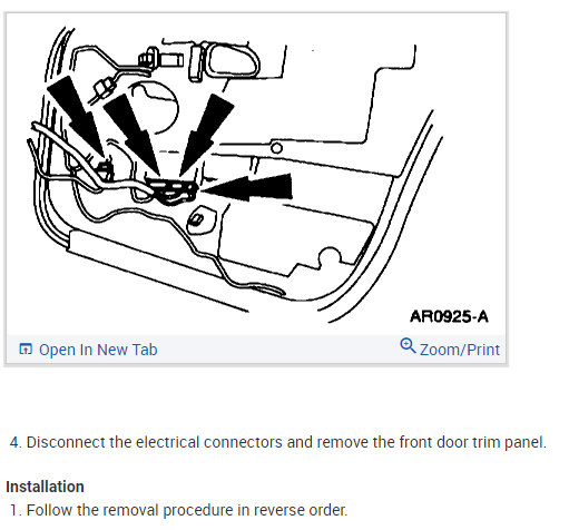

Hello, I'm Danny.

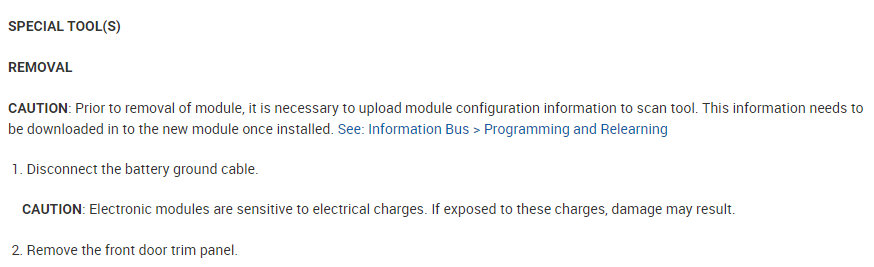

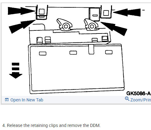

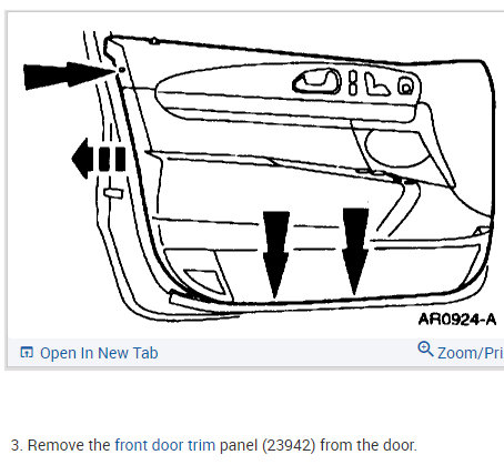

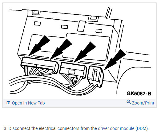

Yes, it sounds like you are having a DDM- driver door module or wiring problem related to the ddm. Here is a door panel removal tutorial and a wiring testing tutorial:
https://www.2carpros.com/articles/door-panel-removal
I've attached picture steps below on door panel and the ddm removal and replacement. I've also attached below the wiring diagram for the power locks for your car. Hope this helps and let us know what you find. Thanks for using 2CarPros.
