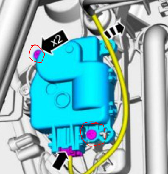

How many screws are on the driver's actuator motor?
85,000 MILES
LHAWBA01
I have only seen one and the top ones do not feel like they are screws. What trim panels are required to be removed? My SLE trim has knee air bag and I hope that does not need to be removed.
If you have any diagrams that would be great.

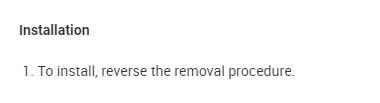

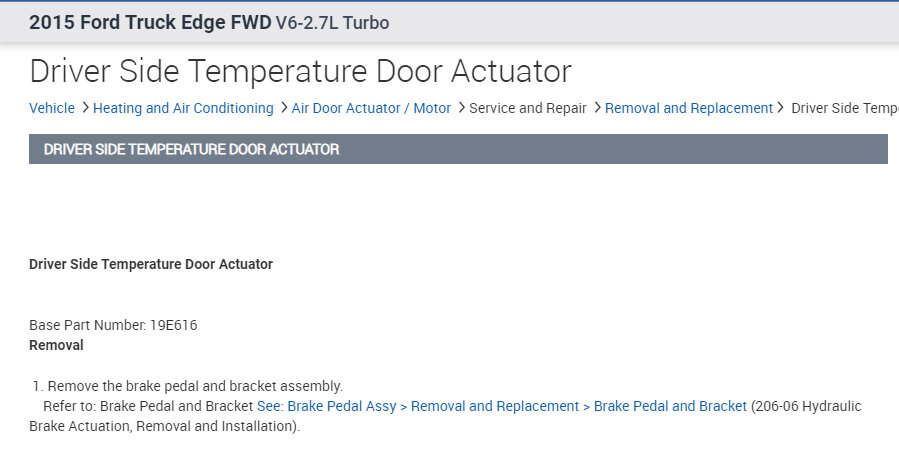

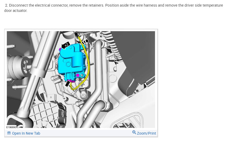

According to the manual, there are actually two screws that hold it in place. When I think of these, I would swear there are three, but two is what is shown. One is at the top and the other is at the bottom. See pic 1 below.
As far as replacing it, you need to remove the brake pedal and bracket assembly for access. I attached the directions specific to this vehicle below. Let me know if this helps.
