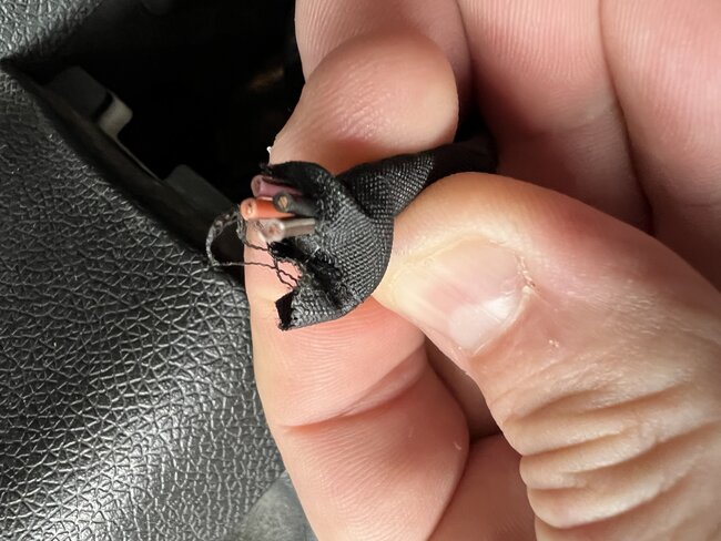

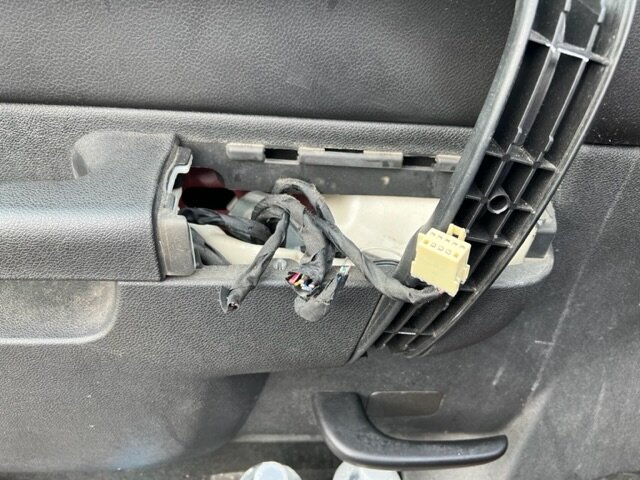

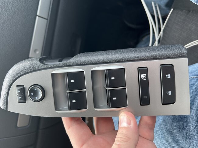

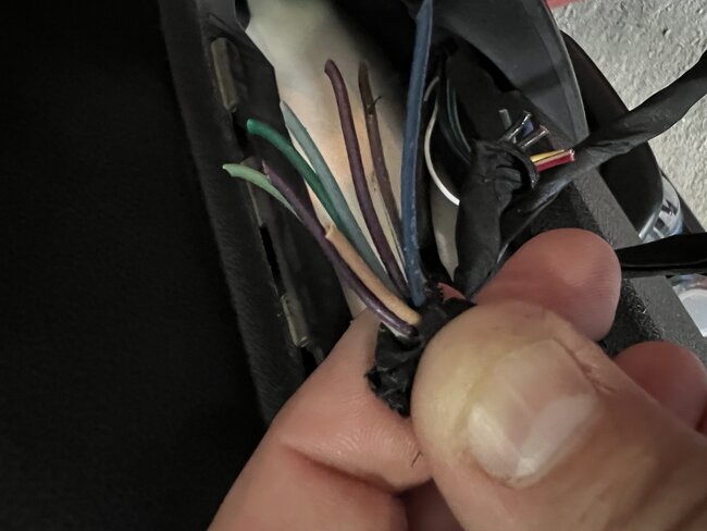

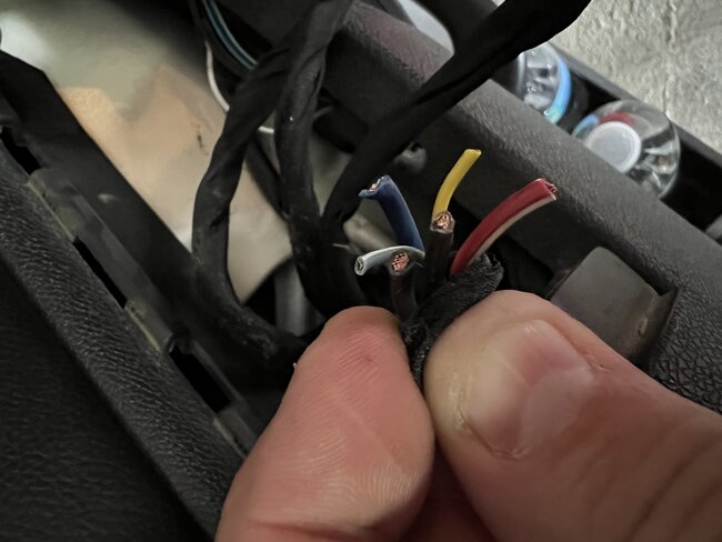

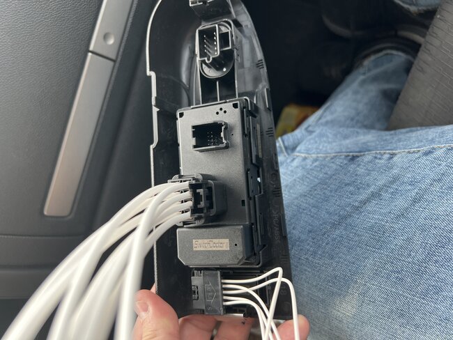

Someone stole my front driver side switch assembly for the mirror, windows and door lock and cut the pigtails off. I was able to find replacement parts, but all switch pigtails have only white wires…
Can any provide a diagram for them?
Non power folding windows, does not need programmed. The pigtail part numbers are:
13587188 And 13576542 for the windows
12167130 For the power door locks
They were nice enough to leave the mirror pigtail…
Thanks

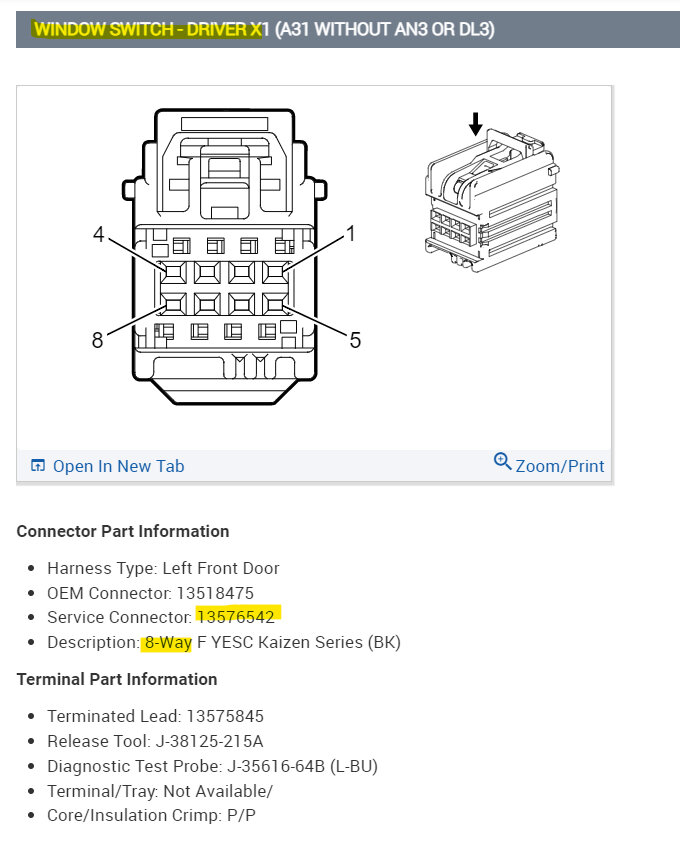

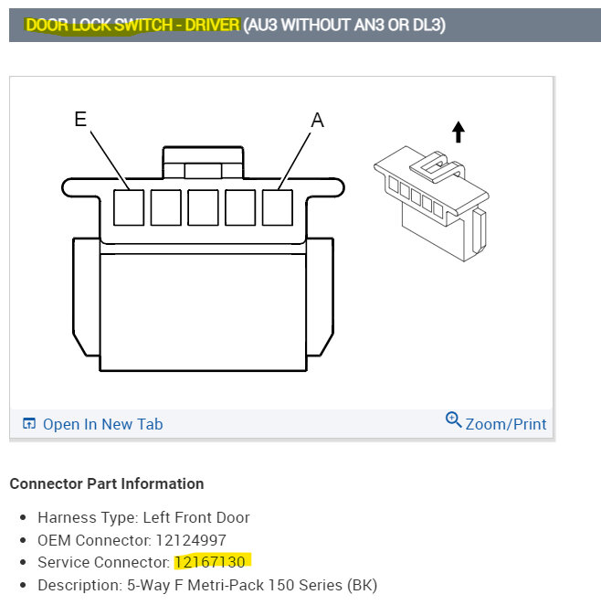

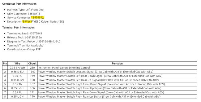

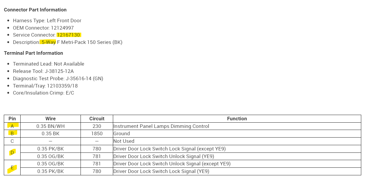

Hello, finding the connector diagrams for this switch had to be done by your part numbers. There are quite a few different designs, and it was impossible without the numbers.

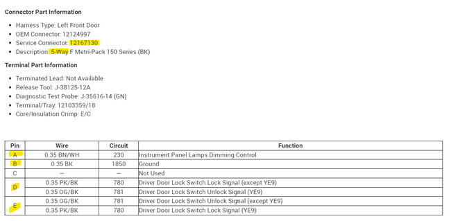

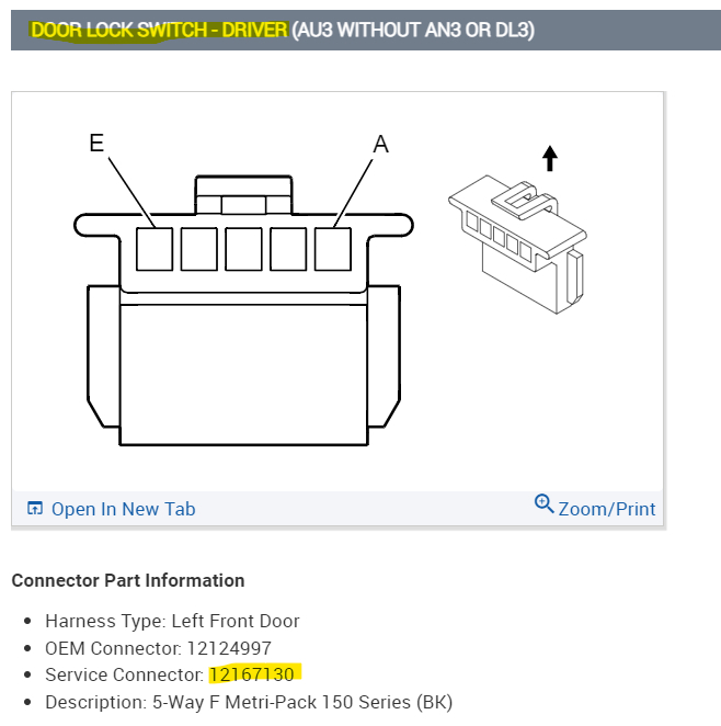

The diagrams 1,2 are the Driver Door Lock Switch 12167130

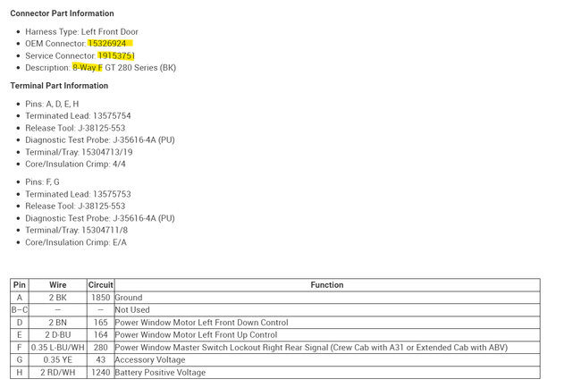

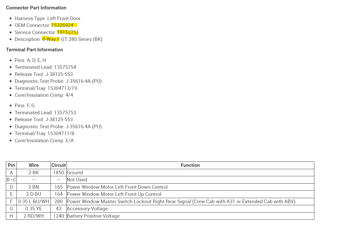

Diagrams 3,4 are the Driver Window Switch X1 connector 13576542

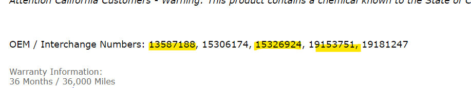

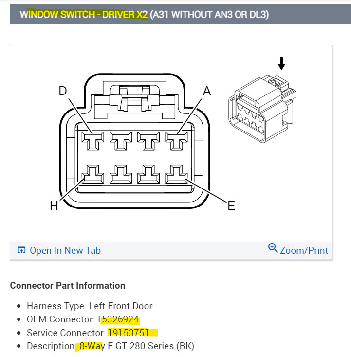

Diagrams 5,6 is the Driver Window Switch X2 connector 13587188, but had to be cross referenced with the OEM numbers that are shown in the 7th diagram. Sorry it took so long, none of the aftermarket wiring diagrams were clear on the connectors at all. They were a mix of designs together. Hopefully these will help, and the wire colors match.
I would check the wires labelled positive voltage and Ground with a multimeter before hooking them up, just to verify they are correct. So, nothing gets shorted out.
