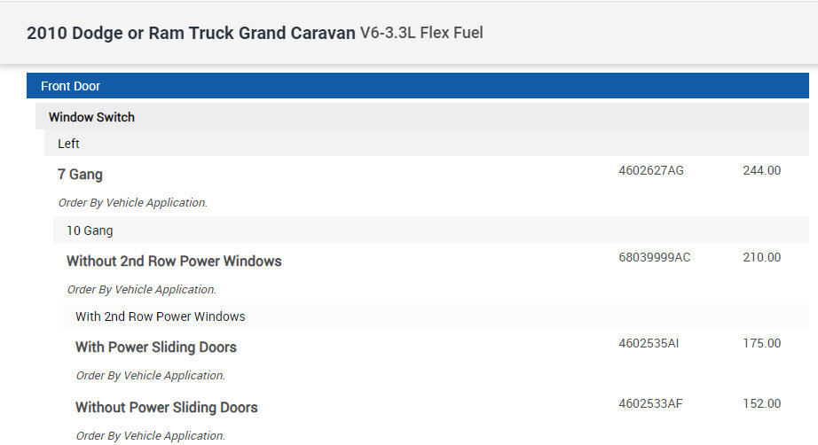

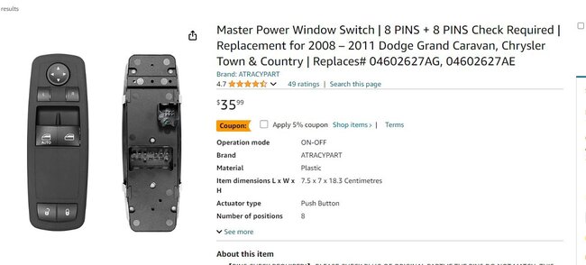

Hi, I have to replace the driver window switch, and my current switch only has non-auto driver, non-auto pass, mirror, open and close. I cannot find the correct switch on Amazon. I only saw auto driver, non-auto pass, mirror, open/close one. Please let me know if this still works on my car if I buy and replace it. The only difference is the old switch is non automatic driver side, new one is automatic driver side. I attached the new switch I plan to buy. Please let me know. Thanks

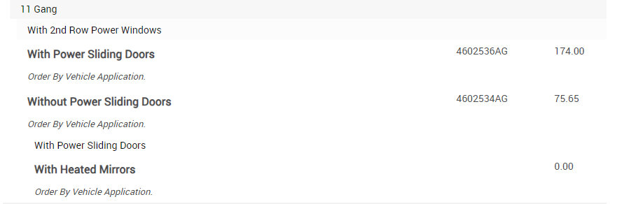

I attached different options related to the switch below. I noticed the switch design determines how many wires are going to it.
The picture has the OEM part number for the switches listed. Let me know if you can identify which switch is for your vehicle. Once we get the OEM part number, it will make your life a lot easier. LOL
Let me know
