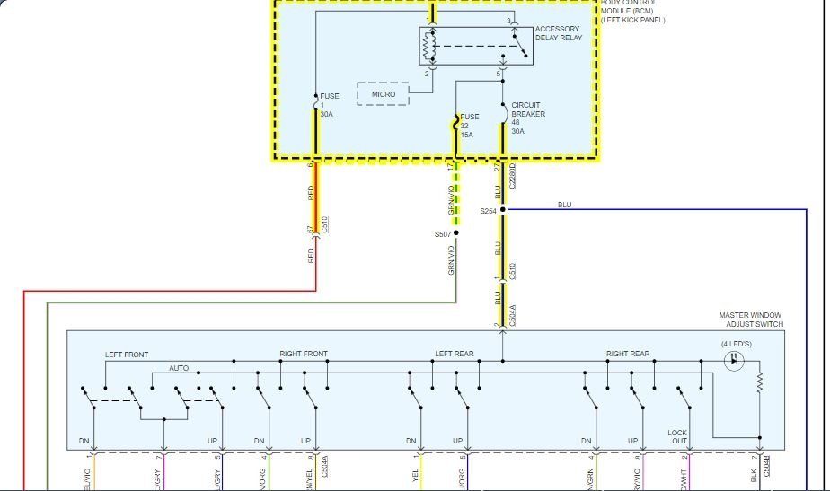

Hi friends,
I have the vehicle listed above Limited. I shorted the wrong wire to ground trying to fix the door ajar issue. In the wrong happed short in wires.
But I checked fuses 1, 4 and 32 it was fine, so only window drive not work to now, what I do, please?

Good morning,
I attached a wire diagram for you to view. The highlighted wire with the circuit breaker is what you need to test for voltage at the master switch or the drivers door switch.
