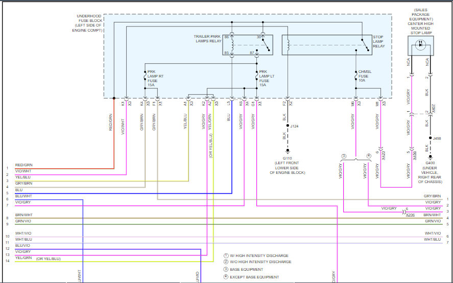

The driver side xenon headlight doesn't turn on. I replaced the bulb but it still doesn't turn on. I checked the fuse for headlights and I don't see it blown. I'm not sure if there are separate fuses or one for both.

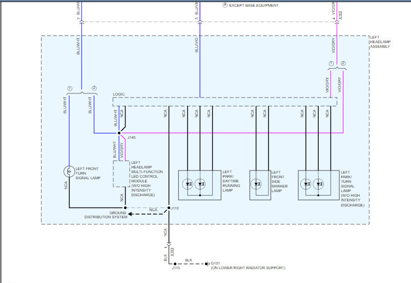

If you checked the fuse and new bulb are good then I suspect you might have a wiring or ground issue. I would check the ground first. It will be on the lower part of the radiator support. Here is a tutorial showing how to check wiring:
I've attached the wiring diagram for the drivers side headlamp below for you to use as a reference. Hope this helps and thanks again for using 2CarPros.
