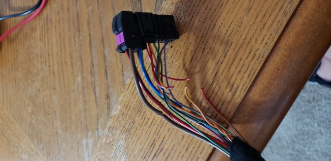

All of a sudden the driver's side window will not roll down. You can roll the other 3 windows down at driver's side control but not at the individual controls.
I have replaced the drivers side switch and the main window motor unit.
Yes I have checked the fuse and even swapped it out.
I would greatly appreciate any suggestions on what to check next.

Hello, was the fuse blown? It sounds like there's a wiring problem in the wiring loom where the door meets the frames. pull that open and see if there's and broken wires in there.

That fixed the problem. Looks like a kid got in there with a knife it was so bad. I'm hopeful that will also fix my parasitic draw problem.
Thank you so much for the advice.

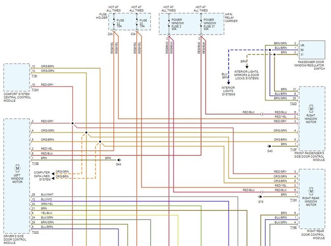

I am having the same problem . Where is this wiring loom on driver side or passenger sides? Of it is on driver side how is possible that we can send up and down the windows from the driver master power switch but not from their individual are the getting power all from the driver master power switch? I will re open mine to look for this cause until now i didn't find anything that can cause this kind of problem.
Oct 2, 2020 at 5:44 PM
STEVE W.
  • 15,421 POSTS

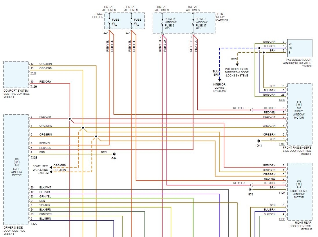

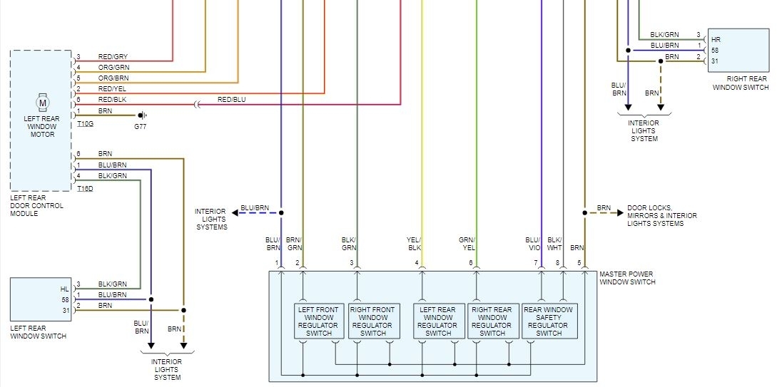

There are wire harnesses to each door. Each has it's own power and ground however the actual motion from the drivers controls are through the computer network connected to the drivers door control module. Each door local control sends a signal to that module telling it up or down. Then the module commands the motor for the window. If the control wires get broken or shorted it can cause problems depending on what broke and how. The wiring diagram is attached.
