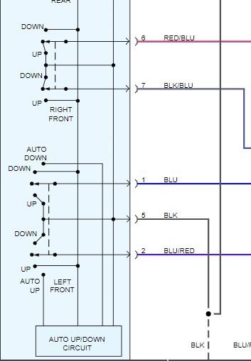

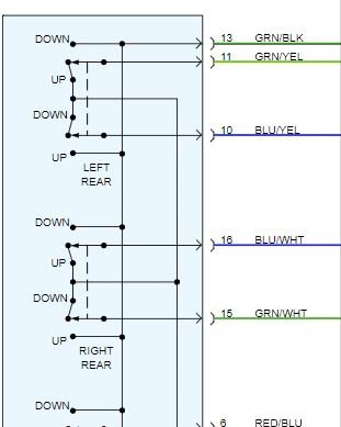

The white wire harness that attaches to the window switch broke when I removed my driver side door panel. Now I’m trying to figure out how to put the wires back were they belong.
Feb 24, 2019 at 12:30 PM
  • 110,241 POSTS
I attached a wiring schematic for you. I had to break it into two parts so you could read the pin numbers. The wire colors should help when you do this.
Let me know if you run into trouble or have other questions. I hope it helps.
