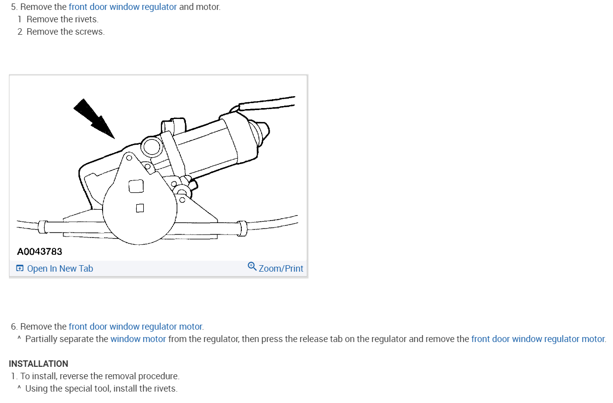

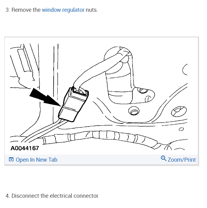

My window goes up and down but binds going up on the front side. If I push window back it finishes closing. Goes down just fine. Any Ideas?
Sep 14, 2023 at 6:58 AM
  • 55,433 POSTS

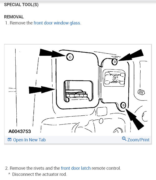

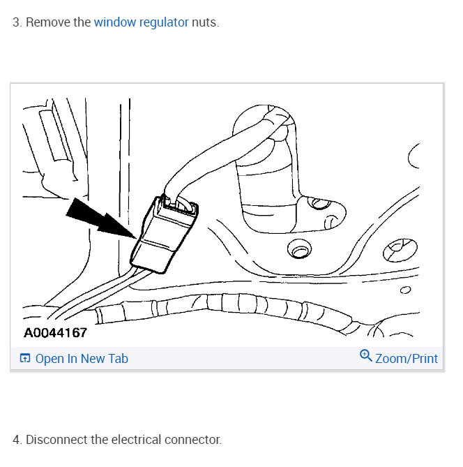

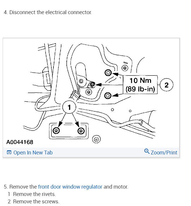

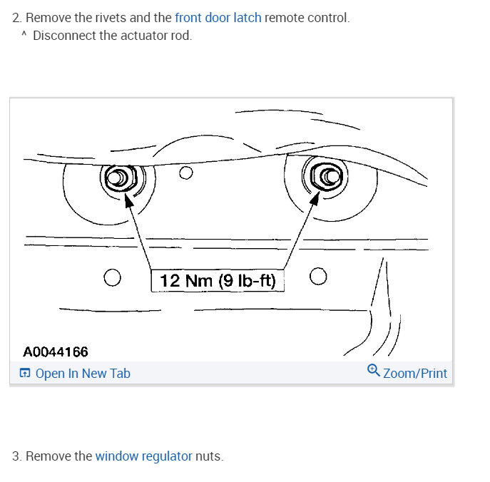

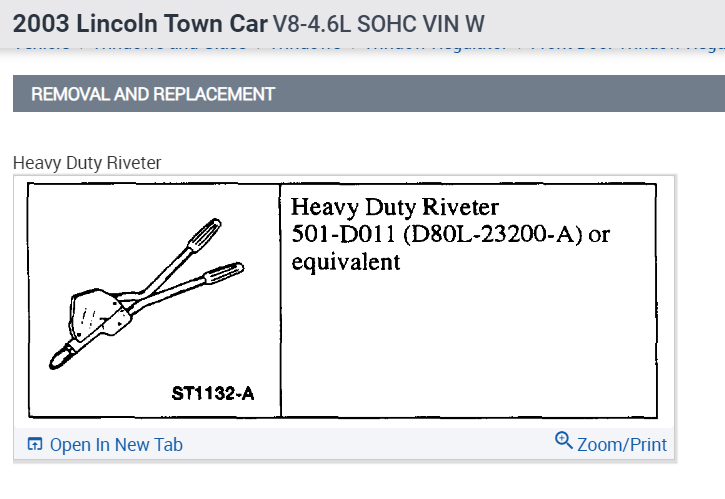

Yes, this happens when the window regulator goes out and needs to be replaced. here is the job being done on a similar, I have included the instructions for your car in the images below:
https://youtu.be/oNxstjcA25k?si=oK05v1pl1KU959Il
Sep 15, 2023 at 4:34 AM

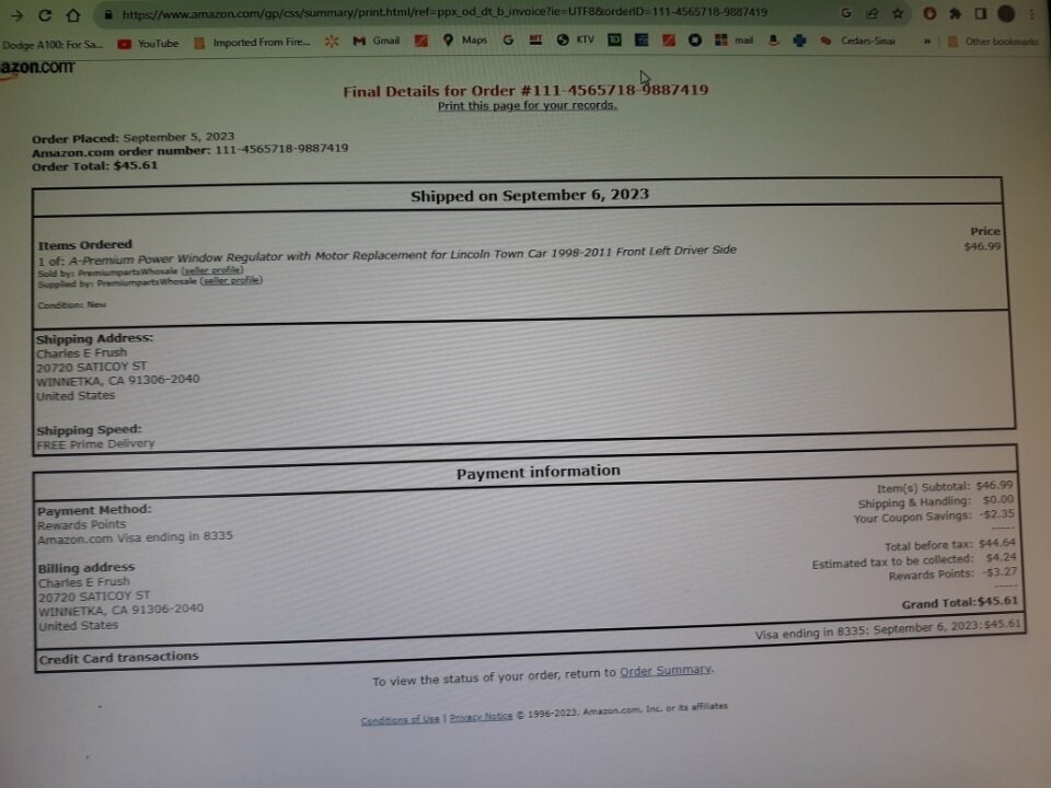

CFRUSH1
  • 73 POSTS
Amazon.
Invoice attached.
Sep 20, 2023 at 6:13 AM
CFRUSH1
  • 73 POSTS
This review on Amazon kind of tells the story
From:
Jason Richmond
1.0 out of 5 stars Inferior Product
Reviewed in the United States on June 1, 2023
Style: Front Driver (LH)Verified Purchase
After going through all the work to get the mechanism installed and the glass back on it, I tried it before I put the rest of the door back together. Glad I did because the guides are to loose on the mechanism and allows the window to pivot and shift. This results in the glass binding up in its guide. Would not recommend buying this one.
Sep 20, 2023 at 6:46 AM
