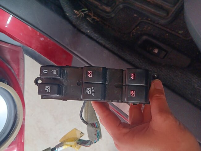

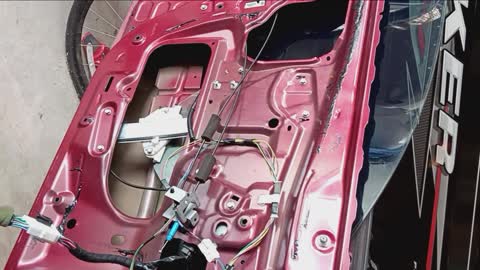

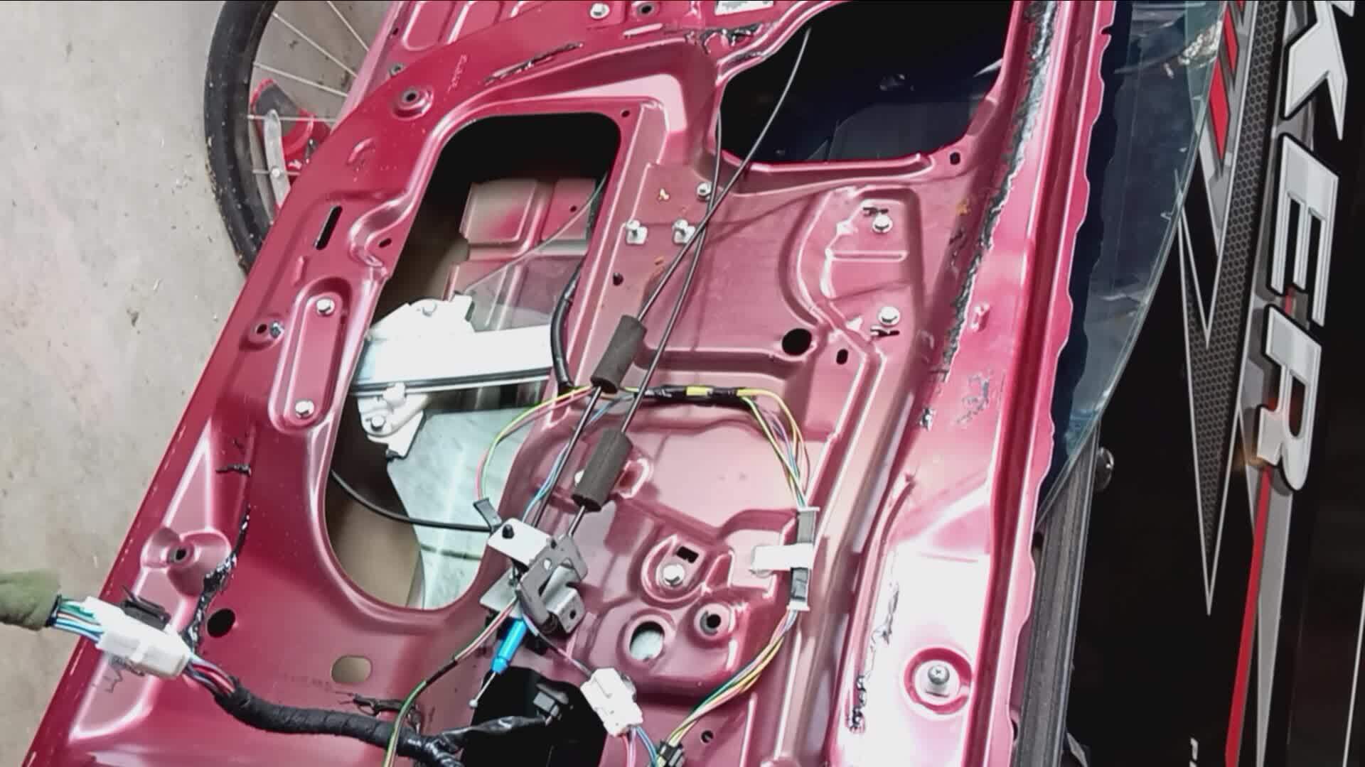

On the driver's side window control switch, all buttons light up except for the driver's side window. I replaced the window regulator and driver's side switch with parts from Subaru, but nothing changed. All windows work except for driver's side. I am thinking it is an electrical issue. I checked fuses and all seemed in good shape. Could you assist me in diagnosing this issue? I have a multimeter, but I'm still learning how to use it. I can take pictures if you need me to.
Thank you for your time.
Melissa

Okay, do you mean you can open and close all of the windows from the driver's door switch but the driver's window doesn't work? Or is it that you can use the switch on the other doors for those windows and the driver's switch does nothing?

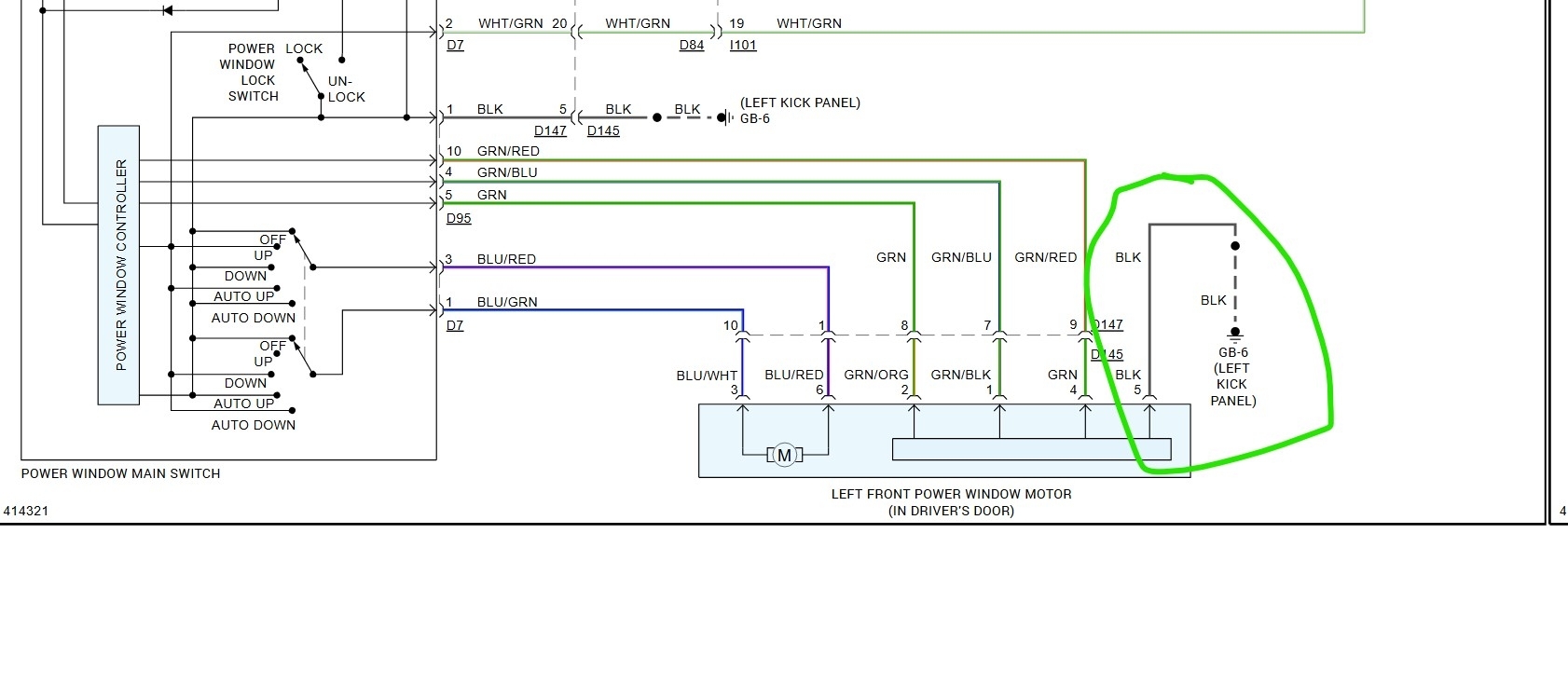

Also do you have the auto-up option? Different wiring depending on options and don't want to confuse us while testing. At the moment it sounds like a broken wire if it has the auto up function, they ran a different ground through the accordion sleeve between the door and the body on that option and it only provides a ground for the driver's window function.

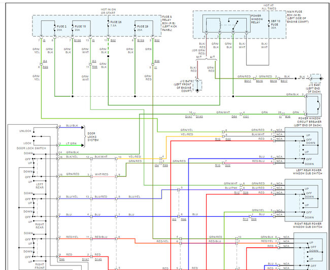

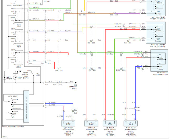

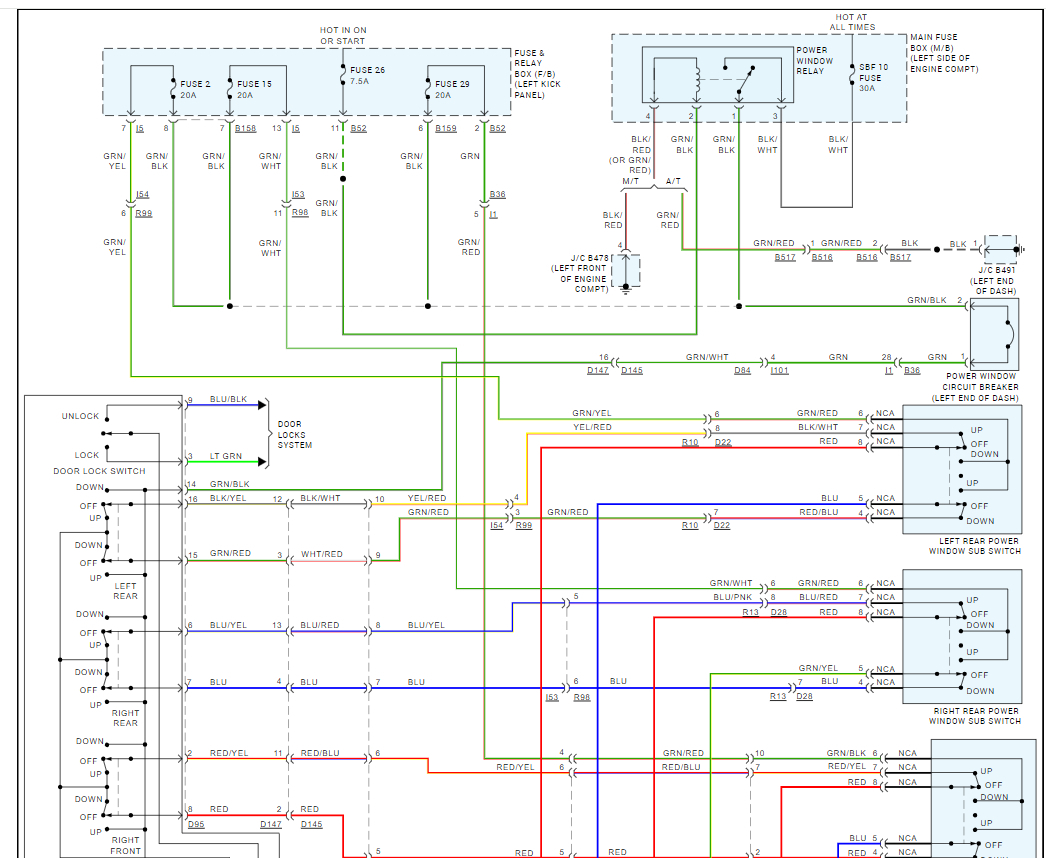

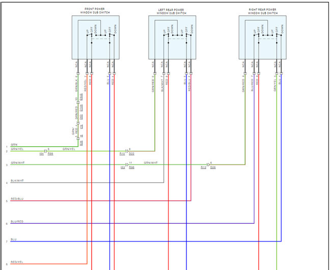

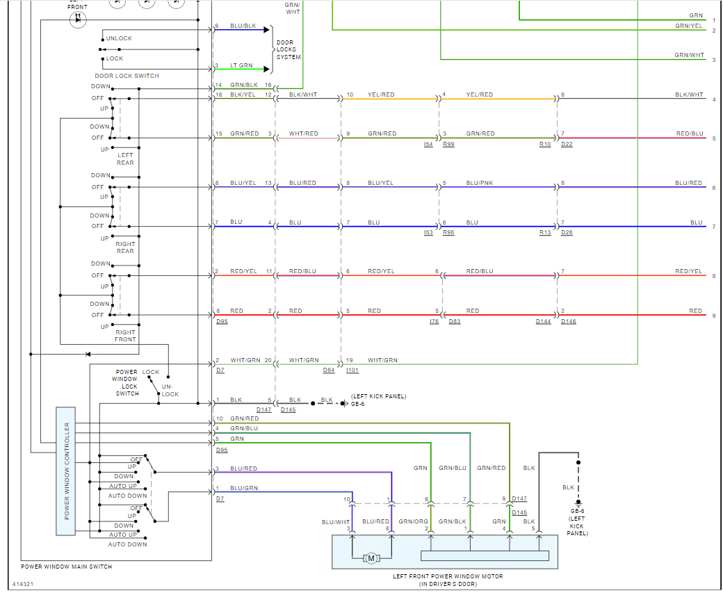

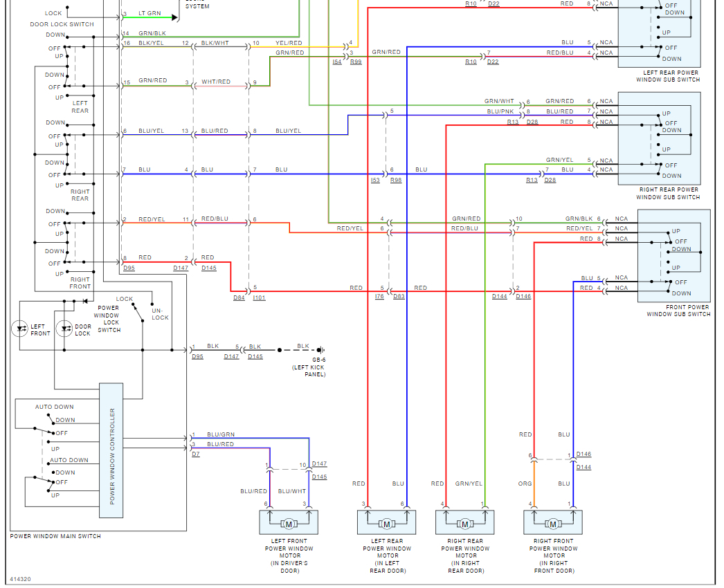

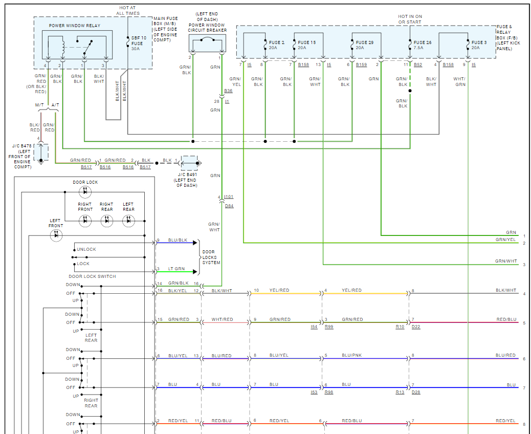

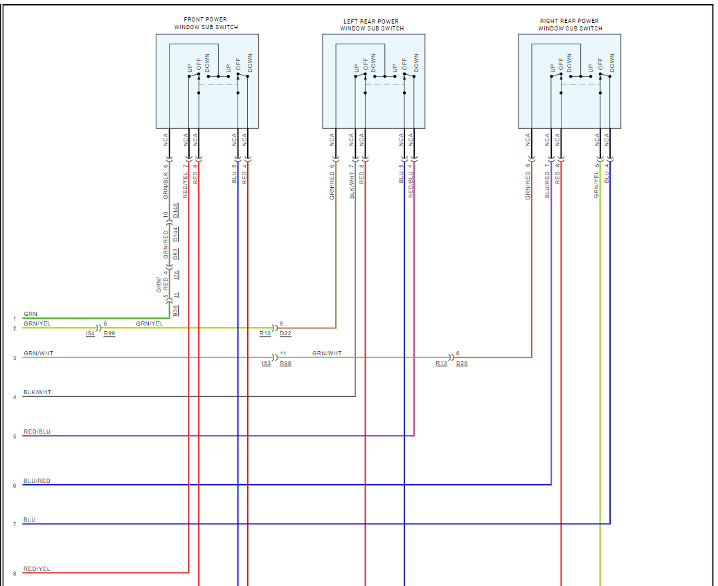

To get this straight all window work except for the driver side window and you have replaced the switch and the window motor/regulator, correct? Here are both wiring diagrams for both auto up/down and regular systems which are similar. Also, this guide can help you see if the window motor is getting a power/ground signal:
https://www.2carpros.com/articles/electric-window-repair
Try to move the wiring around inside of the door, is there is a break in the wiring it is usually inside the door near the door jam. FYI. The first four are the auto down/up Check out the images (below). Please upload pictures or videos in your response of any problems so we can see what to help you with.

Yes, all windows work except the driver's side. The dealership said it was a bad switch and bad motor, but when I switched them out there was no change.

okay, use the guide to check for power and ground to the window motor, also the wiring can break where the door meets the jam. Let me know what you find.

Okay, that vehicle has the auto option. There is one common wire that can break and stop the driver's side window from working. That is the ground wire (black) that runs from the connector on the motor, through the boot and to the ground connection behind the trim panel in the driver's footwell. It provides the ground for the motor and switch assembly for the driver's door but won't change the other window operation. Easy to test if you can get to the connector on the motor, which it looks like you still have the door apart. Find the black wire on pin 5 in that connector. Take a test light connected to battery positive and touch it to the pin in the connector. Or take your meter set to ohms or continuity and check that the wire is okay. If it isn't I would do a simple overlay, you would get another black wire, run it through the door and boot, put an eyelet on the end and secure it to ground, then inside the door you would cut the black wire and use an insulated and heat shrink butt connector to connect the new and old wires.

Good morning! First off, thank you both for your help. I greatly appreciate it. Before working my way to the ground wire, I decided to start back at the beginning and check fuses and go from there. The power window main 2 fuse was broken. I switched out the fuse and the red light on the switch to the driver's side button was on. I then connected the switch to the regulator, and it works! I guess next time I should not believe the dealership and auto mechanic who after a $150 diagnostic fee both said it was the regulator and switch. :(
The only thing now is when I pull on the switch the auto up and down do not work. To roll the window up, I have to keep pulling on the switch multiple times until it gets all the way to the top. and then rolling it down I have to hold the switch the entire time.
Am I just checking the wires for the auto up and down according to the wiring diagram?
