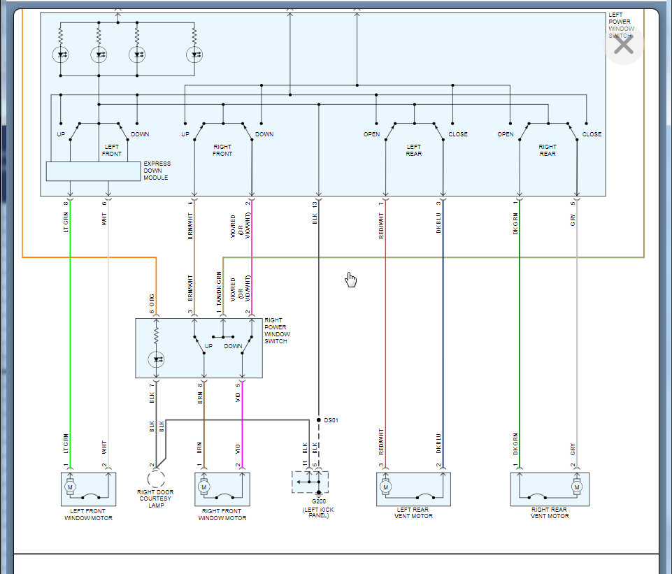

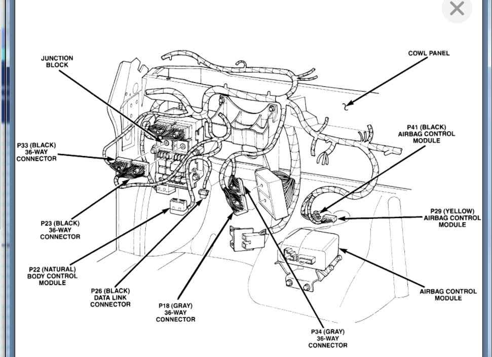

Can’t find the fuse box to check fuse for the driver side window. Help!
May 27, 2021 at 9:34 AM

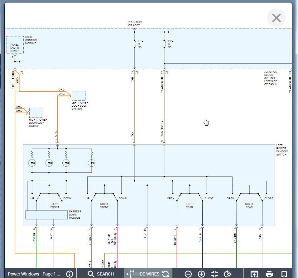

This is the junction block that is behind the left side dash. Fuse 8 and 9 is for the window switch that if they are not operating then it would not work but the passenger side would most likely not work either as the power is run through the master switch.
However, let's check the fuse and then we will need to check power coming out of the switch if the fuses are okay.
I included the wiring diagram and the location of the junction block.
Please let us know what you find on this. Thanks
