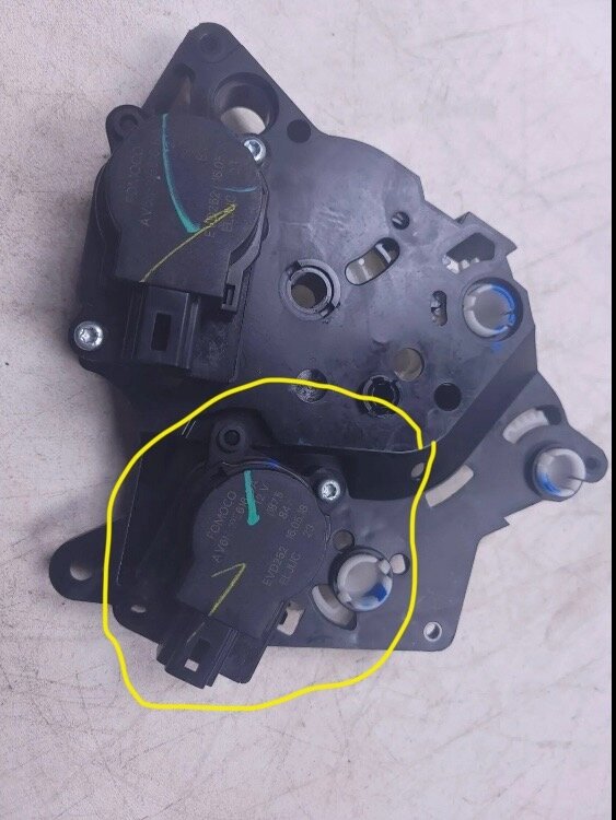

I replaced the actuator on the driver's side by the pedal area. Still blowing cold. Though I replaced it with the Dorman 604291 part only because it was the only one available immediately. I’ve pulled fuse F27 cranked the car ran the A/C for 5 minutes, put the fuse back in and I still have cold air on the driver's side. I hear the part switching and I do get some warm air as long as the A/C button isn’t on but still doesn’t match up with passenger side vents.

So, I hear changing but there is another aviator controlling the passenger side right next to the one in question
So, I think there is either an alignment issue or the cam I stalled onto is broken or something. My coolant is clear full etc. I even flushed the heater core very well which I’m getting good hear on the passenger side.

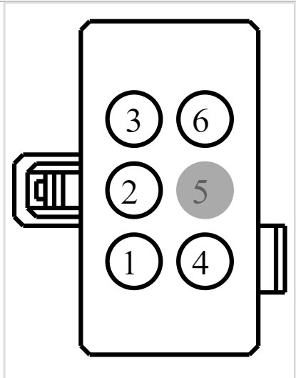

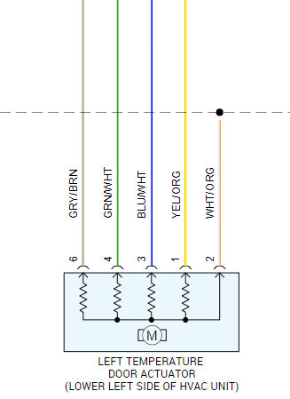

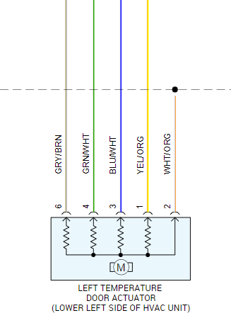

Now one thing I’m currently working on finding the answer is the electrical connector for thus actuator, so I noticed it appears a pin in the connector is missing. So, 3 pins across top 3 across bottom so 1 and 3 are in place on top bottom rows 4,5 and 6 are in place. Is there supposed to be 5 or 6 pins.
Dec 14, 2023 at 1:00 PM
  • 110,240 POSTS
There should be five wires. Pin 5 in the connector isn't used. See pics below.
Let me know if that helps.
Dec 14, 2023 at 1:20 PM
MORGAN8173
  • 71 POSTS
Okay, I’m glad you sent that because I was thinking it was a wiring issue since pin 5 looked like it was missing a connection.

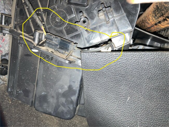

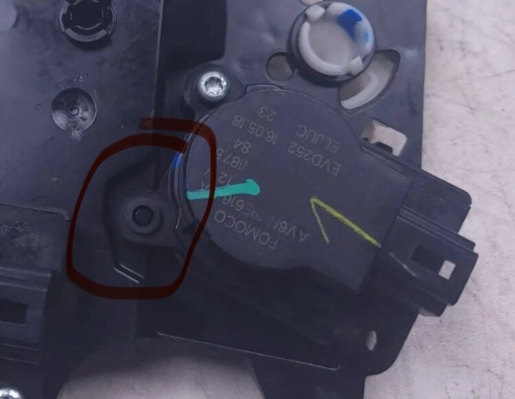

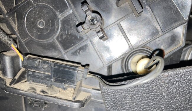

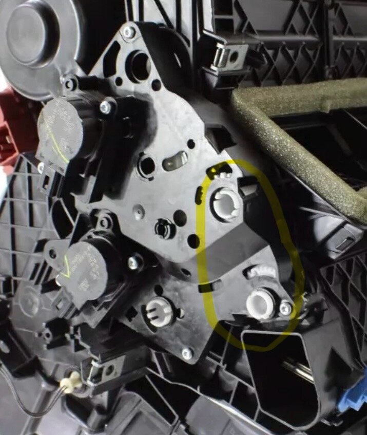

Okay, I’ve been searching for a real color image of the cam that they install onto and one thing I quickly noticed is that I actually screwed in a flange head screw in the picture with the sea circled why a screw well the original bolts I actually dropped them down somewhere Ava couldn’t locate them. I looked up the specs for bolts it showed M5x18mm if I recall so I have a bunch of little screws so I went with something same size if anything it would be smaller not larger but i definitely screwed in a screw here it’s not like I felt like I was forcing it in though.
Dec 14, 2023 at 10:37 PM
  • 110,240 POSTS
I do hear the humming, and it does sound like it could be the actuator. If that is the case, it doesn't sound connected to anything and is free moving without restriction.
When you lost the screw, could it have fallen inside the box?
Dec 15, 2023 at 7:49 AM

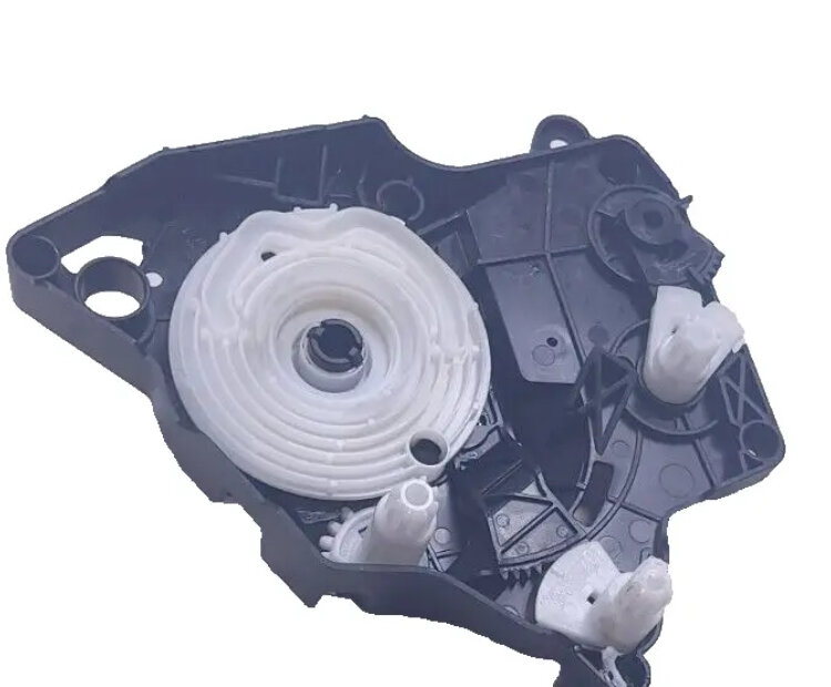

How difficult is it to remove the cam the actuators are attached to?

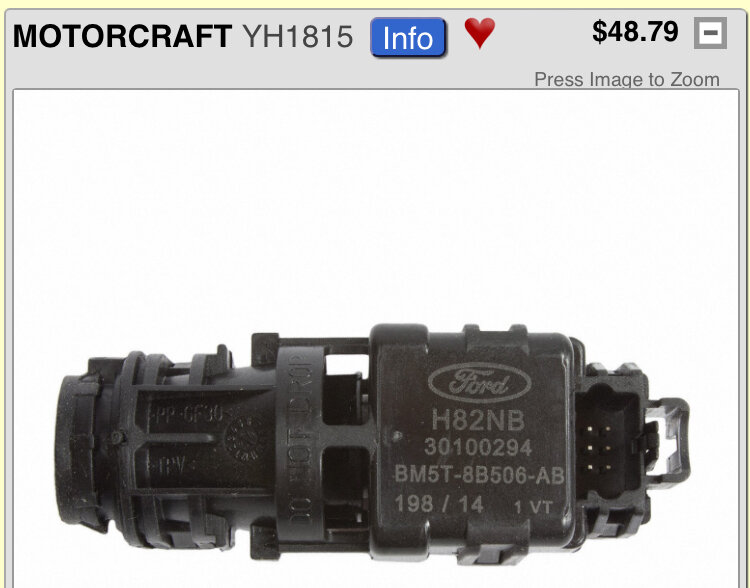

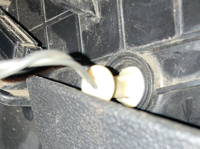

What is this rubber plug connected to? I believe it is a resistor. Is this a temperature sensor or something plugged into the box or something? I ask because I was changing the setting laying down there and I noticed the air I was feeling was not coming from the floor vent it was blowing out this plug that I pulled back into place. So, what I noticed by fixing that the blower pretty sure pushes a lot harder out the vents at least. So, I also noticed switching to defrost to md at least my idle dropped but it still switched over fine but then you hit A/C blows fine cold air, but you hear it switching when I roll the dial over to heat, but you don’t ever feel it close up that flap thou. So, I want to make sure you know which one I’m working on in the event I called it the wrong name. I circled you T in yellow.
Dec 17, 2023 at 8:06 AM
  • 110,240 POSTS
It appears to be a temperature sensor. Also, you are working on the correct side. As far as the idle drop, when you turn the defroster on, that is normal. It also turns on the AC to help dehumidify the air going into the vehicle. Hence, it defrosts faster.

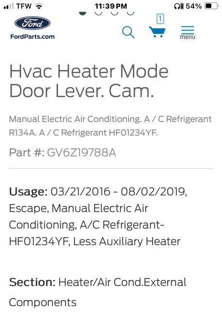

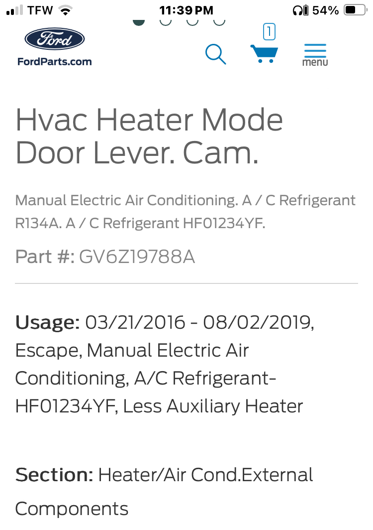

MORGAN8173
  • 71 POSTS
Joe,
Do you have the directions to replace the cam that the actuators attach to? I still have no heat after even going to Ford to buy an OEM part instead of aftermarket.
Jan 16, 2024 at 4:35 PM
  • 110,240 POSTS
I checked through two manuals and that isn't listed. When you move it manually, did you get heat?

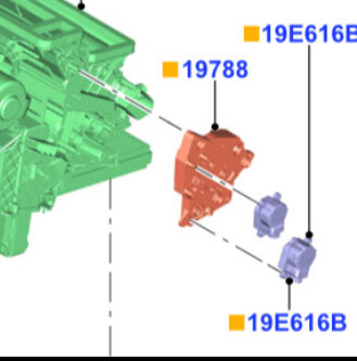

MORGAN8173
  • 71 POSTS
I honestly don’t know which way to turn it. I'm scared it’s stripped somehow or somehow simply not connected on the backside with whatever moves on that side.
I have the part number GV6Z19788A in case you search that part number to see if something pulls ups. I’m just concerned about once you unbolt it how far does it need to be able to pull it off or is it just going to slide down, I really don’t want to remove the steering column which sweat I’d need to remove if it needs say 6” of space to pull it off.
Jan 18, 2024 at 1:45 PM
  • 110,240 POSTS
I understand your concerns. However, it should simply be a plastic flap/door. It should move easily. If it doesn't, then it is a concern.

Do you think there’s a chance this could be my problem with the no heat on the drivers side?
Jan 31, 2024 at 10:27 AM
  • 110,240 POSTS
I believe that is an HVAC temperature sensor. Yes, it could be related to the issue.
Jan 31, 2024 at 12:09 PM
MORGAN8173
  • 71 POSTS
I just know it’s the cabin temperature sensor and I was reading elsewhere functions that a faulty or failing one could produce and it mentioned mode function and irregular temperature being produced out.

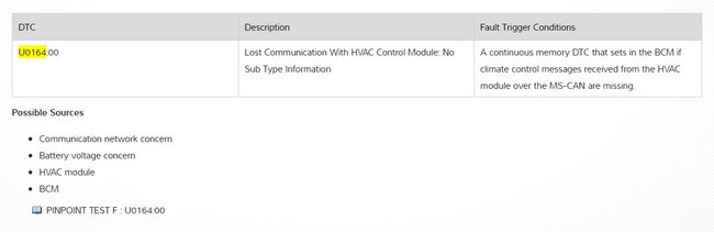

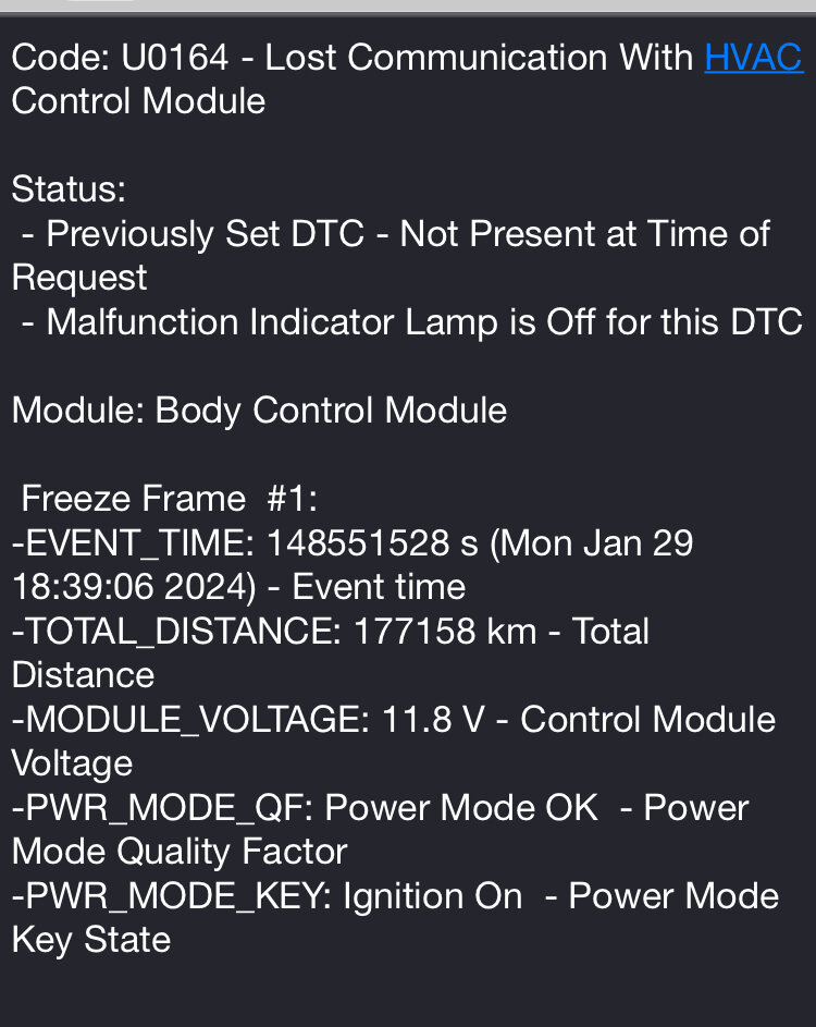

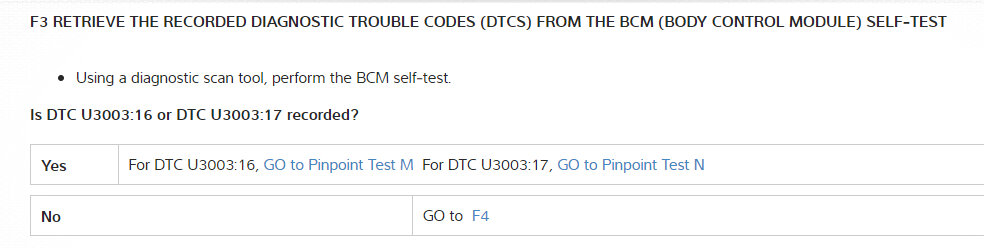

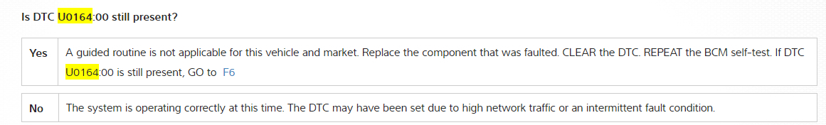

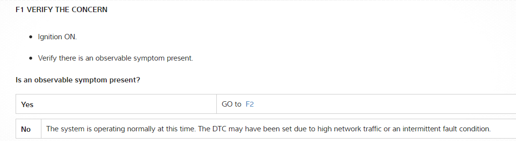

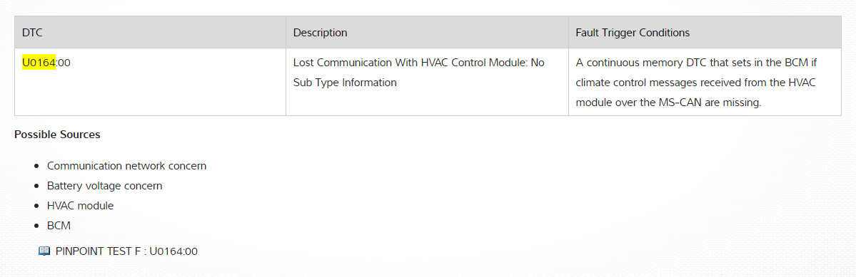

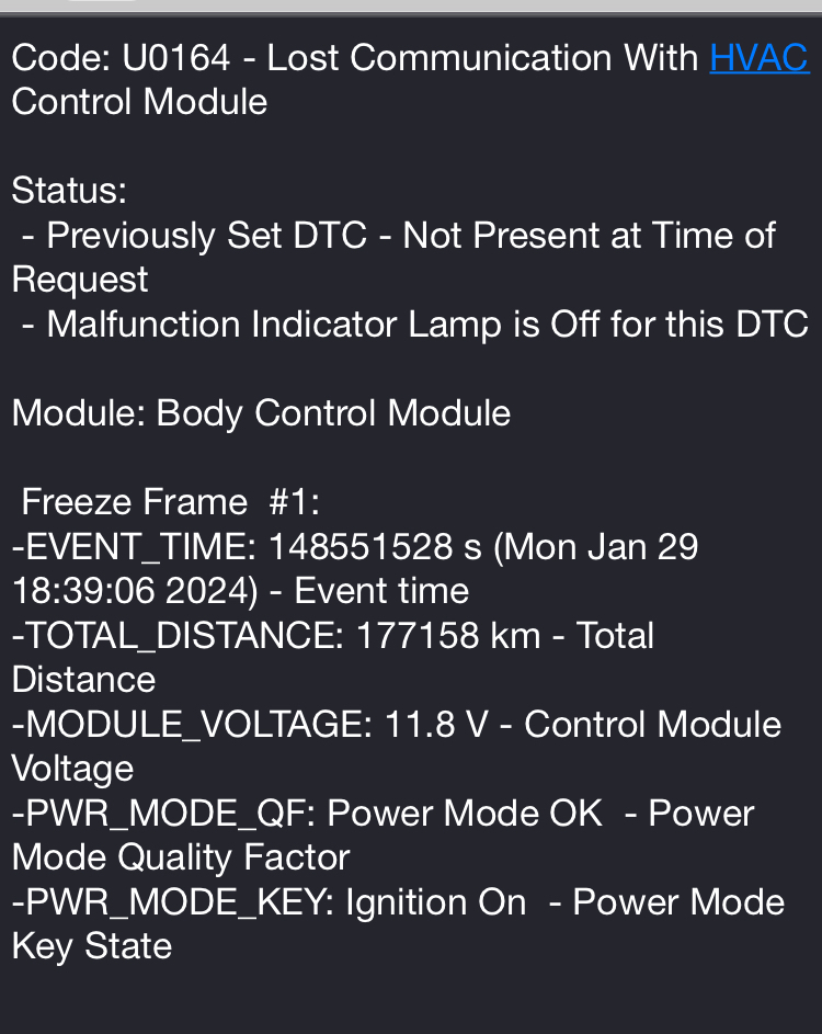

So, I assume this is part of the problem.
Feb 2, 2024 at 2:39 PM
  • 110,240 POSTS

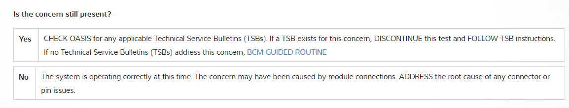

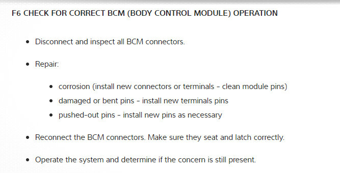

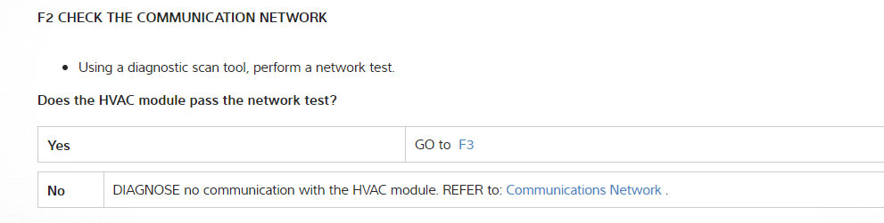

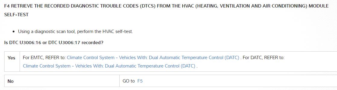

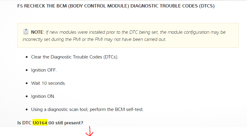

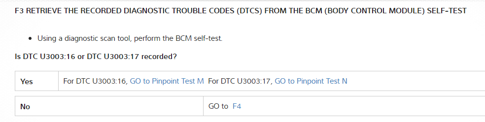

The code is likely indicating a problem within the HVAC control module or the body control module (BCM). In this case, the BCM isn't receiving a signal from the HVAC module. If both parts are functioning, it sounds like they are, there could be an issue in the controller area network (CAN).
I don't know how familiar you are with the CAN. The Controller Area Network is a communication protocol interconnecting electronic control units (ECUs) within a vehicle. It allows different components and systems in a car to communicate with each other in real time. In this case, the BCM isn't communicating with the HVAC module. That leaves diagnostics to help narrow things down.
If you look below, I attached diagnostics specific to it. Take a look through them and let me know if you are comfortable performing them.

Any chance I created that code when I pulled that 7.5a fuse? I just thought about that.
Feb 3, 2024 at 7:43 AM
MORGAN8173
  • 71 POSTS
Also, I cleared the code and it’s not come back on, but I also have no heat on either side now for some reason is any of the things you just referenced under the steering wheel that I could have pulled on by accident? Now I did take that cabin temperature sensor off and sprayed it with mass air cleaner ABS allowed it to dry out.

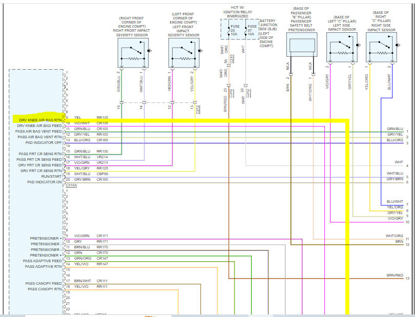

  • 71 POSTS

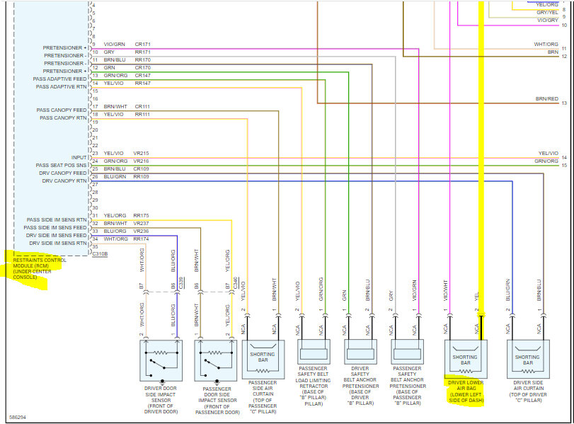

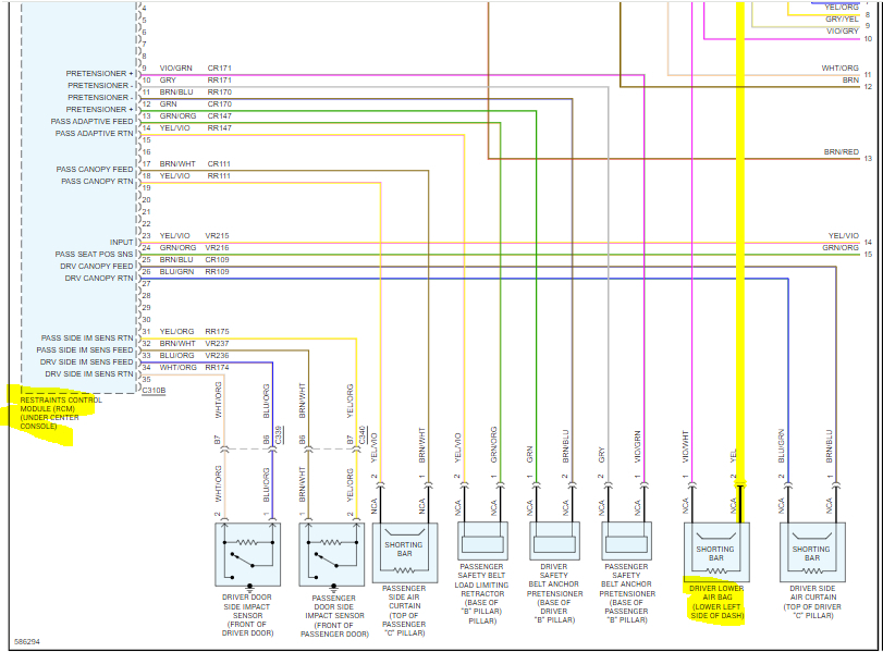

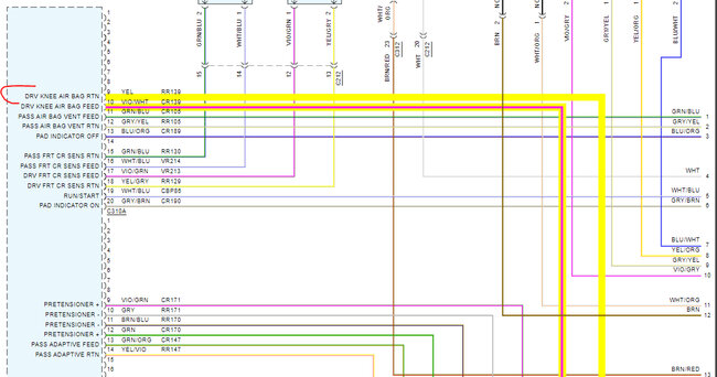

Joe,

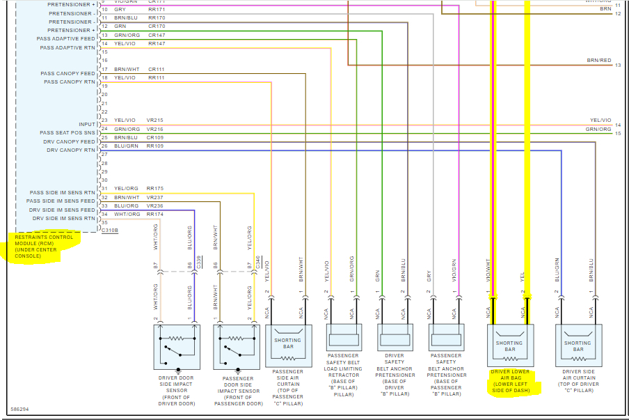

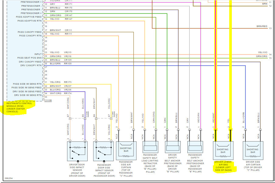

The yellow wire on the knee airbag is that wiring tied into the actuator in anyway? I ask only because I just noticed the yellow wire is completely detached from the connector. Makes me wonder if it works or not because I have no codes for that all this time. Unless it’s been barely connected and just finished itself off
Feb 4, 2024 at 6:19 PM
  • 110,240 POSTS
The yellow wire at the knee airbag isn't related to the HVAC. That is the return signal to the restraint control module (RCM). See pics below.
Let me know. Also, if that wire is damaged, the airbag light should be on.
Feb 5, 2024 at 9:53 AM

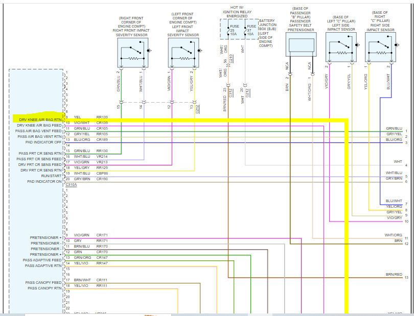

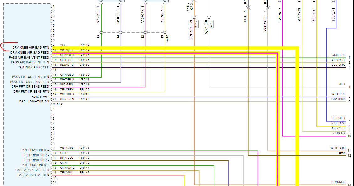

Hey, please tell me I bought the right connectors for that driver knee airbag that had the broken wire pulled out of the connector.
https://www.ebay.com/itm/364692059963?mkcid=16&mkevt=1&mkrid=711-127632-2357-0&ssspo=__z98ei8tlw&sssrc=4429486&ssuid=xydCT9_TSuq&var=&widget_ver=artemis&media=COPY
Feb 12, 2024 at 5:54 AM
  • 110,240 POSTS
That indicates it is a clock spring connector for the airbag. I'm looking at the schematic and the airbag wiring goes to the restraints control module. Is the connector at the airbag the same?

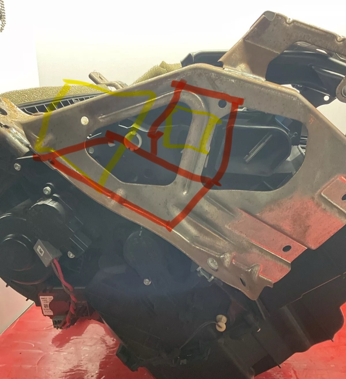

Okay, so, i finally got tired of not having a real head on the driver’s side. So, I dove into this once again and actually discovered the problem. Something somewhere has to cause a shift, or something cause this metal “cage” I’d call it around the whole heater core box has been bent up against the canister. So, the white knob that turns to open the driver's side vent has been lodged all this time so the cam after removing it which I broke to all pieces to remove it that’s how tight it is. If I remove the actual gear from the cam for that area, you’ll see where it’s tried turning so much it’s worn all the groves down on the cam not the teeth though. So, I bought a brand new one. No way it’s going back in without cutting this metal thing off absolutely no way things can line up properly to go in and move freely. I guess mostly I’ve only been worried about this potential being used as a ground somewhere and simply cutting a section off wouldn’t mess that up would it?
Feb 19, 2025 at 5:28 PM
  • 55,394 POSTS
You shouldn't need to cut anything; can you just remove the bracket?
