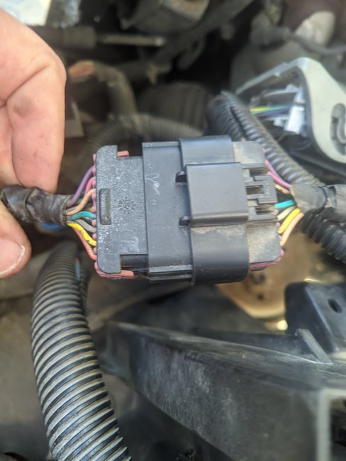

FLYINGRHINO
Update: I found the harness that goes to the headlamp, and I had it unplugged, and the rear began to work again. Signal and everything. Once I plugged it back in and blew LT Stop TRN fuse.
Photo is of the harness I had unplugged. This harness feeds into the under-hood fuse box then back out into the cab.
Would this be a bad ground issue or a 12v wire touching metal somewhere?
Sep 27, 2022 at 8:25 AM
FLYINGRHINO
Got it fixed. Turns out it wasn't anything with the truck but my faulty wiring on the parking light on the headlamp. Thanks for your help.
