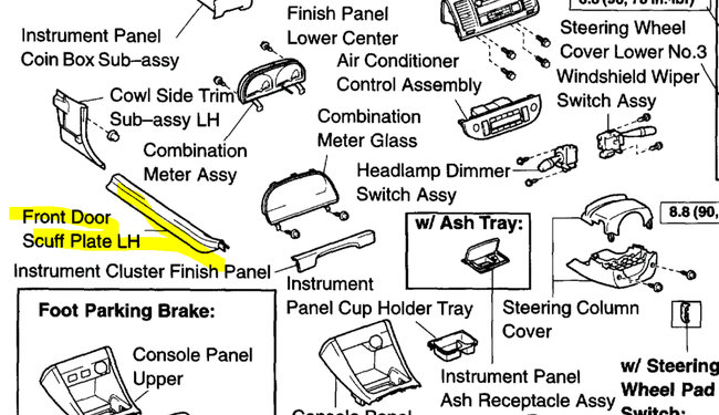

The driver side trunk release lever does not release trunk lid. The key open the trunk, The remote fob opens the trunk. Is there any information showing how to replace cable attached to the driver side lever? Does this cable connect to a mechanism before it reaches the trunk lid latch? Any help with aftermarket part numbers for replacement cable, instructions, or diagrams? Thank you. DEL92

My manual shows nothing for this procedure. I'm not sure why. I will try my best to explain how it is done.
1) Open the trunk lid. There will be an insulator panel mounted to the trunk lid (trim).
2) Using a plastic fastener remover (or a screwdriver) remove the plastic retainers on the trunk lid to expose the cable.
3) Disconnect the cable from the release lever on the latch assembly.
4) Now, the cable runs across the trunk lid, down along the hinge, and then into the vehicle. To access it for removal, you will need to remove the scuff plate on both the front and rear door. See pic 1.
5) Once removed, you will see the cable running along the body of the interior. At this point, using a 10mm socket, remove the trim cover at the release lever. (I believe it's 10mm).
6) Once that is off, disconnect the cable and it is ready for removal.
What I do is this. Before removing the old one, I carefully and securely tape the new cable end to the old cable end. Then, I slowly feed it back through the vehicle.
I wish I had more info for you. Let me know if this helps or if you have other questions.
