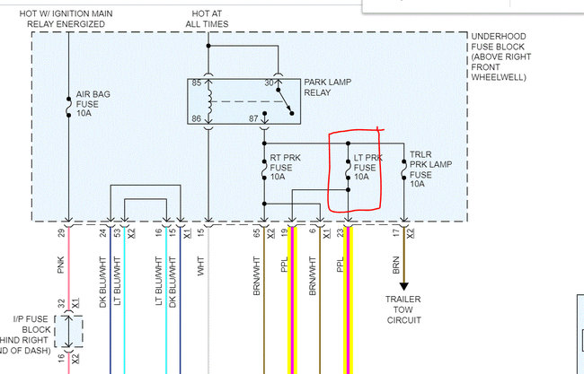

Driver side taillight and the license plate light are not working
2014 GMC ACADIA
98,000 MILES • 3.3L • 6 CYL • 2WD • AUTOMATIC
ADELA MAURICIO
Only the led strip on the taillight is not working, the turn blinker and the brake light it's working fine. I also notice that the led strip on the driver head light doesn't turn on all the time.

There is a fuse in the under hood fuse box for the left and right parking lights. Start by checking if that fuse is good. Since it's the driver's side, the one specific to the left is the one in question. Here is a link to help:
See pic 1 for location.
