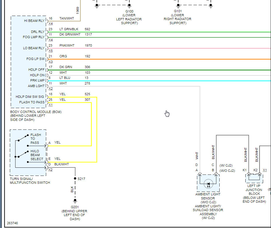

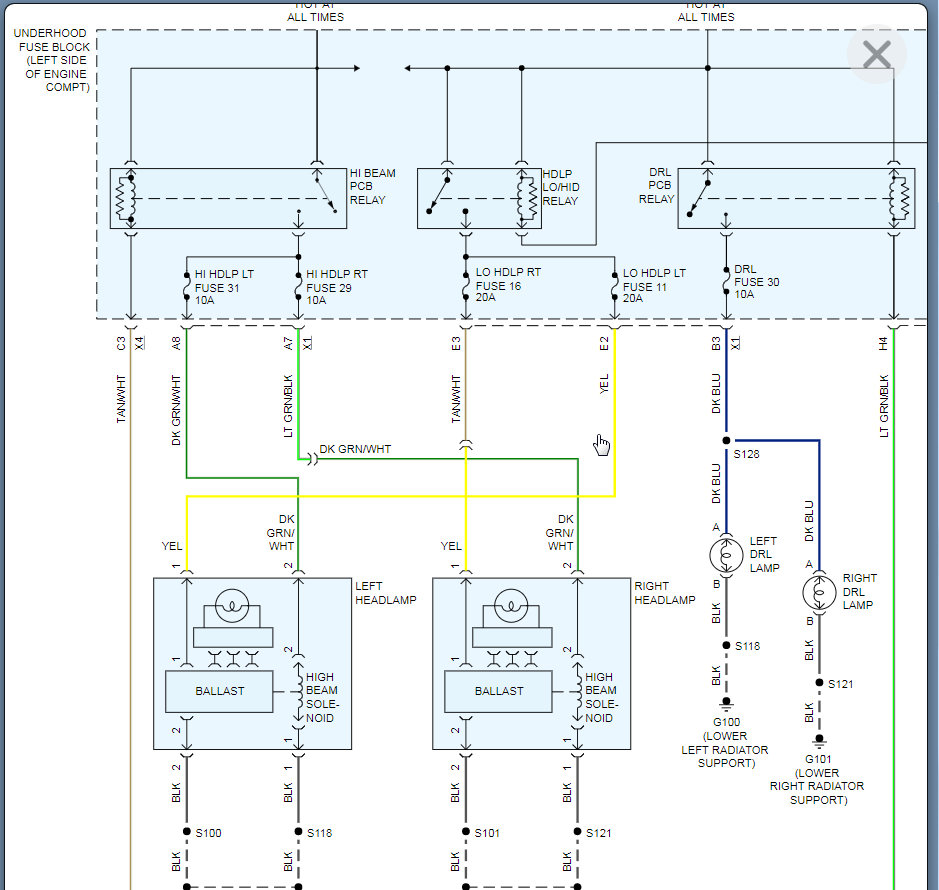

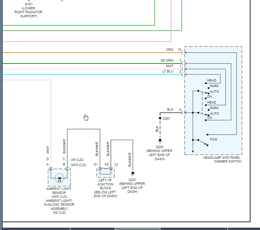

I just had my driver side taillight and headlight redone at Midas and they told me that it was a front bulb and two fuses. About 3-4 days later the same thing happened and I don't know what to think at this point. Aso,. the taillights are LED.
Apr 1, 2020 at 4:22 AM
Can you clarify what you mean by had them "redone" because I am thinking you had them replaced?
If this is not accurate then please let me know.
Which fuse did they replace?
Do you have HID headlamps?

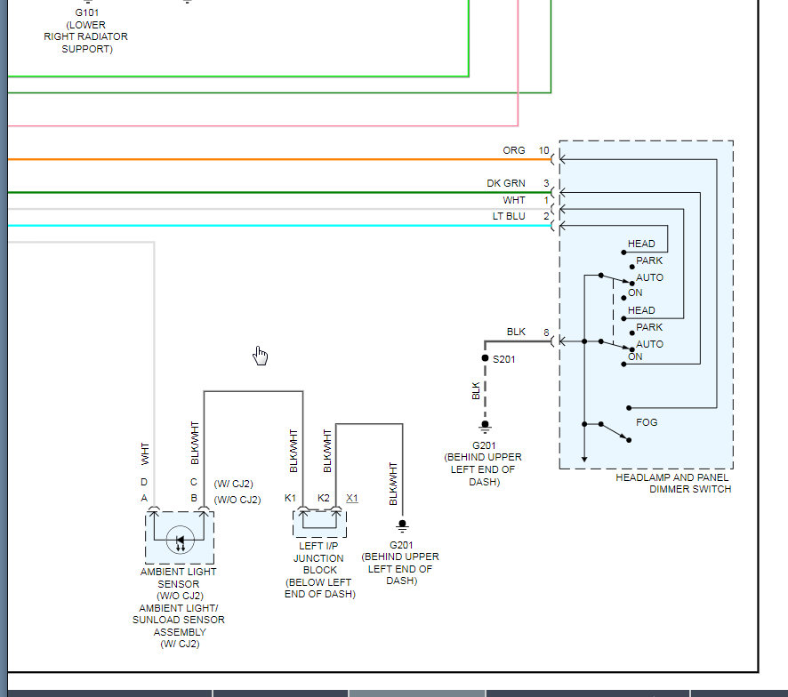

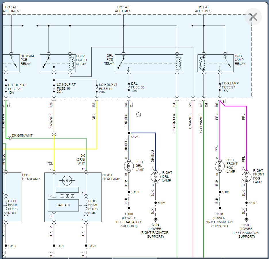

Let me know this info and we can go from there but we need to start with checking the fuse that they found blown and make sure it is okay. I attached the wiring diagrams for the headlamps which show you have HID lamps and we need confirm this. Thanks
